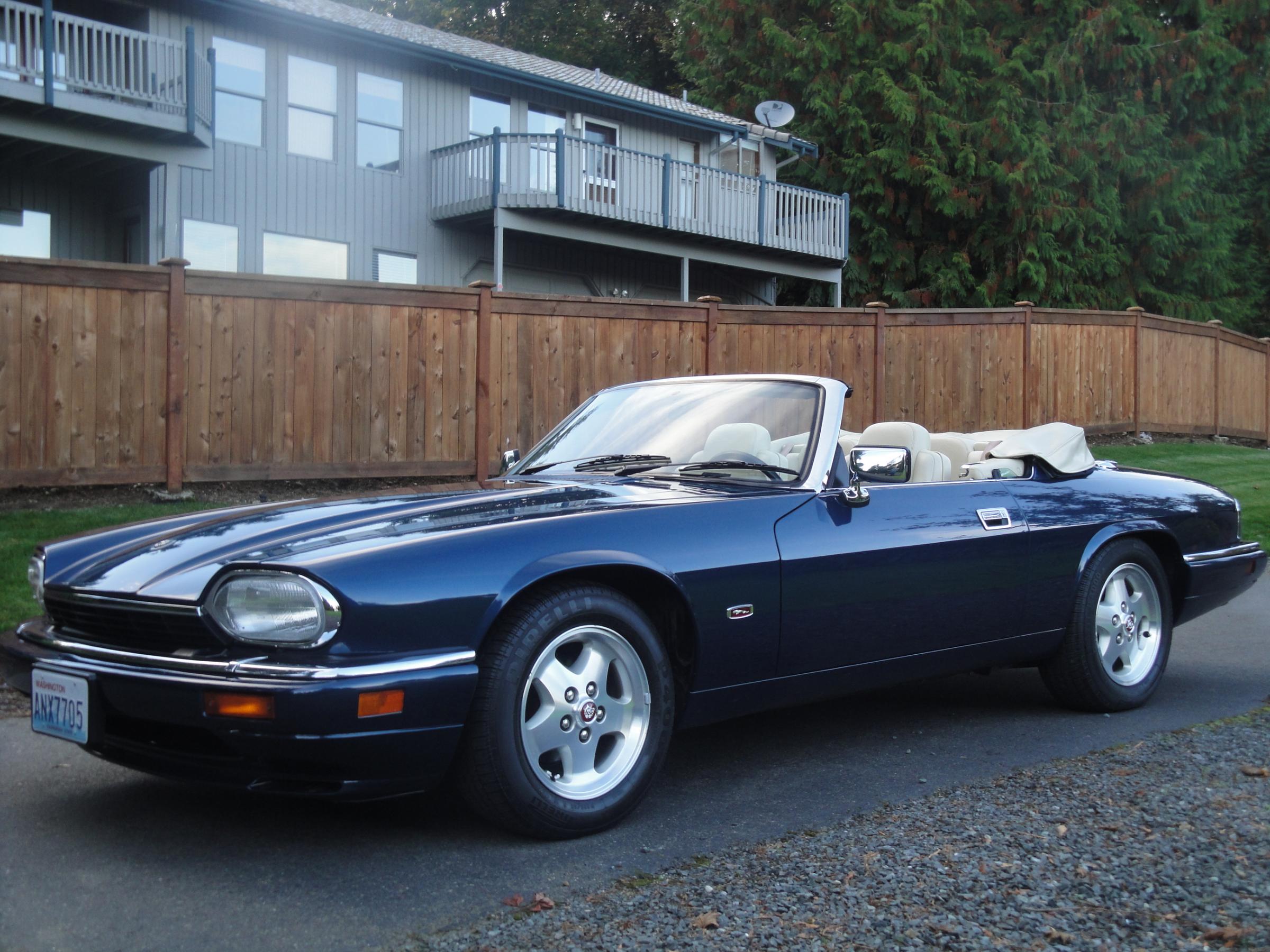

Good day everyone,
I looked on the forum but I could not find any info relating to my seat bolster. The attached picture shows how the seat bolster has separated from the seat cushion? From looking at jags over the years, it seems like a common problem. I have a 1995 XJS conv, 67K, good looking car. I resurfaced the leather, looks pretty good. How do I get the seat bolster realigned to the seat cushion. This would increase comfort and make it look better too. The passenger seat is ok. Thanks for your help
Attached Thumbnails Driver side seat bolster-100media%24imag0053.jpg   Driver side seat bolster-dsc00710.jpg
