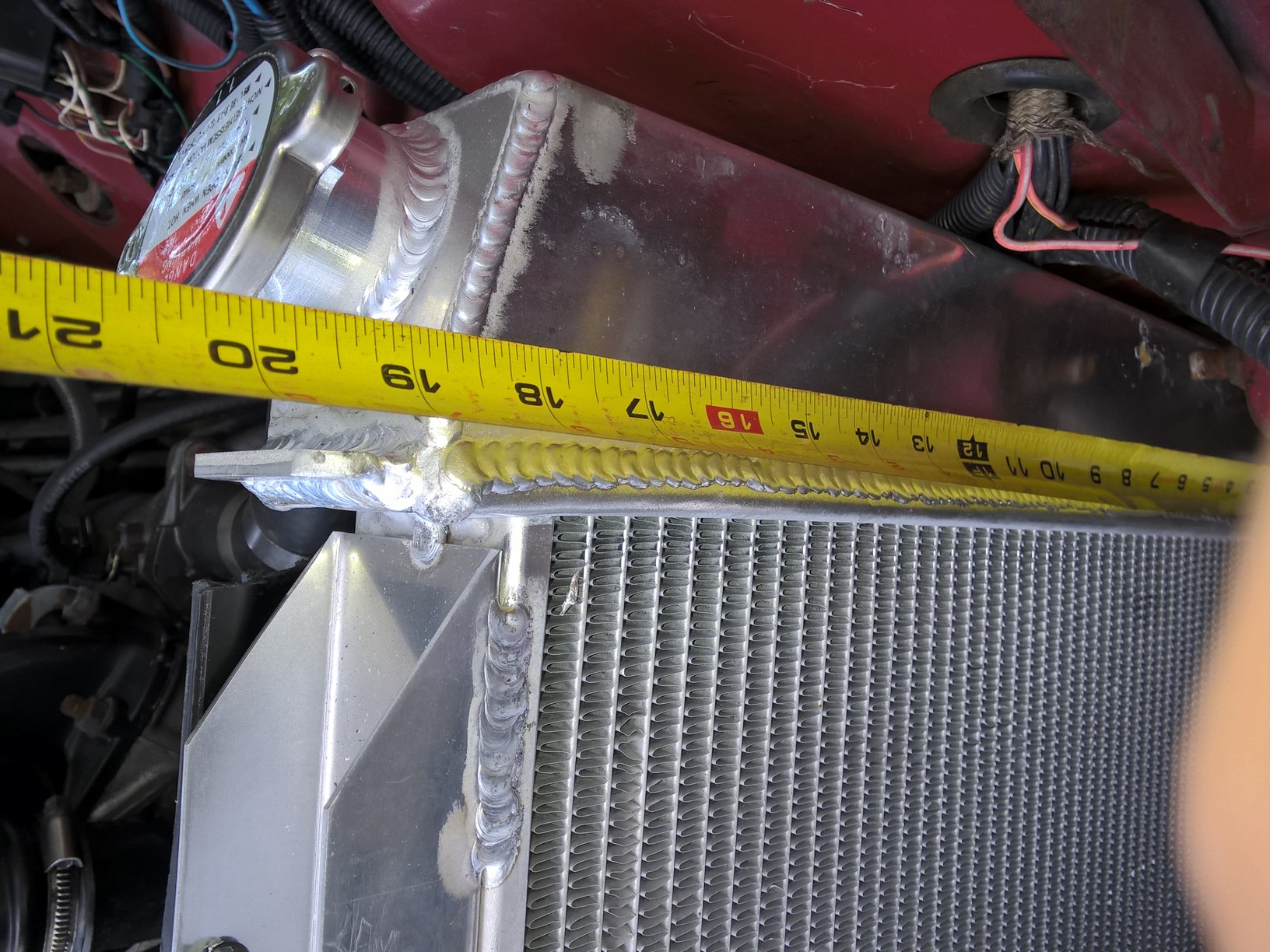

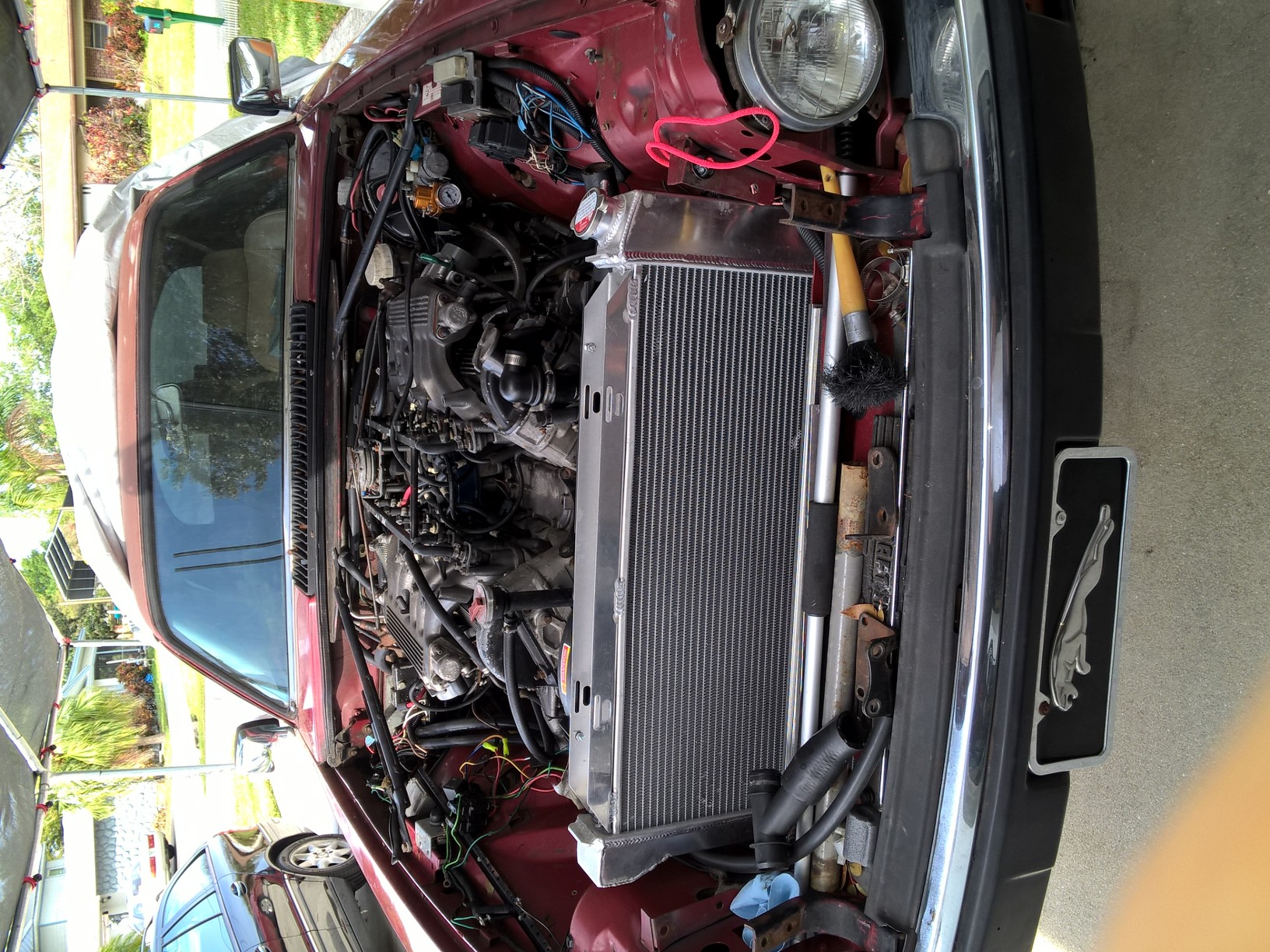

The radiator is from a ford Mustang, aftermarket 4 core, not a perfect replacement because of size and single inlets.
First I used a Ford two speed fan with Volvo relays, worked well until it started making noises.
It was replaced with dual fans from a Camaro, they were around 125.00 If I remember correctly.

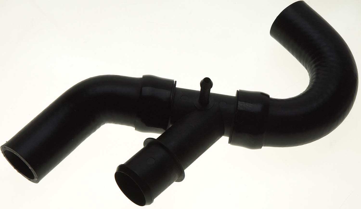

I did use a plastic tee from a ford Taurus, part number C71937, also a pipe from left outlet to right.

Radiator, model 381, used in 1972 fords from grand marquis to mustang. I purchased mine from my neighbor, but here is the tags in the box as well as some measurements.
Fans were used in 1989 Camaros, they aftermarket and only this part number could be found in the plastic shroud, 3043-F02.
