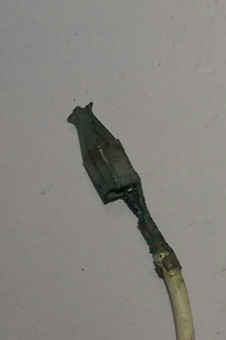

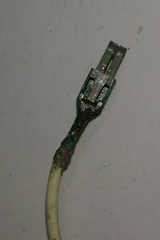

Can anyone advise me on what type of terminal is used on the 25 wire cable plug that goes into the ECM on a 95 v12?
I am thinking it's a female metri-pack 150 or metri-pack 280 but can't confirm.
As always any help/direction greatly appreciated.

I think this is it.
EFI Connection, LLC - Terminal Details
Old Jan 29, 2015 | 01:49 PM
Safari's Avatar
Posts: 757
Likes: 315
From: Denver, CO
This is the same terminal that is used in the fuel injector connectors.
I ordered mine from here;
TTI Inc. | Part Search Results
Only 14 cents each!
