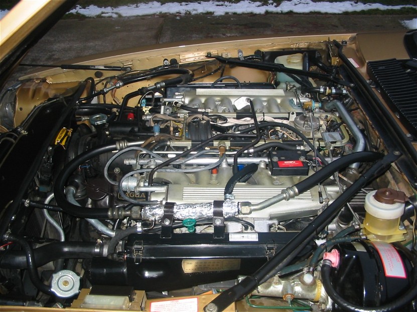

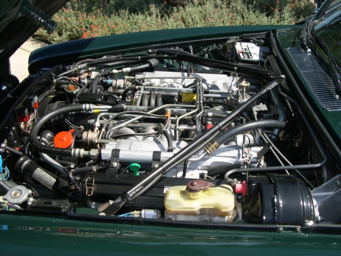

I am looking forward to hearing your experience with the SIII Doug. Meanwhile, FWIW, my understanding from one or two owners in the UK some years ago, was that the under bonnet temps were nothing like as much of a concern in the V12 saloons. This because (as you say Doug) the rad intake was bigger, and the under bonnet/hood space was far les restricted, and bonnet clearance above the engine was far greater so much better general under hood airflow. As the SIII was originally engineered for the straight 6, all this seems very likely true in practise as well as theory.
To be honest I'm not so sure the difference is that great . Compare the two pics from my old 1988 XJS V12 and a pal's 1988 Series III V12
But the battery which is under the bonnet had to have a fan to keep it cool, I believe.
For whatever reasons Jaguar dropped the battery fan fairly early on in Series III production
What is the view on the SIII part of the forum, anyone know?
Greg
Haven't asked ...yet
DD
Attached Thumbnails Electric water pump-xjs-engine003.jpg   Electric water pump-green-s3-v12.jpg
Old Dec 11, 2015 | 11:10 AM
JagCad's Avatar
Posts: 6,796
Likes: 2,403
My .01Cents!!!
When, in about 2002, We removed the DOHC 6 and BW 66
from my 83 XJ6, we came upon that foam "blanket". Scraggly and oily!!
So, when I cleaned up the bay for the nice clean LT1 and 4L60E,
it just wasn't right to plunk that greasy mess on it. In to the garbage.
Never missed it. No extra odor or noise to my attention.
And, yes, it seems a positive move towards increased air flow in and out of the engine bay. A good thing...
Carl
