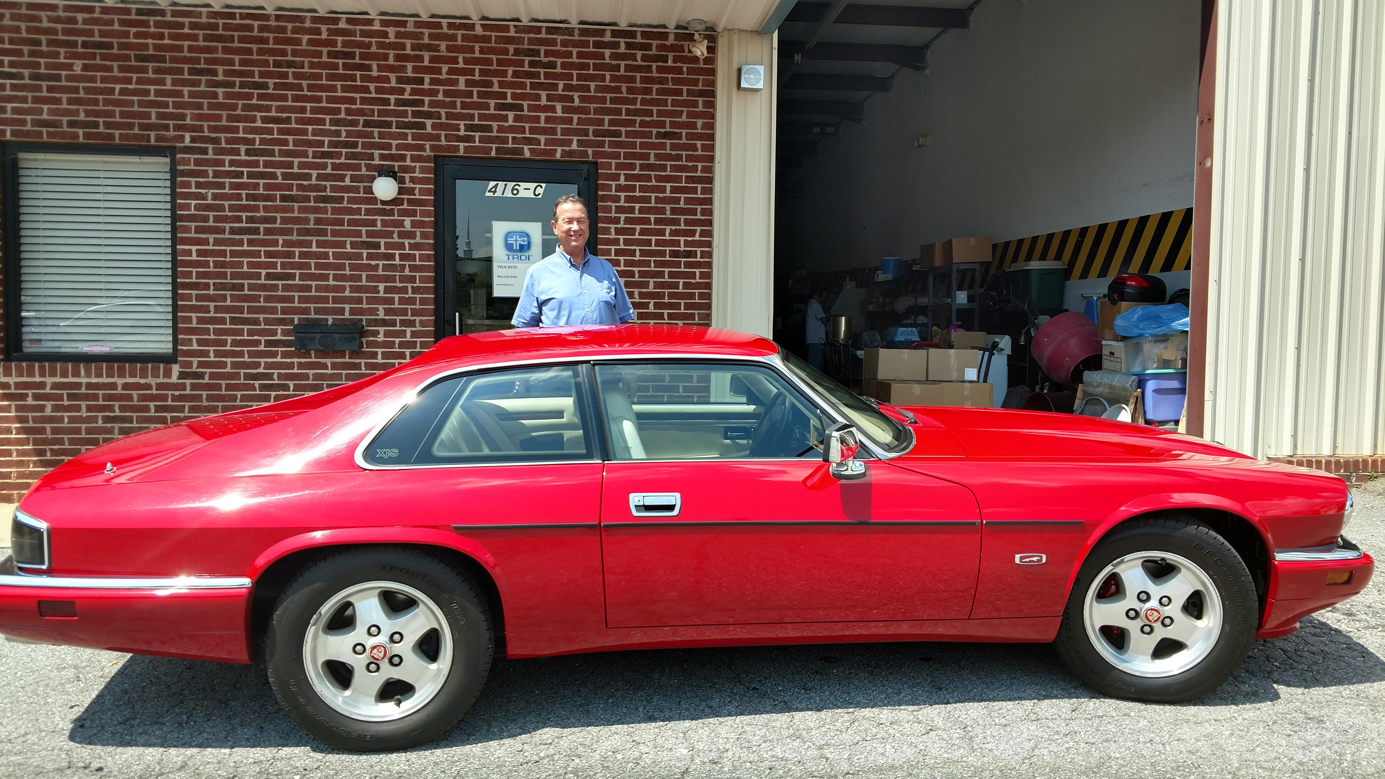

Rough start. New member and posted to wrong forum. The were nice when they threw me out.
I recently purchased a 1996 XJS coupe in fantastic shape and I have started to drive it to work daily.
Noticed small oil puddle in front center and discovered that there is an engine oil cooler.
My question is," what is easiest way to get at this cooler and hoses? If I have to remove bumper is there a guide for this?"

That's probably a 95... what is the last six digits of your vin?
Very rare to have the coupe on a facelift XJS....

196874 are the last 6 digits of the VIN. You are correct it is a 1995. What do you know about replacing the oil cooler in the front? Can you replace it without removing the bumper?
