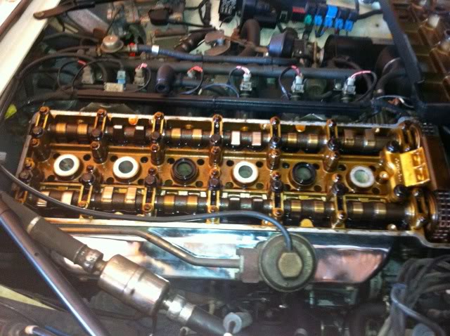

The valve cover and spark plug rubbers is like a $20 part (give or take) and took me thirty minutes to do. Don't know about the front seal. The AC might be easy or might be difficult. That said, a mechanic (even a 'jag' one) probably won't know much about this car and will spend a few hundred just figuring out where this stuff is. If you're willing to do it yourself and learn, none of the repairs sound that expensive or difficult (again don't know about the 'front seal'). If you're going to have a mechanic do it, I'd say keep walking.
BTW, the black ring in this picture is the spark plug ring for reference.
