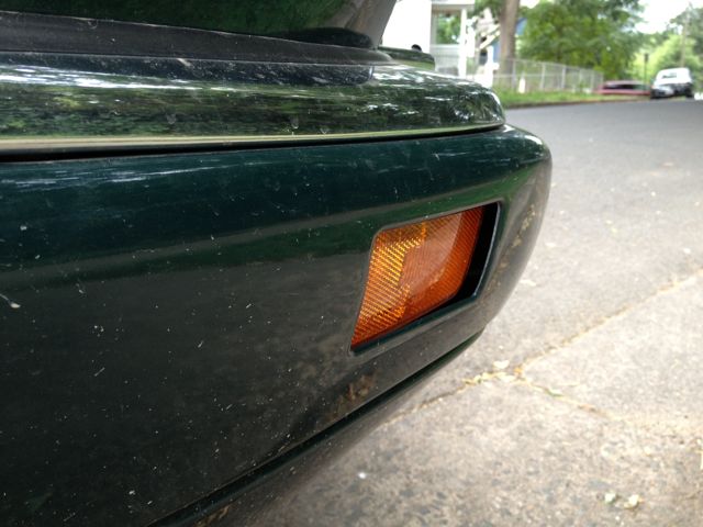

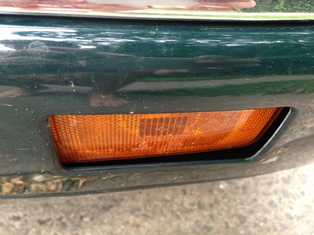

I have a 1996 XJS and the passengers side sidemarker on the front bumper is recessed from the bumper. I have attached photos.
Would anyone know how the sidemarker is attached? I feel I should be able to correct this without too much trouble.
Am I wrong?
Thanks.

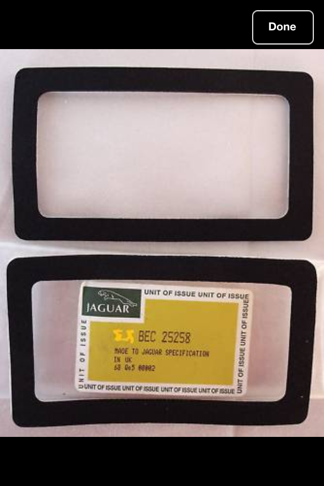

There are sticker type gaskets that adhere to the interior of the bumper to keep the light in place. Typically the bumper has to come of. I just had my bumper of for paint reasons and the gaskets went in
