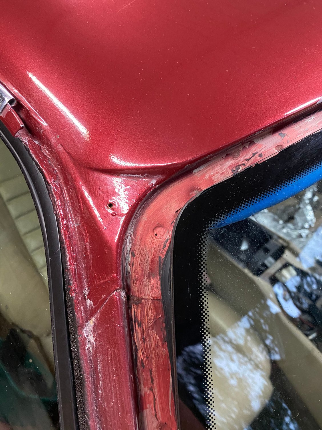

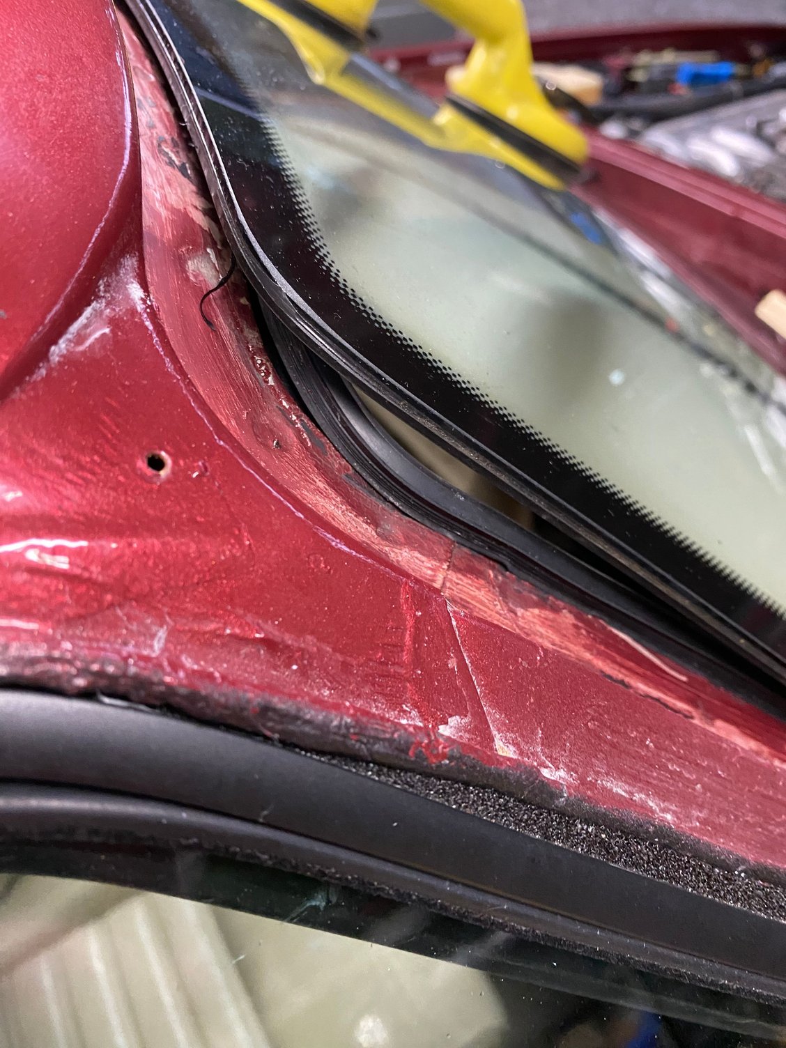

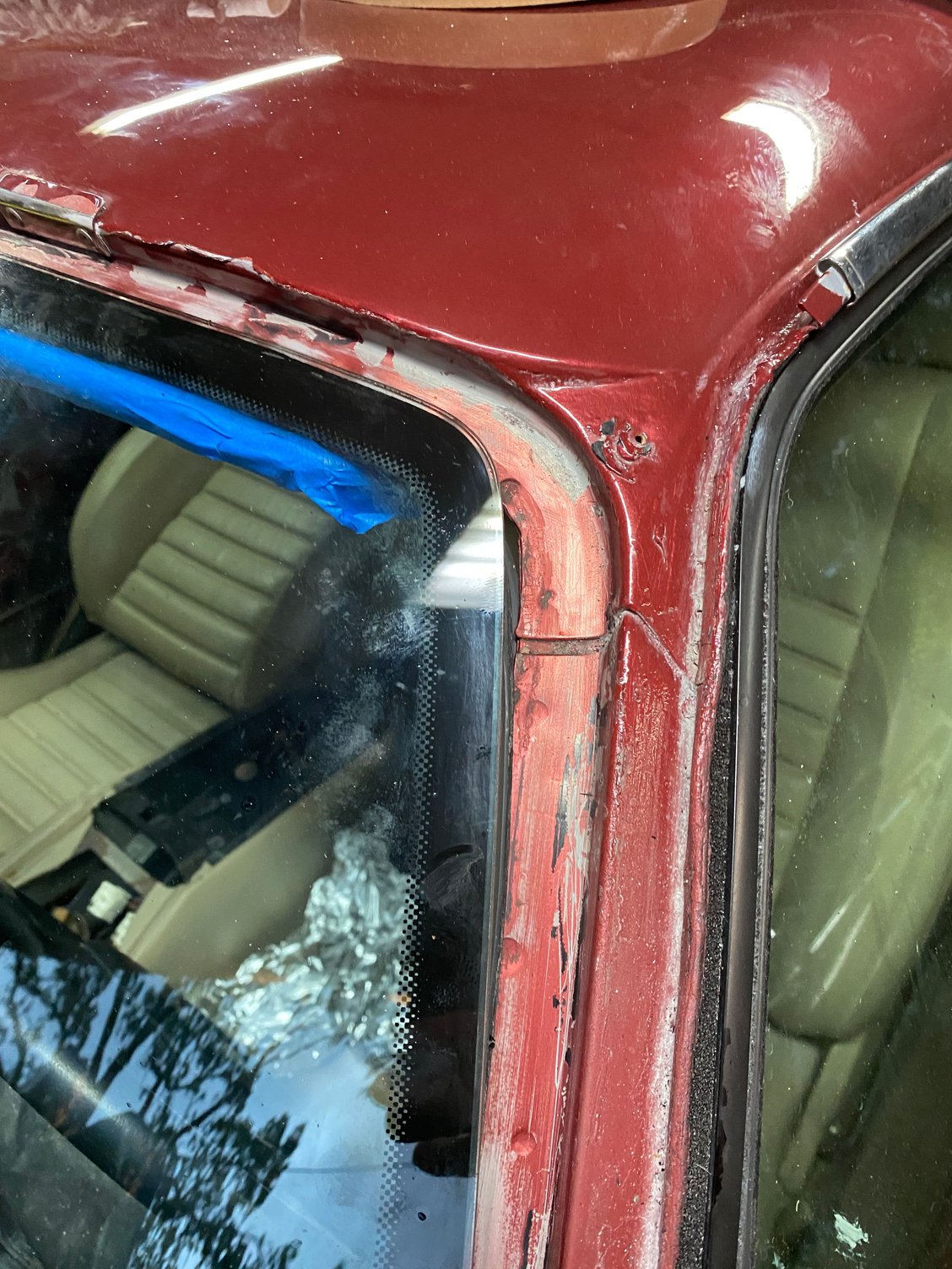

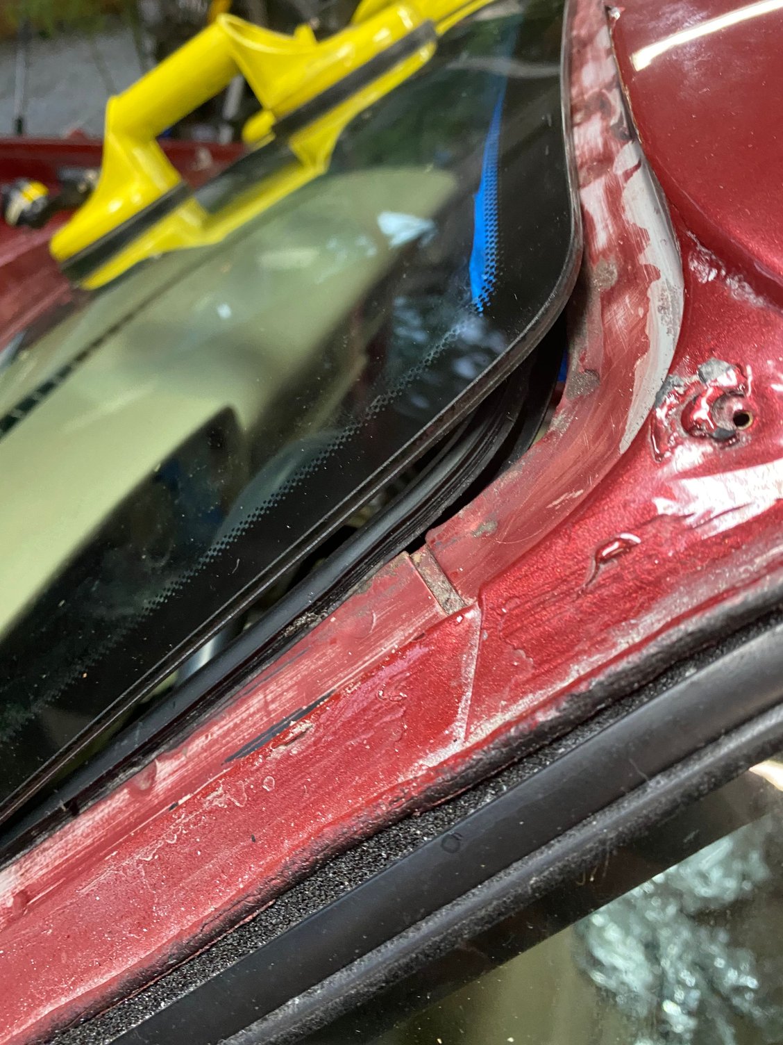

I’ve got a 1992 XJS I’m working on. Just repainted and needed a windshield. Safelite and other suppliers said they didn’t have one. Further research from forums suggested all facelift windshields are the same, coupe and convertible with only difference being the rear view mirror mounting. In fact, I read one post from someone who had a 94 convertible windshield in his ‘92 coupe.
soooooo… I’m scouring the web for a used windshield that’s close to me. Found it, from a 1994 convertible—but it doesn’t fit.

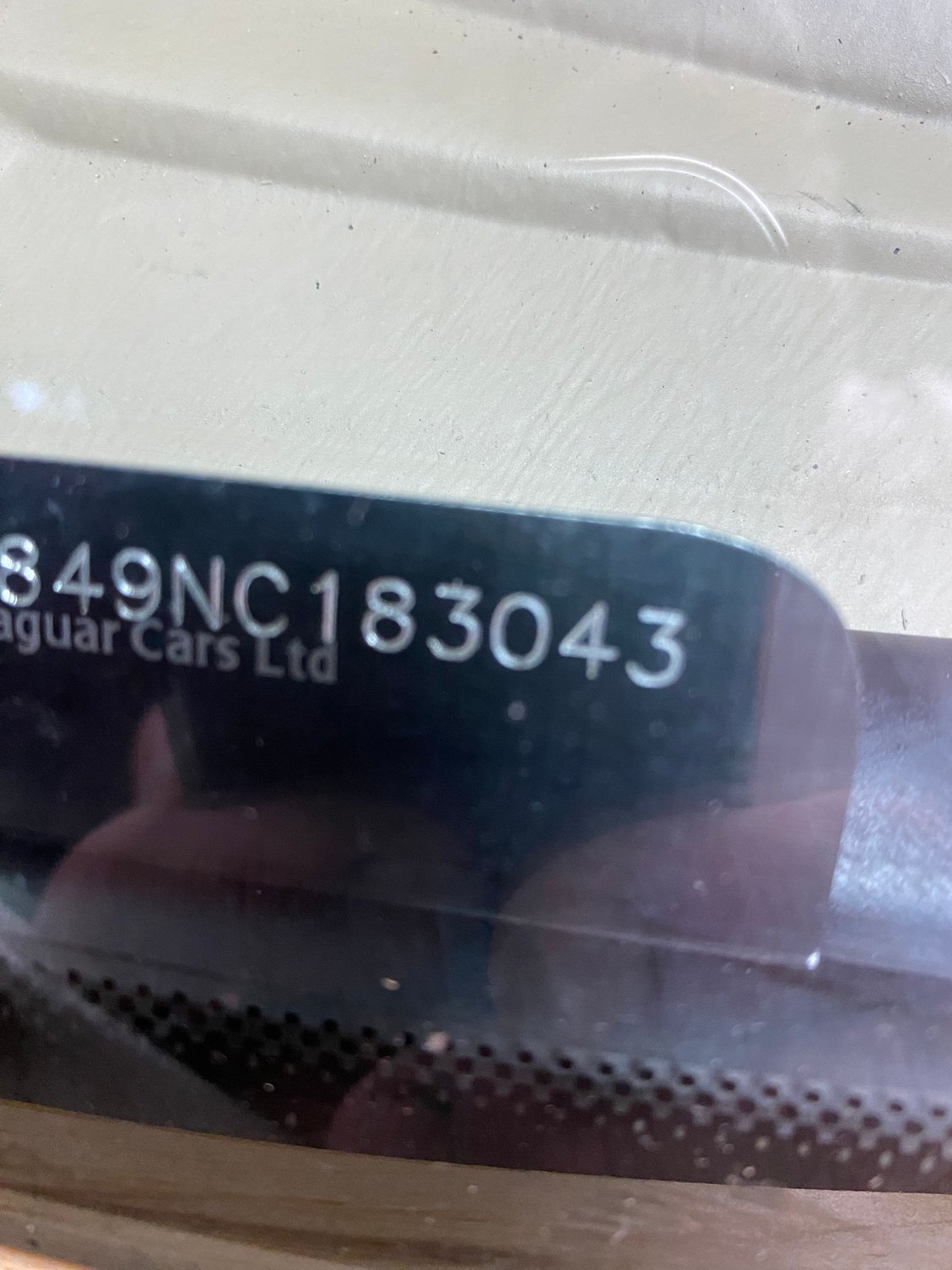

so, ARE there actual differences between coupe and convertible? Or is my ‘92 some weird hybrid that has the pre facelift windshield? My original has the dot matrix signifying a bonded screen. And it is, or was “bonded” (not with urethane but with something less durable). VIN is 183043
Does anyone have a pre and post windscreen they can measure for me? Or the opening in the body?
here are some pics.

Windshields up to 188966 are different that ones post that VIN. A 94 would likely be around the 19xxxx VIN, or later. The windshield opening/cowl panel is also different, as is the bright trim, rubber gasket, etc. The parts manual for the late cars starts at VIN 179737, so you need a windshield for a car between that VIN and 188966.

Just to clarify, the changepoint is at 186966, rather than 188966.
