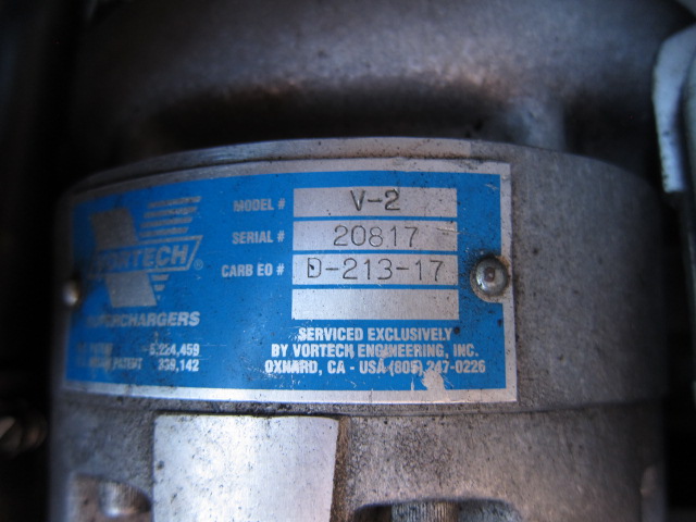

[QUOTE=Forcedair1;847553]
Originally Posted by Scoupe89
Actually Powerdyne or Vortech could fit a centrifugal supercharger for our cars that would make it a different animal.
Mercedes Benz SL Class SL600 | eBay
QUOTE]
You bet it would make it a different animal!
By "our cars" I assume that you refer to the XJS, V12 or I6?
If so, would you know if they may work out a CARB EO approval for CA?
Centrifugal compressor is not really the ideal way to s/c, but it sure is better than nothing, as I find that it'd be easier to adapt a centrifugal compressor (a la turbo) over a traditional, plenum mounted S/C compressor. I can easily kill the lag by selecting the "drive" mode on my N2O injection, which gives me an initial 1/2 second push/kick.
But California doesn't make it easy.
The SL 600 v-12 is CA compliant and the car was registered in CA.
The car is in Scottsdale now and I believe I have seen it at shows.
There is more money than smarts over in Scottsdale!
The aj16 is an easier motor for mods like forced air and N20 as there is a much simpler design and much more SPACE!
I bought Nitrous Express Wet N2O for my '89 XJ-S v12. It proved to be a PITA to tune and distribute even flow to each cylinder. The N2O broke lots of parts at the track and a Ford TBird was a better candidate.
