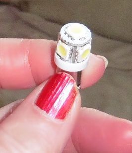

I replaced my feeble, archaic incandescent bulb with a 5-unit LED:
Lit them right up, it did! I can see then all easily.
