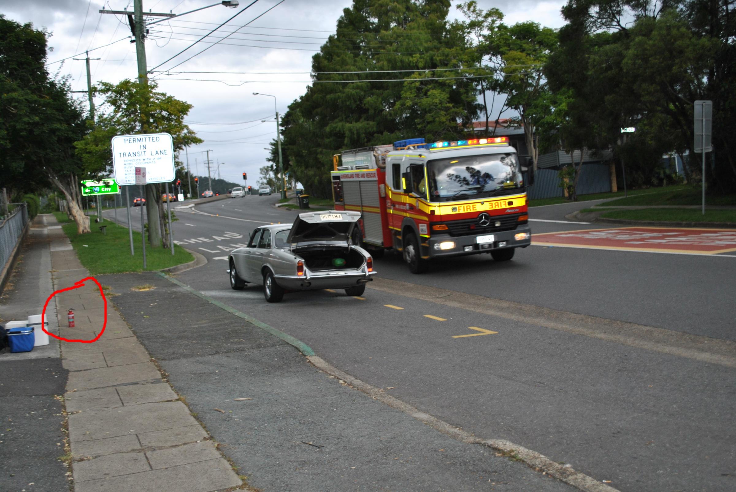

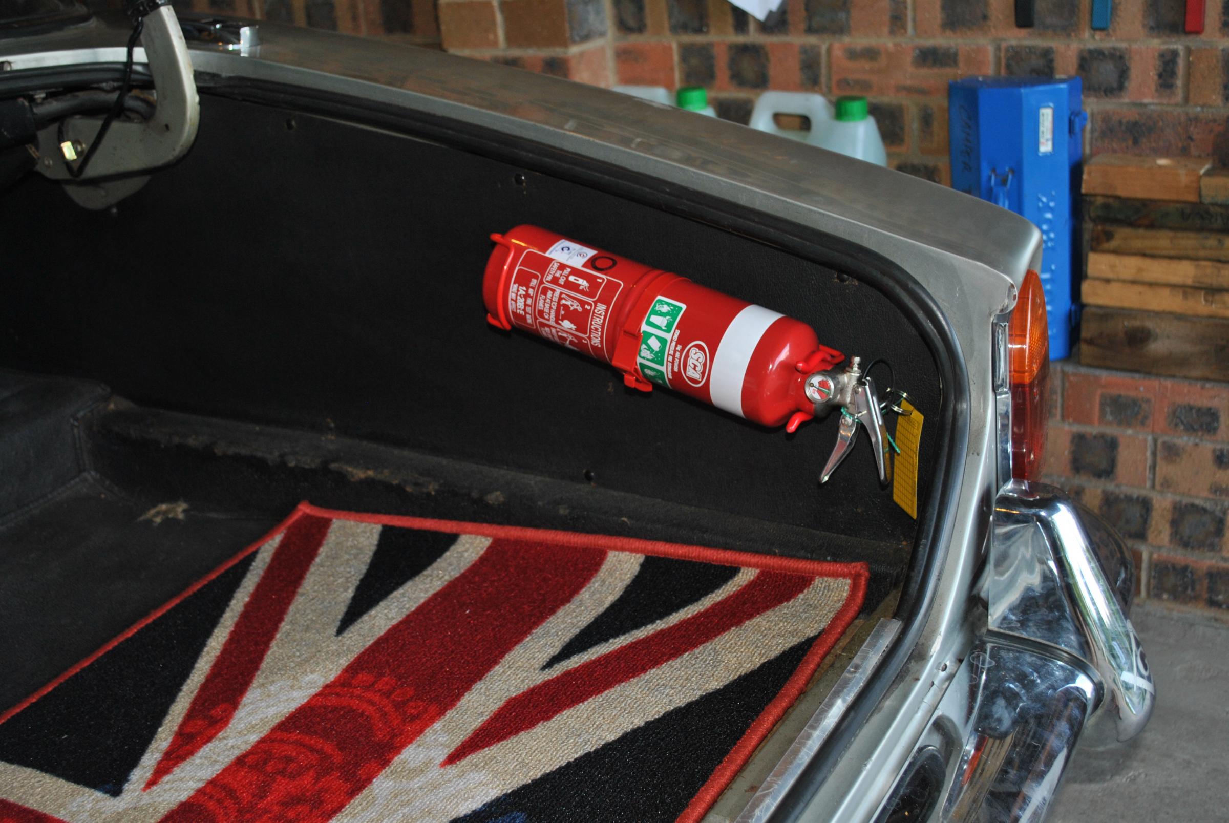

1 kg gross weight dry powder type extinguisher is ample (contains 1 kg of AB powder).
Mount it where the driver can reach it from the drivers seat or on the drivers side of the car at least.
Half discharged will fail, I tried to use one to show my kids how to use it(a year after it was first used) it failed. taught them with a new one.
About $20 - $30 from auto store or hardware.
I have had to use one 3 times (only once on my car).
