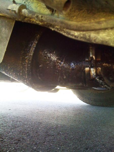

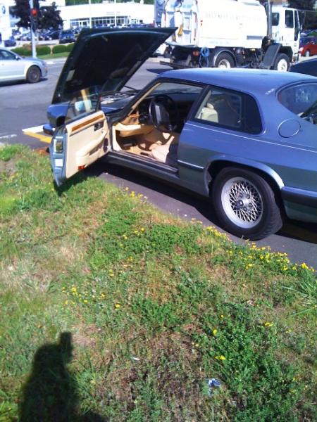

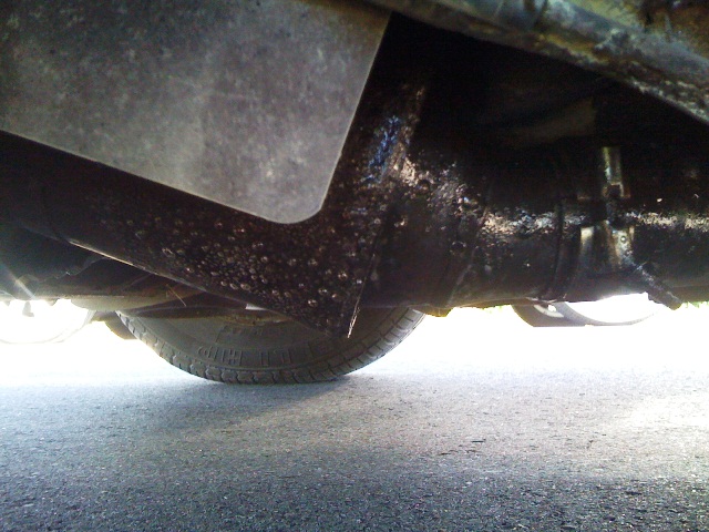

Yup. I drove about 2 miles this morning and the car felt great. Then I felt a slight rumble, probably a misfire. Drove another mile and the loss of power was evident, I pulled over and shut her down. I couldn't see anything going on under the hood and no CE light. I started it back up drove 1500 feet and she caught fire, drivers side I believe the first cat? I opened the trunk and grabbed the spare wheel cover and tried dousing the flames, it kept burning. From the God of heaven a guy pulled over who had an extinguisher and I put it out. I burnt my hand pretty bad from the spare tire cover melting on my skin. The other day, I noticed a misfire and she triggered a FF13, I re-set the CE, and just 4 days later she caught fire. It now triggers that same 13. I not sure of the damage yet, I may have gotten away with it not being too bad, I don't smell any burnt rubber. The question is, where do I begin to diagnose this? It is a Marelli ignition. 92 5.3, 72k

Marelli failure on one bank (driver's side) dumping raw fuel into hot cat and we know the rest of the story.
Thankfully the damage doesn't look too bad - new cat (or hollow out the case) and rehab the ignition.

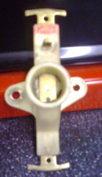

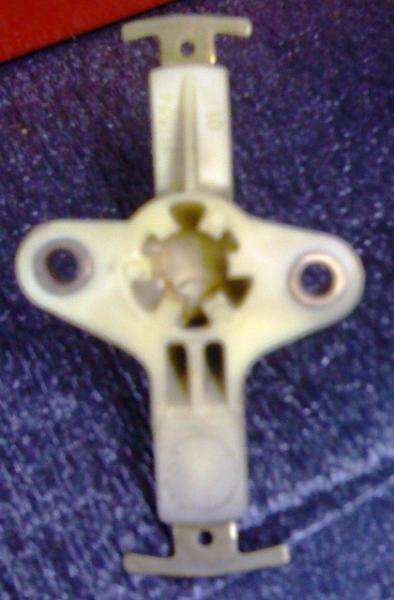

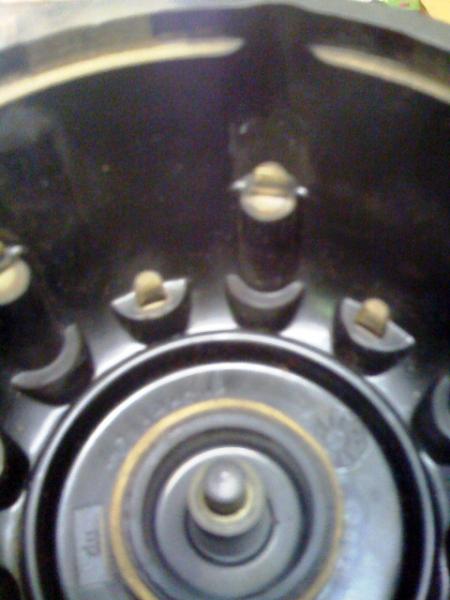

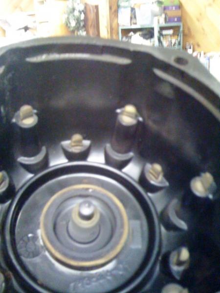

Old Jun 28, 2012 | 09:48 AM
mrtalkradio's Avatar
Posts: 863
Likes: 106
From: New Hampshire

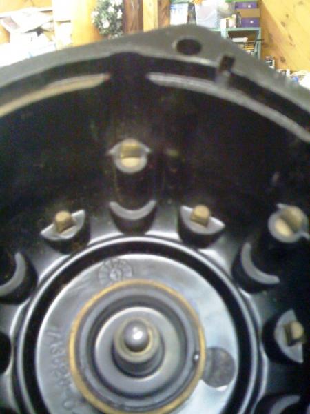

Distributor cap 3 views rotated. Rotor both sides, and what's left of my spare tire cover.
Attached Thumbnails Fire Victim 173-dc1.jpg   Fire Victim 173-dc2.jpg   Fire Victim 173-dc3.jpg   Fire Victim 173-rotor1.jpg   Fire Victim 173-rotor-2.jpg

Old Jun 28, 2012 | 12:24 PM
Roger95's Avatar
Joined: Jul 2010
Posts: 887
Likes: 236
From: TampaBay
I believe the problem lies with the dual level cap and the rotor. There are fellows on this site who know far more about the Marelli set-up than I. One "level" fails to make contact not firing any of the spark plugs in the corresponding bank of cylinders, thus dumping raw fuel into the hot cat and starting a fire. I would replace both cap and rotor to start.

Sarc's Avatar
Joined: Oct 2008
Posts: 1,930
Likes: 537
From: San Jose, CA, USA
@TalkRadio
Sorry to hear about your mishap. Hope the hand is ok. I had exactly the same failure within a year of having my XJS. I managed to save mine as I had a fire extinguisher in the car. (I now have 2)
Your cat is probably dead so getting a SMOG pass may be a challenge, but you can wait until you need that before dealing with it. The most important thing right now is to get back on the horse ! Yours is a very pretty car and you've probably had the worst experience you can have with these cars and you and the car survived. You've experienced a Marelli failure first hand and I guarantee you will not suffer from it again, because you will know for sure the feeling when the car loses power and you'll pull over straight away and you won't restart it and you'll have 4 fire extinguishers. Having the failure on the left hand bank is actually better than the right hand bank, because the right hand bank cat runs near to the transmission oil cooler lines and they can get burned and thats a whole heap of fun to fix apparently. Thanks to a PO messing around with aftermarket cats on my car, My steering rack boot caught fire on the left hand side, because the cat sits closer to it than it should. It was the thick black smoke coming from that that finally convinced me something was wrong :-)
Anyway, as to why you had the failure in the first place, as you will know, you have basically 2 of each component, ie 2 coils, 2 power modules on the radiator top panel.... I just did process of elimination and swapping parts from A bank to B bank to find out what the problem was. In my case it was a failed coil. To do the diagnosis I had the fuel pump disconnected by pulling the fuel relay and I pulled a plug lead on each bank and inserted a spare plug and then watched for sparks as I swapped parts over. It was pretty obvious I had zero spark coming from 1 coil. I then replaced BOTH the coils and I've been fine ever since.
I spent a lot of time looking at the distributor cap, etc, then I started reading about getting a replacement, and how some "real" Marelli caps don't have Marelli stamped on them, and some fakes do, etc, etc So I finally decided to leave the cap and rotor alone, but I pull it every few thousand miles or so and have a look inside. From your pictures, your cap "looks" ok but I'm not completely convinced a visual inspection would show a problem in every case of failure. My money is on a single coil failure.....

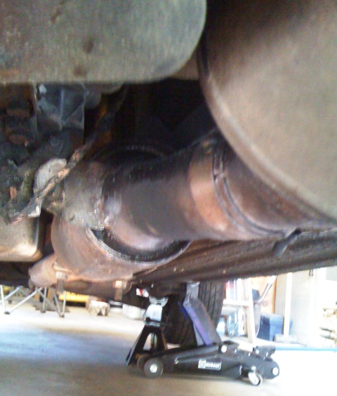

Check it out before running with it. If it got hot enough to catch fire, it may have gotten hot enough to melt internally. Once the matrix melts and collapses, it could cause an obstruction and it won't flow as well. The restriction could cause other issues.

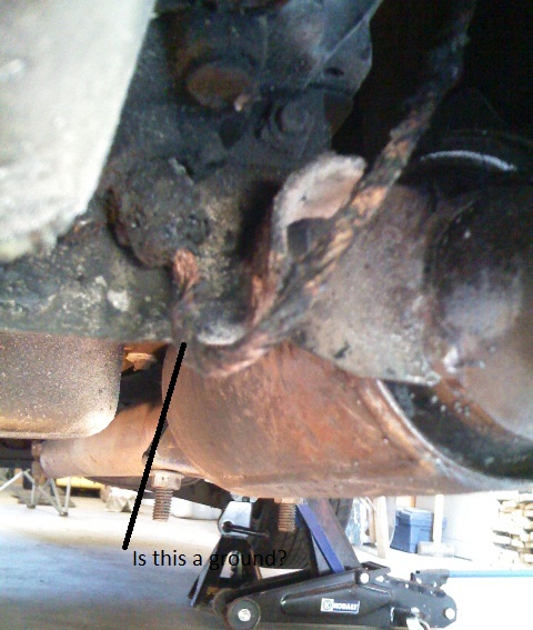

I'm very impressed with jaguars heat shielding around those cats. That prevented major damage. Everything looks great under there as you can see, it was fuel that was burning off, and the extinguisher came at the right time. The only thing charred/burnt is that cable/wire. It seems to have had some coating on it, now burnt off. What is it? A ground?

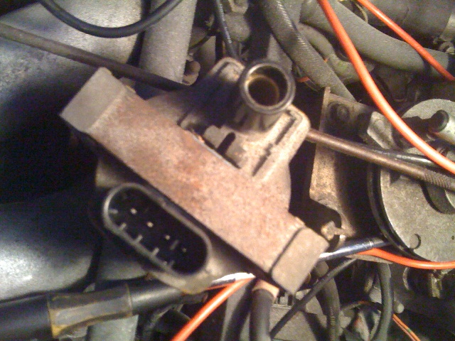

Posts: 863
Likes: 106
From: New Hampshire
Default Culprit
B Coil Failure.12+ volts from A, 6.2 from B.Performance Jaguar 60$ new Coil. Shout out to Brian Welker from Fasterjags, he is a monster. Tell him I sent ya.

Joined: Oct 2008
Posts: 1,930
Likes: 537
@TalkRadio
Agree about Brian, he's a great help for the XJS... I am anxiously awaiting delivery of my catcooler twin fan conversion kit. Hopefully you got 2 coils so you can fit both new ones and keep the working old one in the trunk "just in case"
