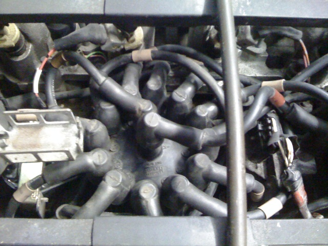

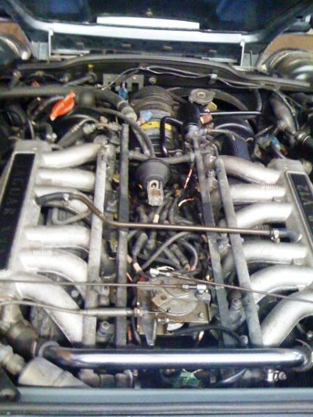

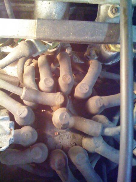

No first trip yet. She won't start. cranks and cranks. I have 12 volts from each lead as well. This pic is looking from the drivers side. A Coil to the right, B coil to the left. Does this look like the cap is on correctly?
Maybe I banged my head to hard, I'm confused.
Pic one is the way I bought the car, so that when I took the wires off I would remember how they went on.
Pic 2 is in April after i put them back, it sure as heck doesn't look like pic 1. But the car ran up until the fire.
Pic 3 is today, going back and using pic one.
She won't start
Attached Thumbnails Fire Victim 173-distrubutor-lh-drivers-side-view.jpg   Fire Victim 173-april-wiring.jpg   Fire Victim 173-cap.jpg

She won't run with that crankshaft position sensor burned and melted...
Your rotor wasn't the guilty party this time, it was a simple coil failure.
