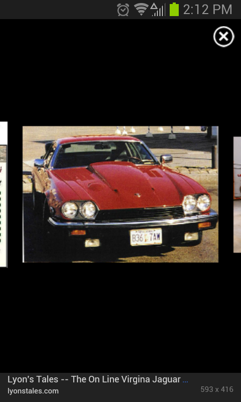

This is what I have been thinking about .it looks suttle its not over kill but it gets the job done I plan too add louvers as well

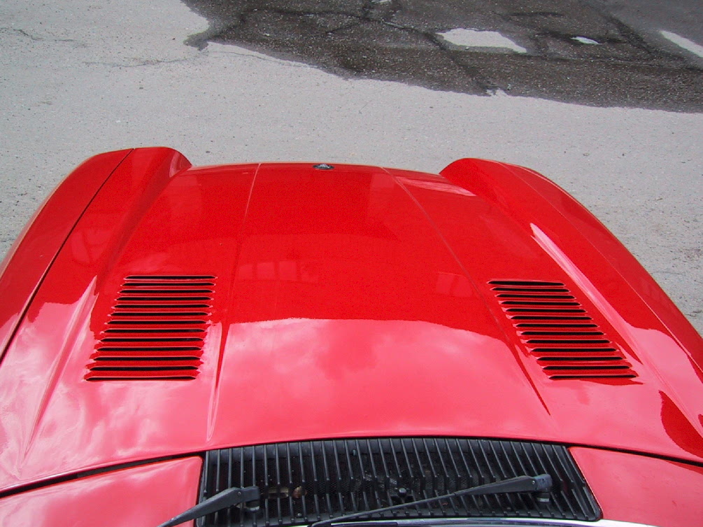

I was thinking of this look

Nice calvin ! I kinda like that .

looks nice ,but iv never been a fan of long plug wires, things like ignition crossover on hi-output coils have been known to cause problems!
like when a coil fires a particular plug and it runs in parallel to another lead it can/may fire the wrong plug, and fire it early,causing detonation at the plug, its called induction crossover!
that car in pic has been runnin round 5-6yrs with GM packs,in the Vee, no problems.
but if it makes you happy go for it, a lot of us are waiting!,
