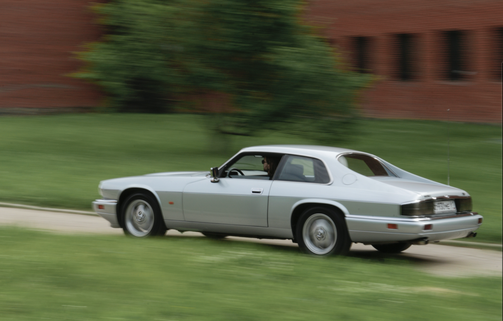

For me the ideal room between arch and the tyre is when i can put my 2 fingers easily (3 fingers with a little angle) like on the picture.
We've changed only one spring temporarily for the test (after switching sides) and i'm still not satisfied with the result. The car sits higher on one side but it's definitely better than sagging. Now it's winter in Moscow and i don't drive my Jaguar, but will probably order Eibachs or aftermarket ones (fingers crossed). Will keep you posted.
