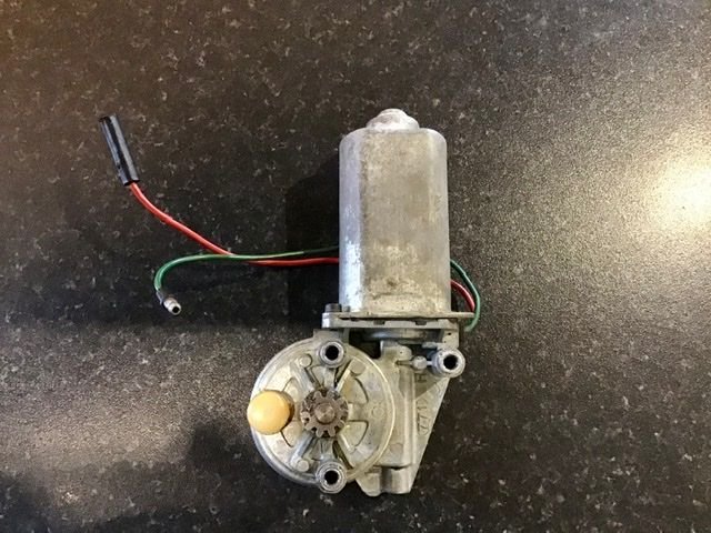

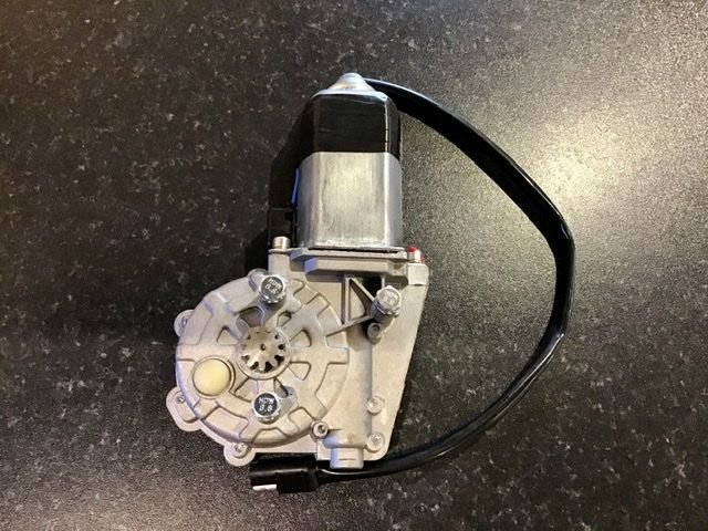

This is the passenger door motor.

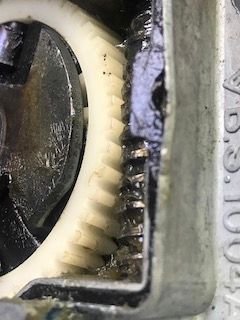

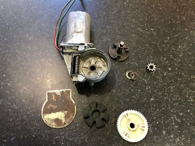

I have striped the motor gear box.
this is the gear as you can see the teeth have striped.
don’t suppose anybody has a scrap motor. I only need the plastic gear as everything else is fine.

Is the motor you have the same as I have pictured. This is a Delco part.
Cheers Rob.

Yes, it is identical. It has the flat side the same as your picture.
I have removed it from the door now. I did not open up the motor but it is separated from the actuator arm (3 screws). All I would have to do is wipe it off and box it up.

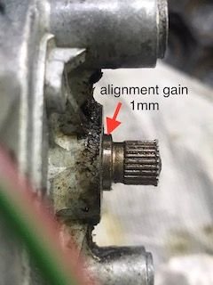

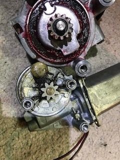

Going through the same pain. Unable to obtain a replacement nylon gear or a replacement motor at a reasonable price.
My '89 Coupe LH passenger side motor is identical to the one in the previous post.

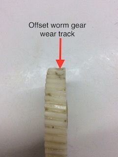

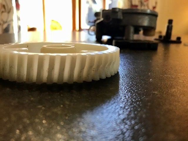

This is what I believe caused the stripped Nylon gear teeth.
Firstly I checked against a round case motor but it had more teeth of a different pitch although it will bolt to the alternative holes in the plate.
I dismantled the gear box by grinding off the end of the peened over shaft to remove the drive gear and found this off set wear pattern on the stripped teeth.

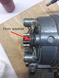

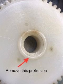

So I removed this protrusion to shift the gear across.
This gave me a 1mm shoulder for a spacer washer.
I fitted a 1mm copper washer and reassembled using locktite on the splined shaft.
Here is the new engagement.
This will hopefully give the window a new lease on life.
