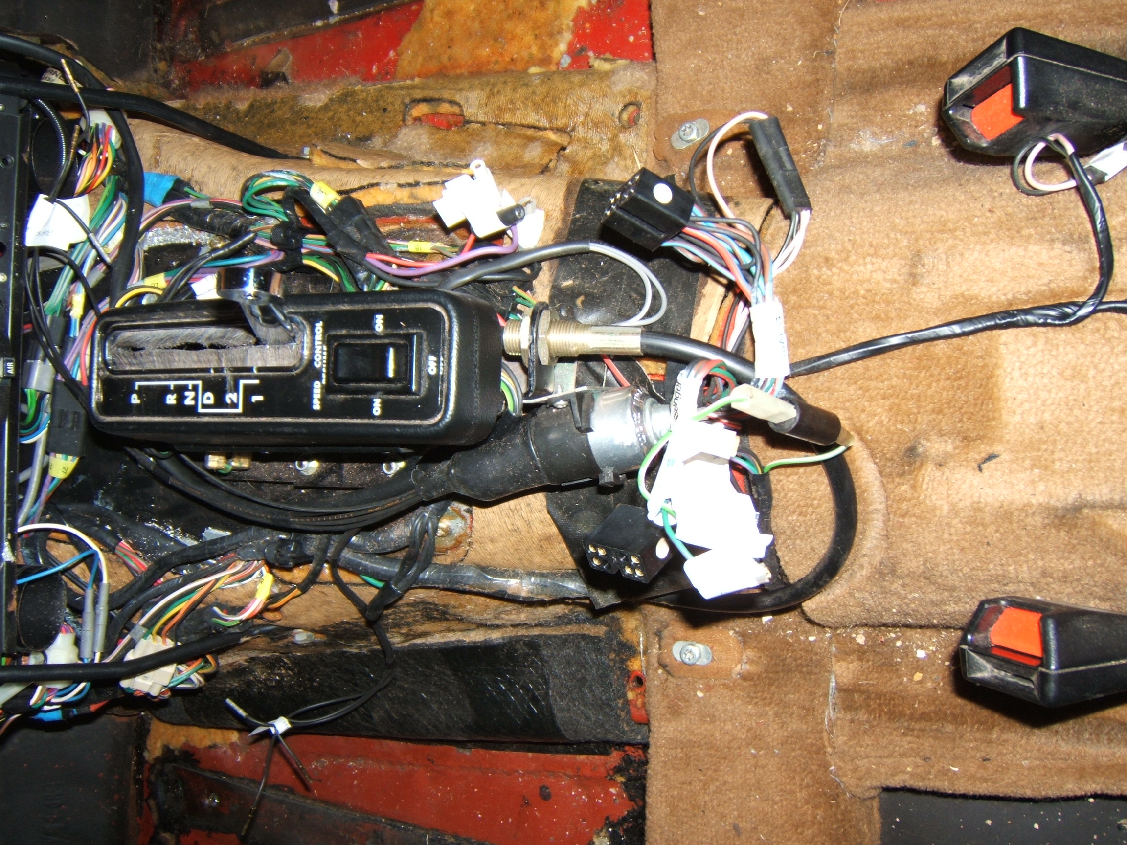

At the rear of the gear selector, once the console is off, you will see the cable adjuster. This can be adjusted a touch to let the selector more exactly hit its détente (ie the selector end of the cable should be moved a bit rather than the gearbox end), if that is the problem. It could also be the détente has worn out somewhat. This pic shows the adjuster.

Had a chance today to pull up the ski slope, and see if a little adjustment would fix the problem.
I wasn't exactly sure how to go about adjusting it, but decided to see if I loosened both nuts, and moved the lever into the proper "R" position, then made sure the transmission was actually in reverse, and retightened. Seemed to work perfectly, and all other shifting works as well.
The adjusting nuts were quite tight so I don't exactly how the lever got out of adjustment or if there is something I should be concerned about.
