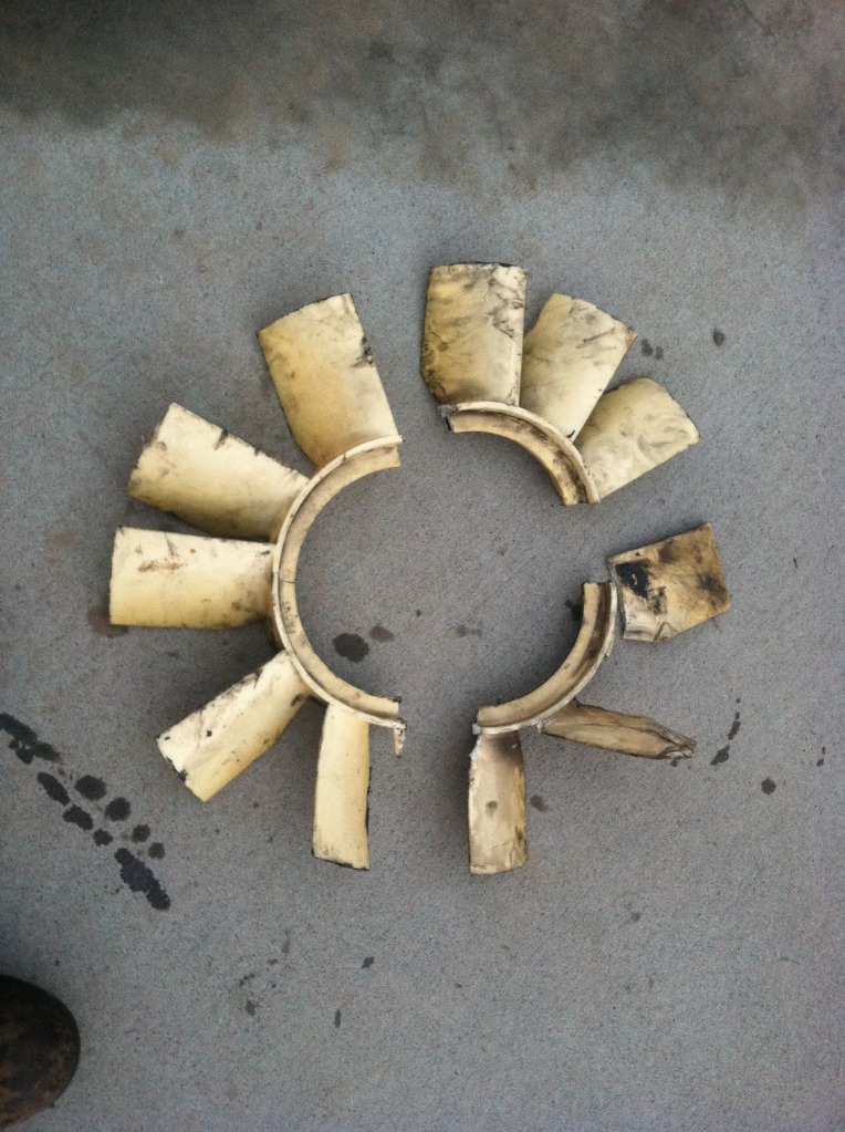

So on too the rest of the story. Noticed the B bank was missing on a cylinder, briefly tried to diagnose which cylinder and found a cracked plug, but before i went back to tearing apart the top half of the engine to get out the damn plug, i decided to give her one last reassuring rev (bad idea). Got her up to around 3000rpm and POP, backfire. So i immediately back off and the engine quits and steam billows out.
Open up the hood to find the small hose going to the top of the radiator fill tube is broke, so i thought, no bid deal just popped an old hose with the backfire, wrong. I look down into the front of the engine bay and there is my fan, in three pieces.... The old original fan (i assume) shattered from the sudden change in torque. The fan had chopped the coolant hose clean in half, tore up a few minor electrical wires, and then i see a nice D-cell battery sized hole in my radiator....
Well, im being optimistic here and telling myself i needed to change out the rad and convert to electric fans anyhow, the electrical wires will be cake to repair. It will also make me tear off the front of the car which i havent done yet and need to do anyways.
So if there is any advice i would give u guys is, please, replace your fan if you have any doubt that it hasnt been already, or better, go electric. If i had the hood open and was standing on the side of the car looking in when this happened, i would no longer have a head... Save your self from repairs, and medical bills.

When I replaced my engine I found the fan was littered with tiny cracks. I didn't even try looking for a mechanical replacement. Off I went to Advance Auto Parts and bought a similarly sized electric fan. It fit perfectly inside the original shroud and keeps the engine nice and cool.

yea, took about an hour or so prying the fan blade out of the radiator, then about another half our weaving it out of the engine bay. definately goin with electrics
