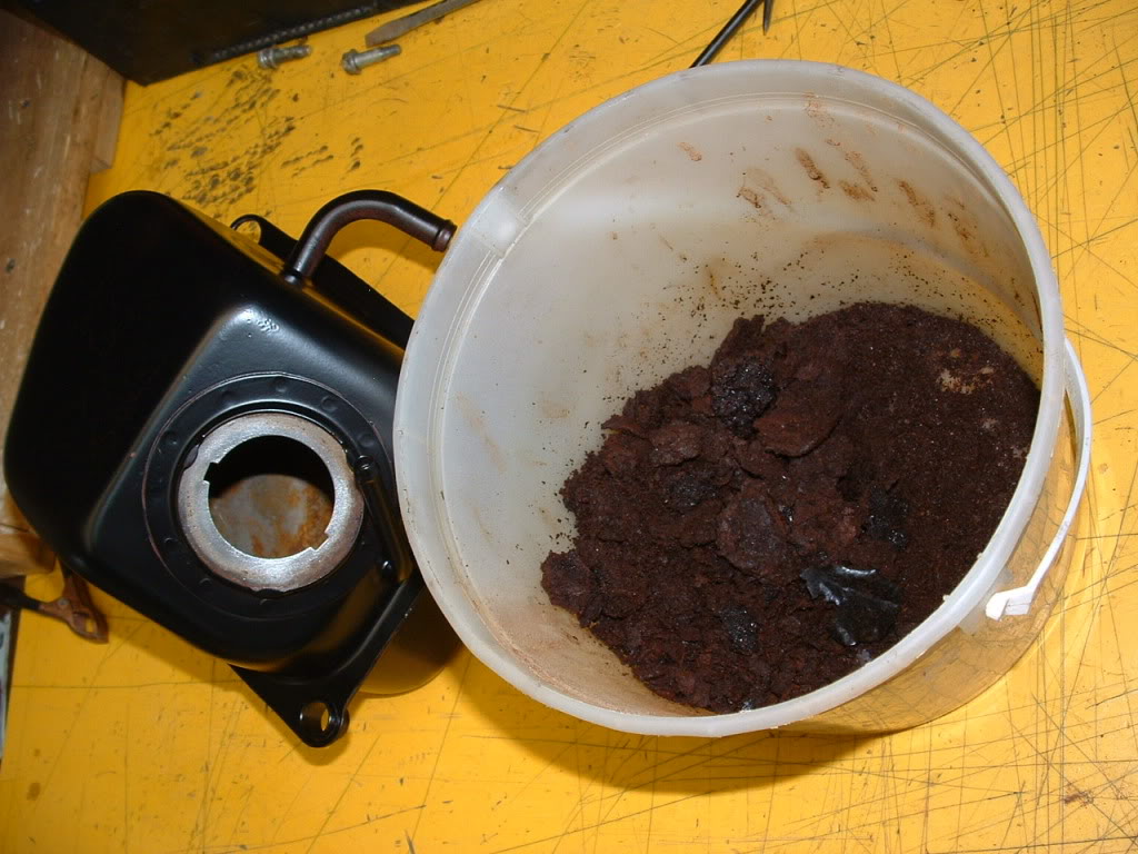

That cute little surge tank in your trunk may be creating the next major problem you will have to face. Inside there is a plastic screen that keeps large particles from getting to your fuel pump...that is, if it is good and still in place on the end of the pickup tube.
When I first purchased my XJS, it had several issues. One was that the plug wires were on the distributor in reverse order and even out of order. The car ran, miraculously...and I limped home with little to no power. The first thing I did was to make sure I had a clean fuel supply and the right pressure on the fuel rail at the engine. I pulled the surge tank and this is what I found in it.
The sludge is non magnetic and that means it is not rust flakes. The upper tank is shiny and clean and after I cleaned out the sludge, the surge tank was too. The screen filter was completely plugged. What is it?...I have no idea.
I read somewhere..that a good idea was to remove the screen filter altogether and install a real filter outside the surge tank..before the fuel pump. My car was also missing the fuel filter after the pump. After a few months of trying this, I found that I was getting a whine from my fuel pump..I suspect that the pump is cavitating trying to suck the fuel through the filter I added in front of it. The pump is not made to do this. It is better at pushing than pulling. (I am in the process of replacing the screen filter in the tank and installing a new fuel filter after the fuel pump...as it was originally designed. Hopefully this will resolve my pump whine..if not, I may have a leakdown situation.) I would recommend that everyone check the screen filter and sludge/sediment situation in the surge tank. Being a lower tank, that is where everything will end up. This is not something you want to get into your fuel pump or injectors!

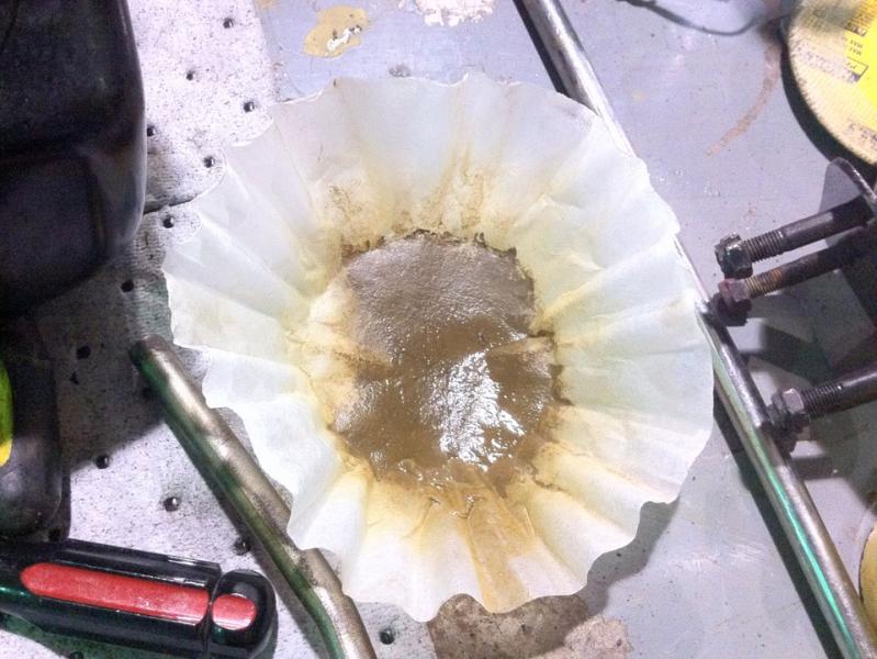

Here is what I got
Pickup screen was busted inward, due to clogging, so at least it did not starve the motor with fuel. Amount of sludge was lesser than yours, however definitely sizable. Sea Foam busted sludge off the walls in few minutes and I dumped the rest in fuel tank, after letting fuel pump suck in about 1 qt of it in fuel system. I even cranked the motor to let it squirt Sea Foam in cylinders and such, so now it will work its magic on my car's giblets. See some pics.

Originally Posted by Mish_Mish
Here is what I got
Looks like you got it squared away. Even a little bit of that crud is too much. I have ran injector cleaner through mine a couple of times and I too am a fan of Seafoam products. I think I'll do the same.
Nice paint job!
