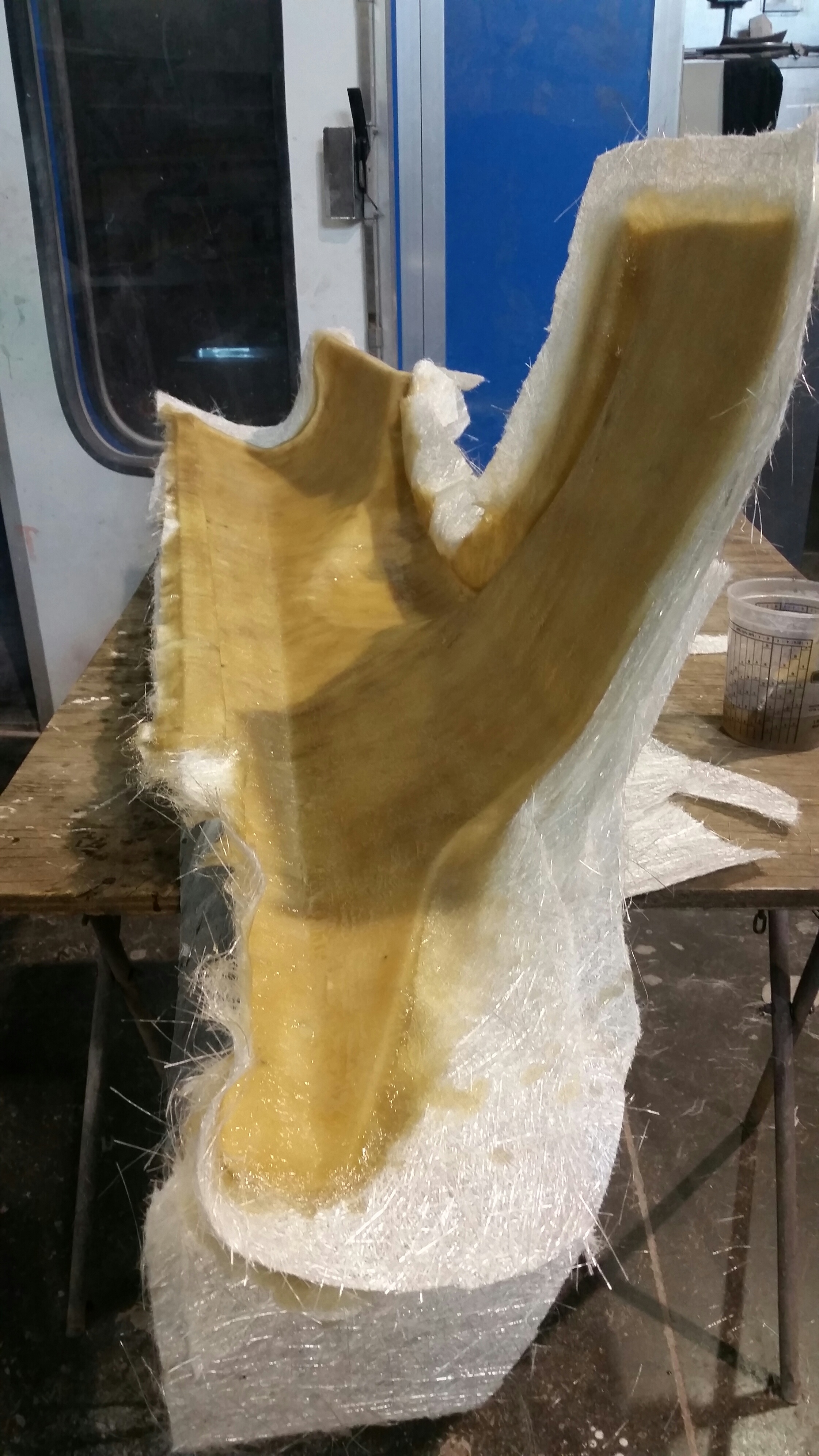

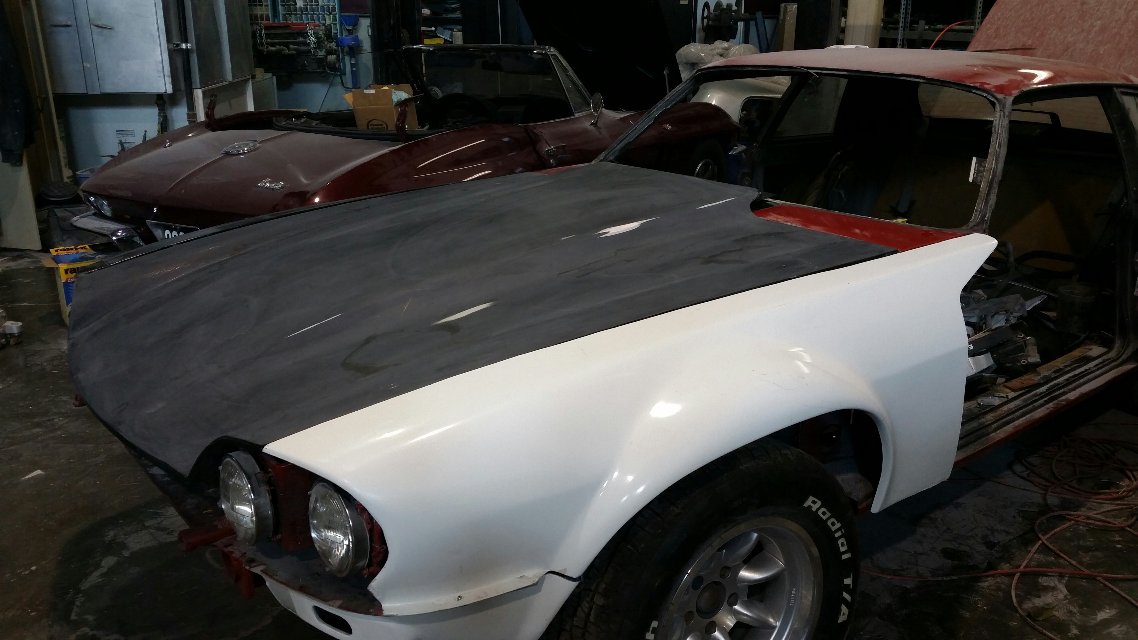

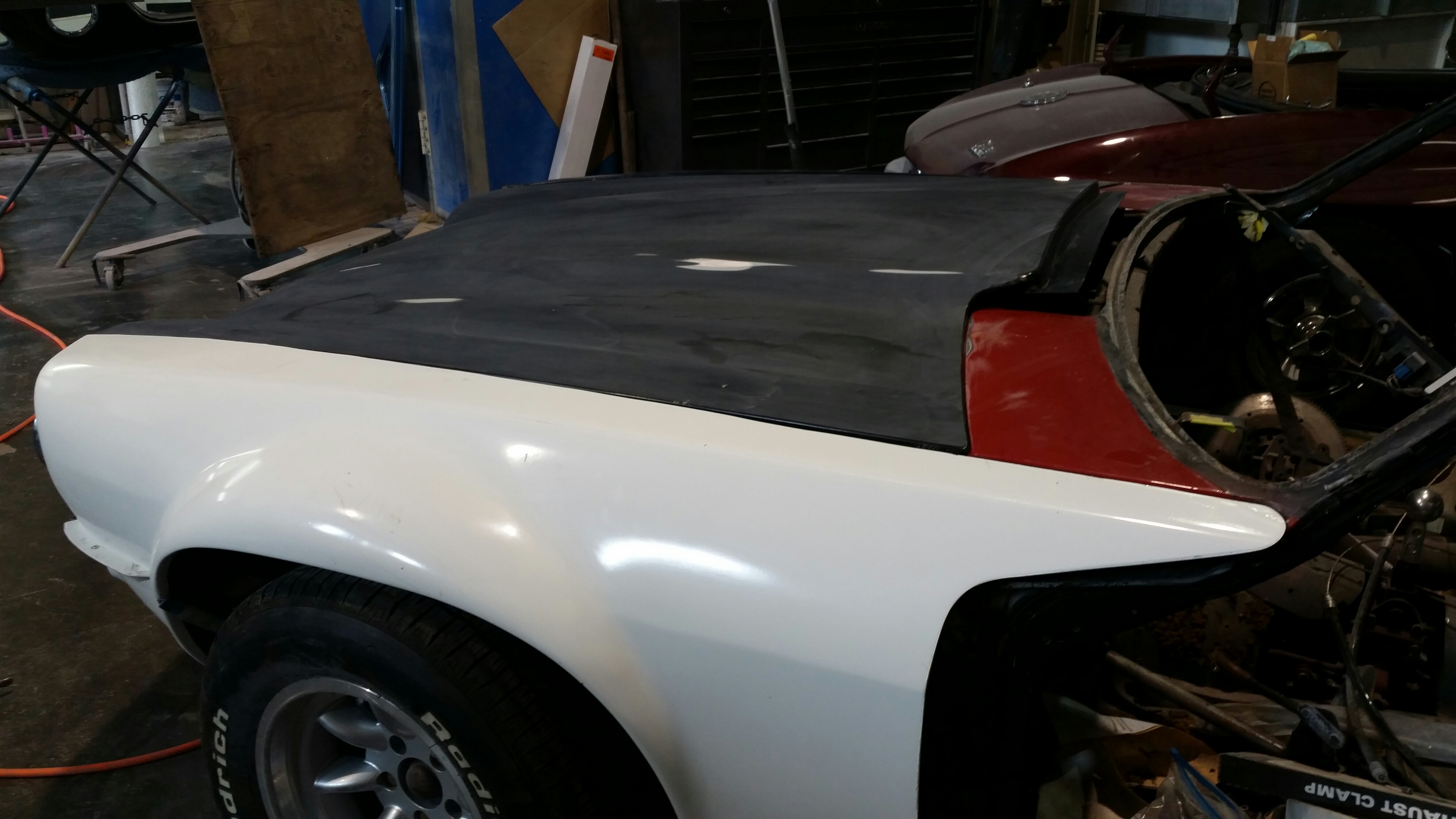

I thought I would post some pictures of the left front fender being made and of the cowl hood I am working on. One picture is the mold with gelcoat in it and several after layup and removal from mold. There are a couple from different angles with the fender and hood on. John

That's some great looking work there, John.
It looks like you've molded the lower front corners of the car too. Am I right?

Thanks Jagzilla,I did make the lower valances because the flare does extend into them. I was looking at your sketch of your desired modifications and your hood is similar to mine. The duct in your hood could be installed in mine with little effort. It gave me several ideas, the duct could be just in front of my air cleaner with a pan below it which would also bring fresh air in to remove under hood heat. John
