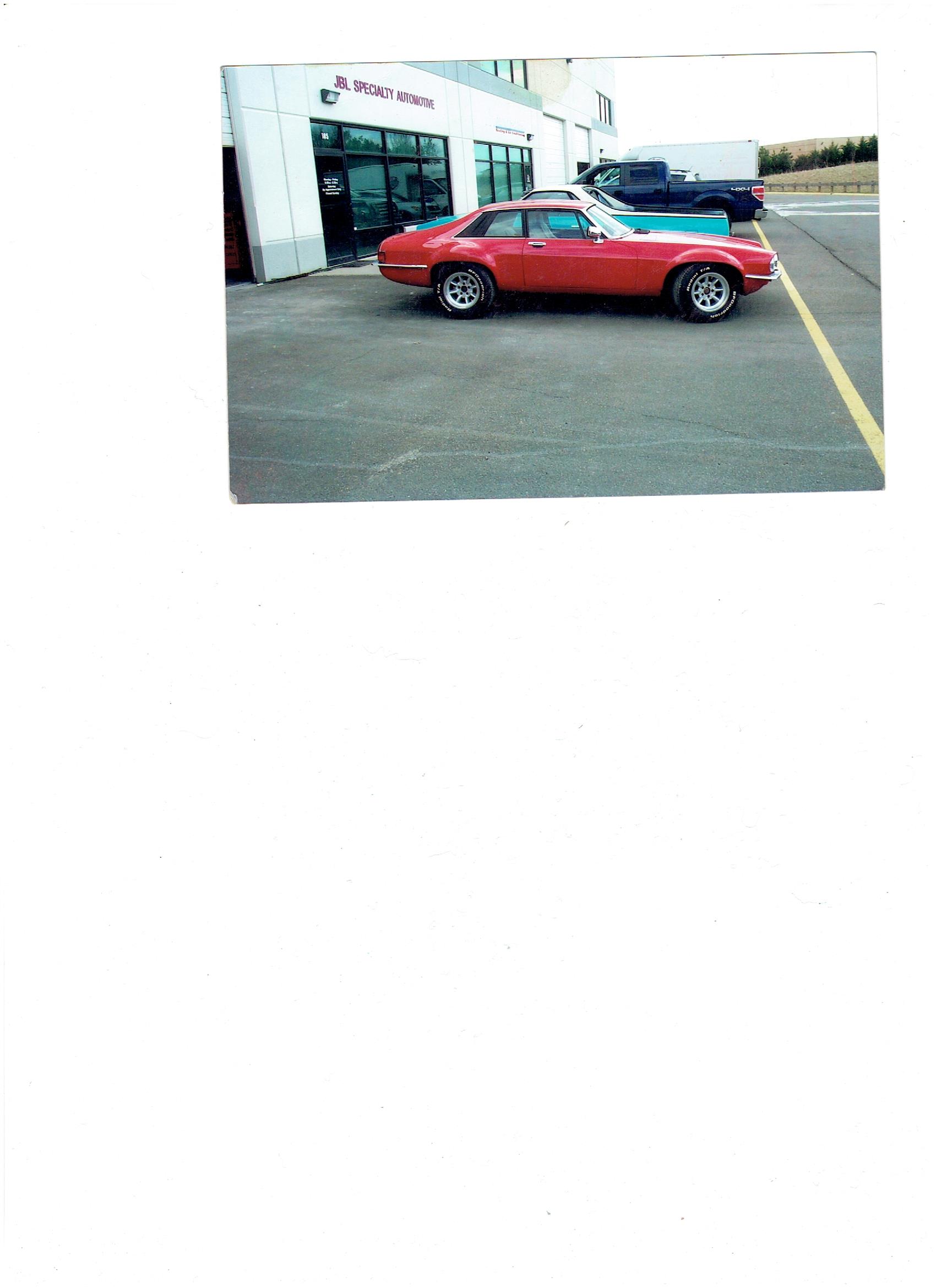

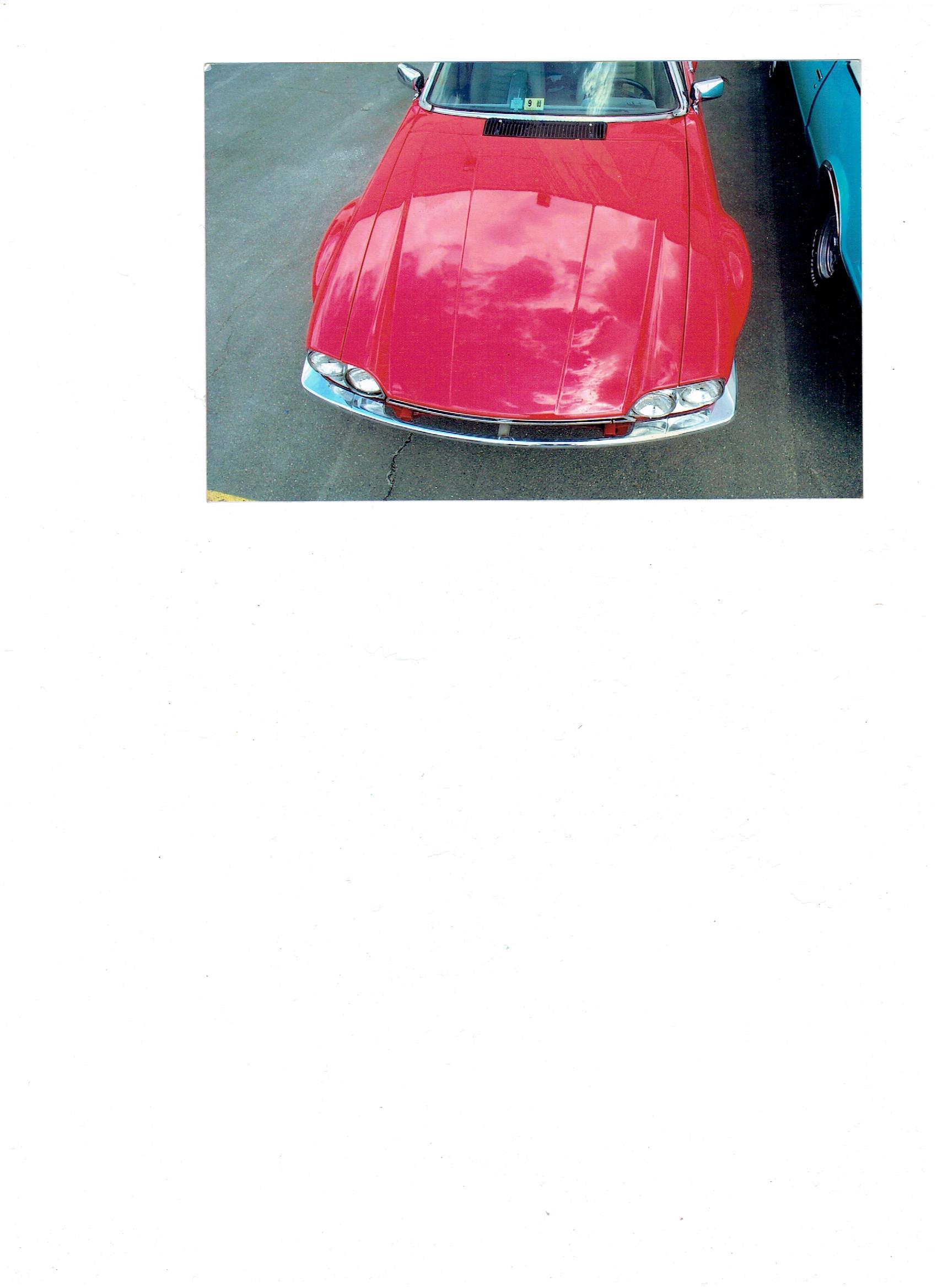

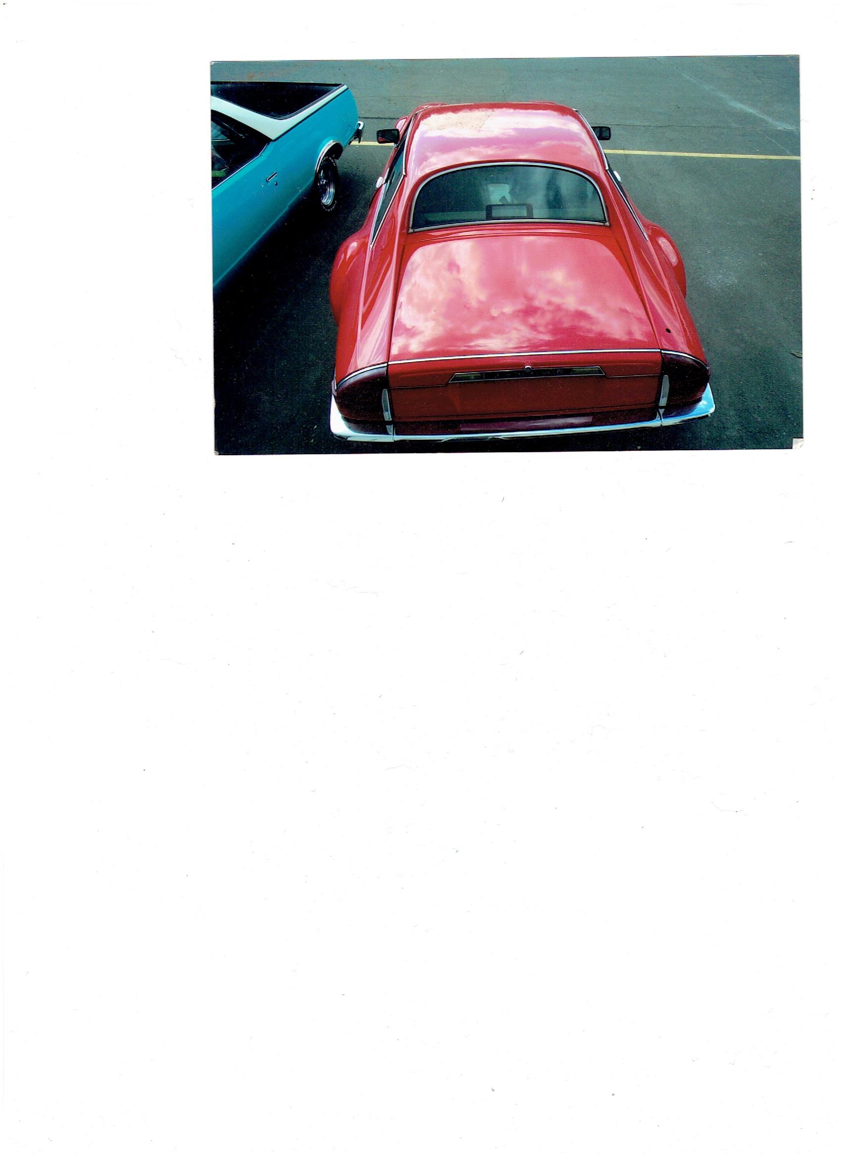

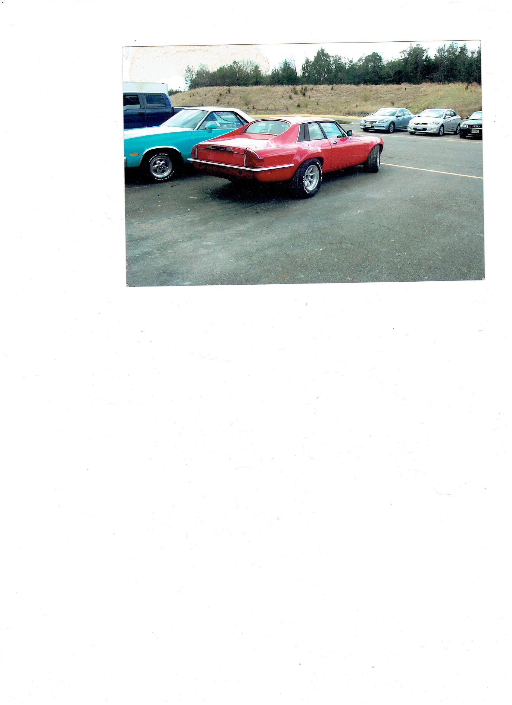

When I was 28 years old I was hired as the bodyman for Group 44.I did the body mods for the XJS and TR-8. I always wanted a XJS with our fender flares but the molds are long gone so I decided to replicate them. These are the flares that were on the car when we first raced it. The molds are done and I am making a set of flares now. The plans for my car are fuel injected v12 with Richmond 6 speed and painted Group 44 colors with 10 inch minilite wheels.
Attached Thumbnails Group 44 xjs street clone-13881724713_c0f522dcd3_c.jpg   Group 44 xjs street clone-13881668415_a0f6f07957_c.jpg   Group 44 xjs street clone-13881673685_8e860e019b_c.jpg   Group 44 xjs street clone-13881680295_0c90a2973a_c.jpg   Group 44 xjs street clone-13882072404_5d460140f1_c.jpg

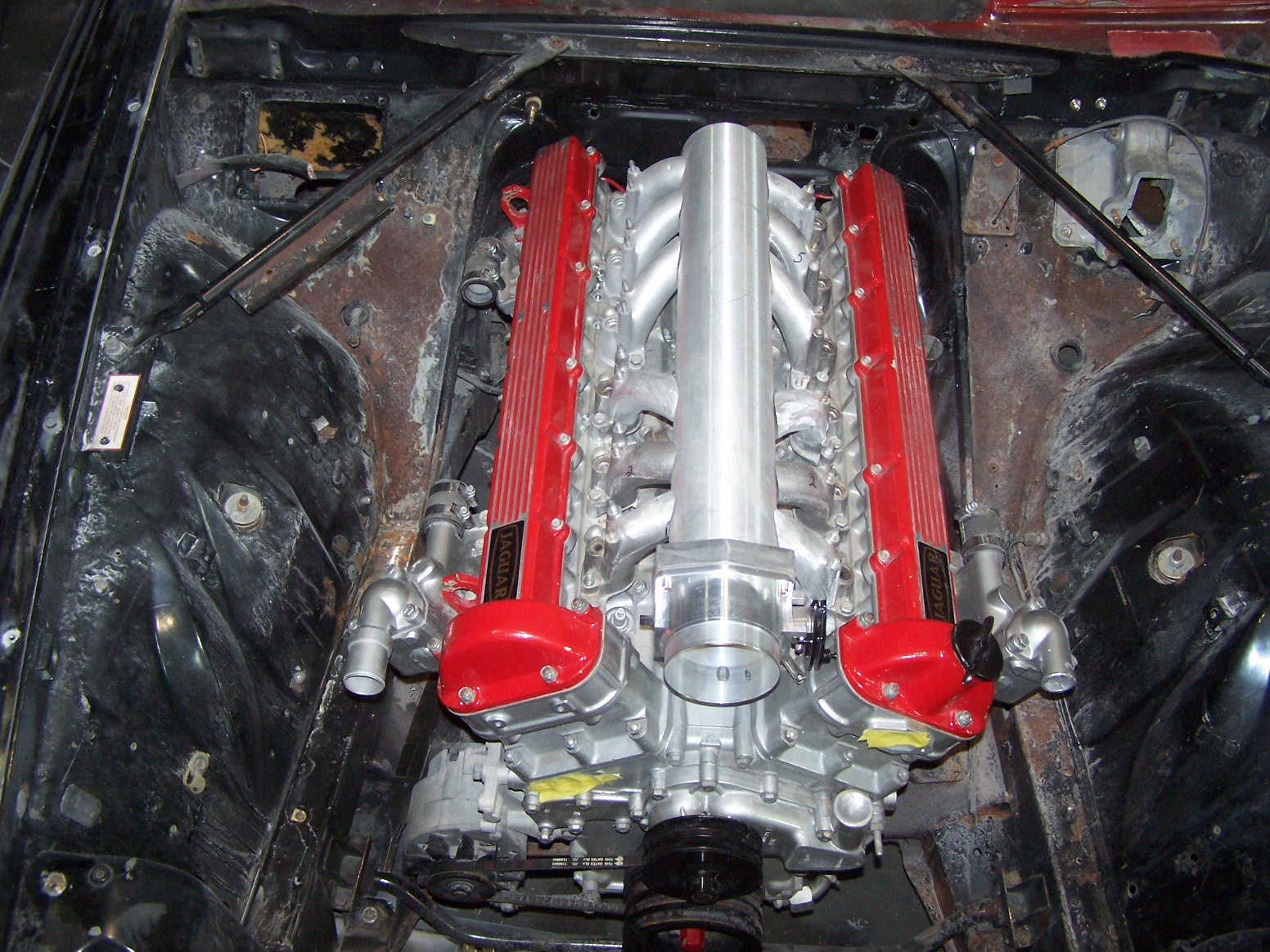

Popular Reply
Jun 26, 2015, 03:58 PM
JBL Specialty's Avatar
JBL Specialty
Posts: 29
Likes: 59
From: dulles va
This is the intake manifold I am making. The runners are from the factory intakes. They are on opposite sides now and will have fuel rails to the outside. I plan on using electrics from Electromotive. They are local and seem like good guys to work with. Thanks john
Attached Thumbnails Group 44 xjs street clone-100_5729.jpg   Group 44 xjs street clone-100_5728.jpg   Group 44 xjs street clone-100_5730.jpg   Group 44 xjs street clone-100_5731.jpg

I always wondered what the wheel wells would look like if Jaguar made them round, instead of that squared off opening that it is.
It looks like your Group 44 molds kept the square-ish shape. I would think with the larger bulges, the wells would be rounder...scratch that...round. The openings should just be plain round...like the wheel itself.
Any chance to show some pictures without the crazy filter on it. It makes it difficult to see...
Old Jun 19, 2015 | 01:52 PM
Posts: 29
Likes: 59
From: dulles va
The rules stated fender had to have factory wheel opening shape.
Old Jun 19, 2015 | 05:46 PM
melhookv12's Avatar
Joined: Feb 2015
Posts: 377
Likes: 91
From: Uk
I like that look. My XJS is similar.
It has fibre glass front wings but not bubble flares.

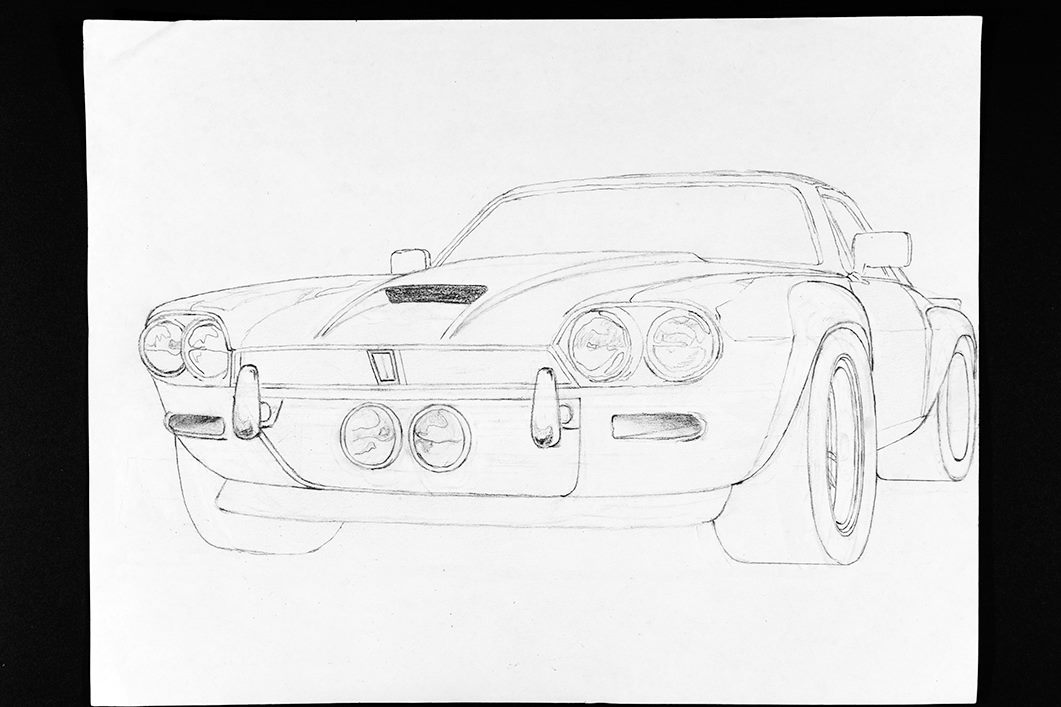

Welcome aboard, John.
It's great to have a new member who has been part of the greatest, and most historic XJS racing effort in North America. I REALLY liked the bodywork of the earlier racers. They looked very brutal, and menacing. However, I realize that airdams, and ground effects made the later racers faster.
The flares on your car look great. However, the red camouflages them somewhat, and makes them seem a little smaller than the ones you made for the early racers. Are they actually smaller (to better match the narrower street tires), or, is it just an optical illusion caused by the gloss red paint?
Your post says that you made new molds. Did you make molds of each entire fender, or, just of the flares themselves? I'm assuming they are fiberglass, or some other lightweight composite (CF?). Fully composite fenders would be a great weight savings, and, something I would definitely be interested in, although I don't know how you could attach full composite rear fenders to the car. Will you be offering them for sale?
My plans call for either Group44 type flares, or wide-body style fenders stretched over 18x10 inch fronts, and 19X13 inch rears. I also have a Richmond 6-speed installed in my car, and paired with a 3.54 rear. I think it's a vastly superior transmission to any of the Tremec 5 or 6-speeds out there.
Here is a rough 1st sketch of what I am planning for JagZilla. Although many of the fine details are absent from the sketch (such as the later Group44 style side pipes), I think it pretty well conveys the look and attitude I'm going for.
I hope to see many future posts from you.

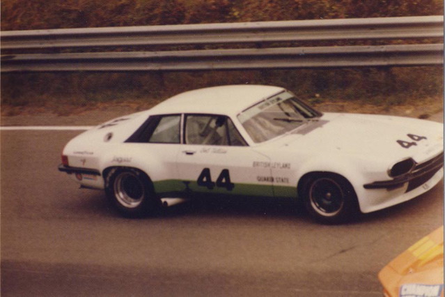

Old Jun 22, 2015 | 02:20 PM
Posts: 29
Likes: 59
From: dulles va
jagzilla your right my flares are smaller. There were two different fronts and 3 different rear flares. Mine are the first design. I put in a couple of more pictures of my car and Groups car. The silver car has the second type flares. you can see they are flared in the front of the wheels. The first type we made were not. The silver car was a rebuilt total that had flipped end over end and burned under the hood. We took it to two races to show it off and some guy bought it from Bob at the second race. It had two different red stripes but it doesn't show good in the picture. You have the same ratio trans as I do.

Old Jun 22, 2015 | 09:26 PM
JagZilla's Avatar
Posts: 835
Likes: 298
From: Mississippi
Thanks for those additional photos. Your flares look especially good in that side view, and in the photo looking down on the car from behind. I like your 1st version of the front flares better than the 2nd version on the silver car.
Thanks for clearing up the history behind that silver car. It would always show up when I would Google images of the Group44 XJSs. Although I could tell it was likely one of the group cars (your flares gave it away. lol), I didn't know what, if any role that car played in the team's history.

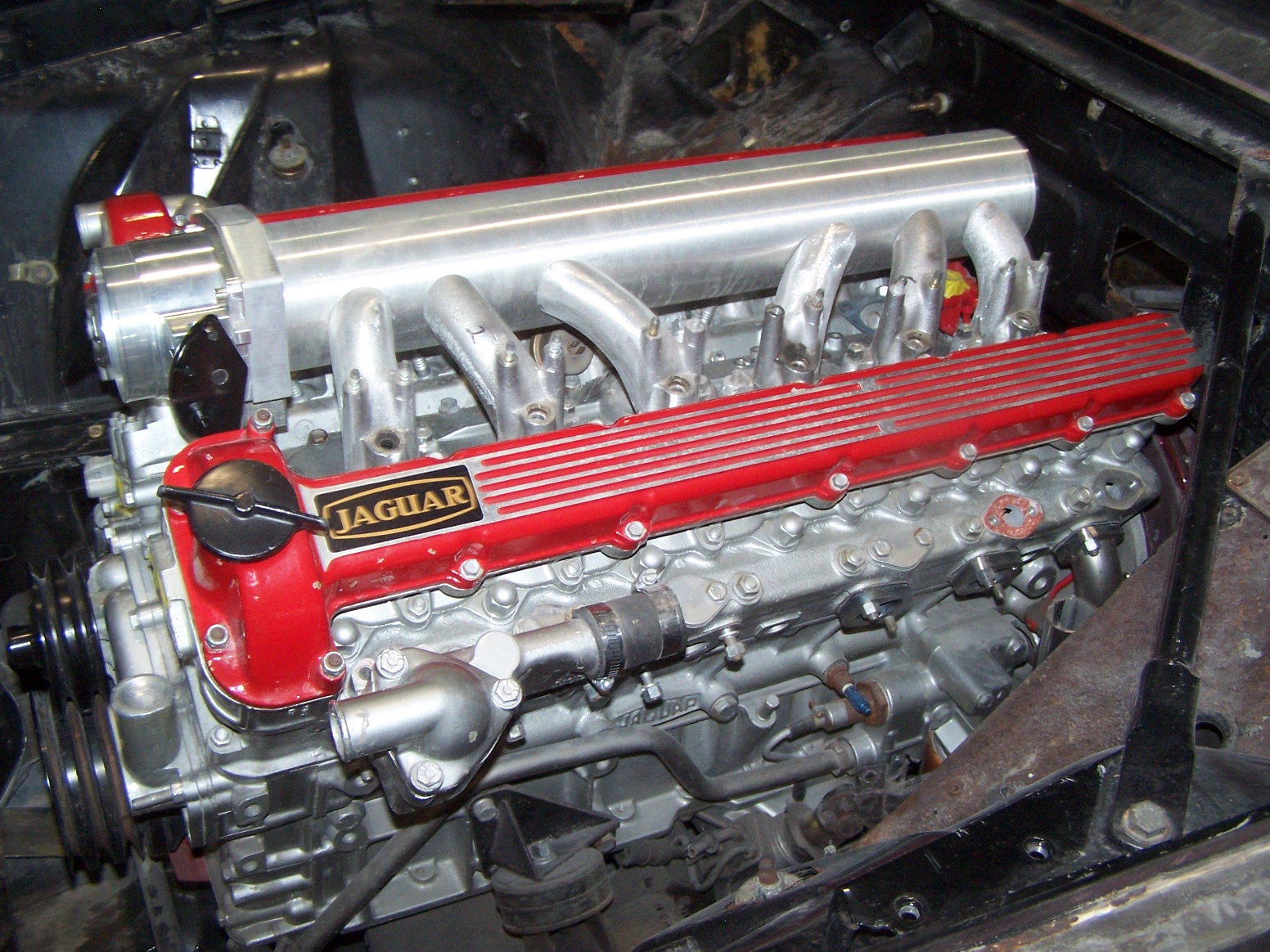

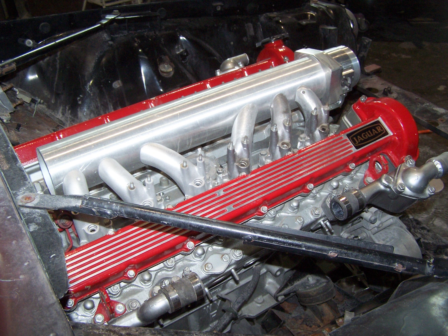

Old Jun 26, 2015 | 03:58 PM
Posts: 29
Likes: 59
From: dulles va
Attached Thumbnails Click image for larger version
ID:	114498   Click image for larger version
ID:	114499   Click image for larger version
ID:	114500   Click image for larger version
Old Jun 26, 2015 | 08:36 PM
JagZilla's Avatar
Posts: 835
Likes: 298
From: Mississippi
Looks good John. I can't tell from the angles of your photos, but, how hard, or, easy is it going to be to change plugs with that configuration?
Old Jun 27, 2015 | 08:26 AM
Katoh's Avatar
Posts: 422
Likes: 107
From: A.C.T
Your engine looks good! It's an interesting way you have put together the plenum, really thinking outside the box, do you think heat from the V could be an issue?. There was an interesting thread some months back about the plenum design and a way to achieve more power from it, but hats off to you, your design is totally different. It will be interesting to see what your Dyno results will come back as. JagZilla made an interesting point about the plugs, I take it also your going down the coil pack path and doing away with the Dizzy?
Love the thread so far, keep us posted on developments.
