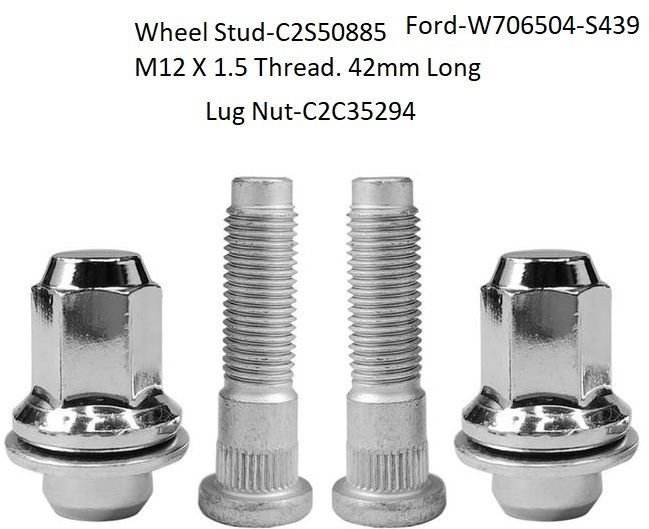

Since you have some broken wheel studs we did have a thread to find out exactly what wheel stud is needed. Turns out again a common Ford part is the exactly the same.
Thanks again to those who contributed to finding these numbers out!

[QUOTE=clubairth1;2915508]Since you have some broken wheel studs we did have a thread to find out exactly what wheel stud is needed. Turns out again a common Ford part is the exactly the same.
.[/QUOTE)
Thanks I've already purchased the parts. I have both the individual studs and a complete wheel hub assembly, so I'll be replacing either just the studs or the entire hub.
