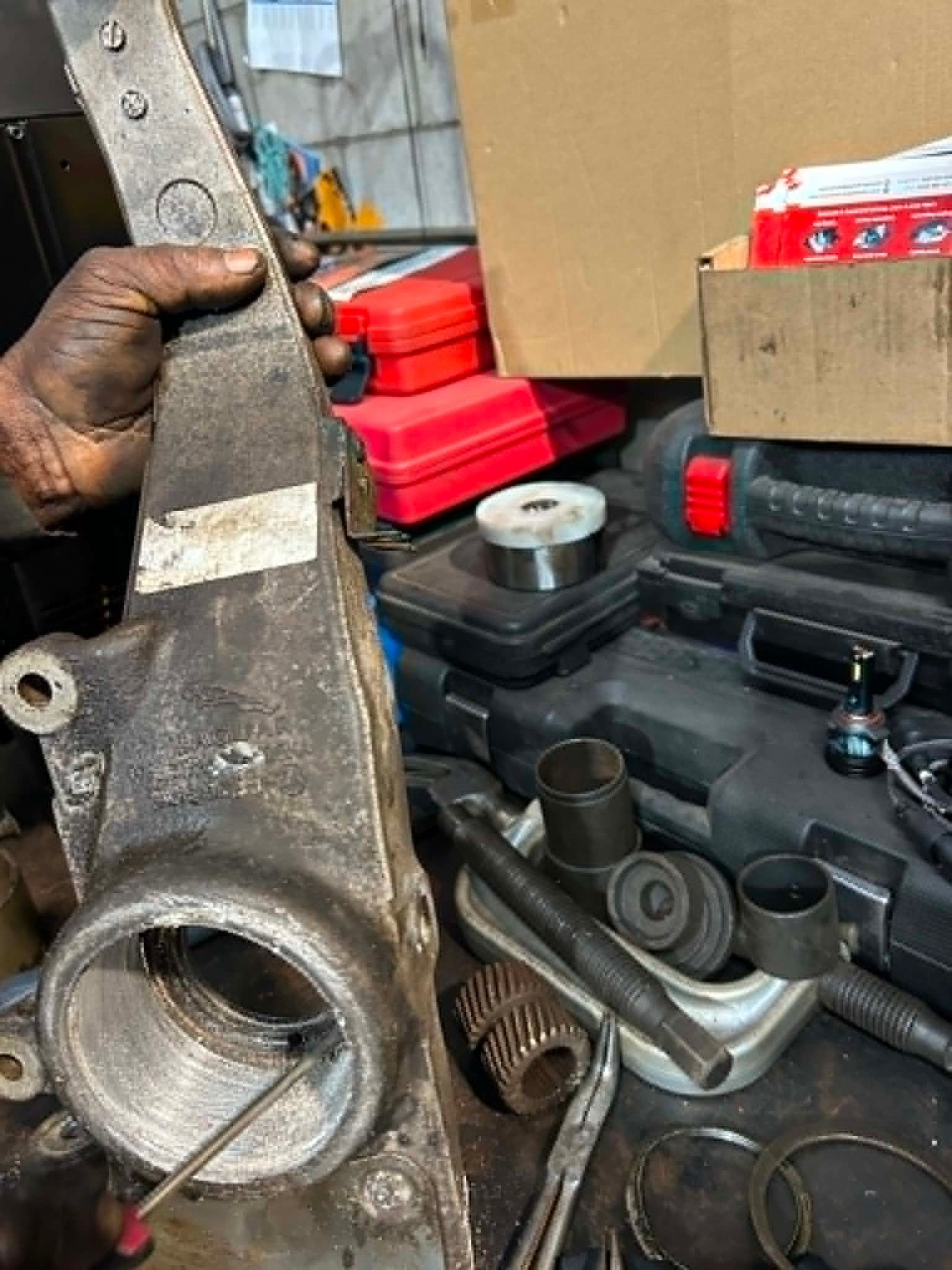

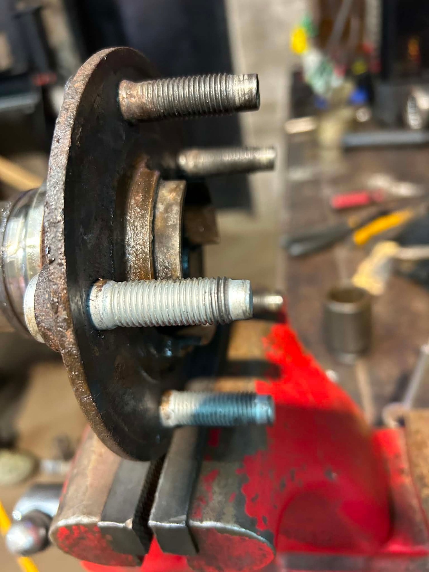

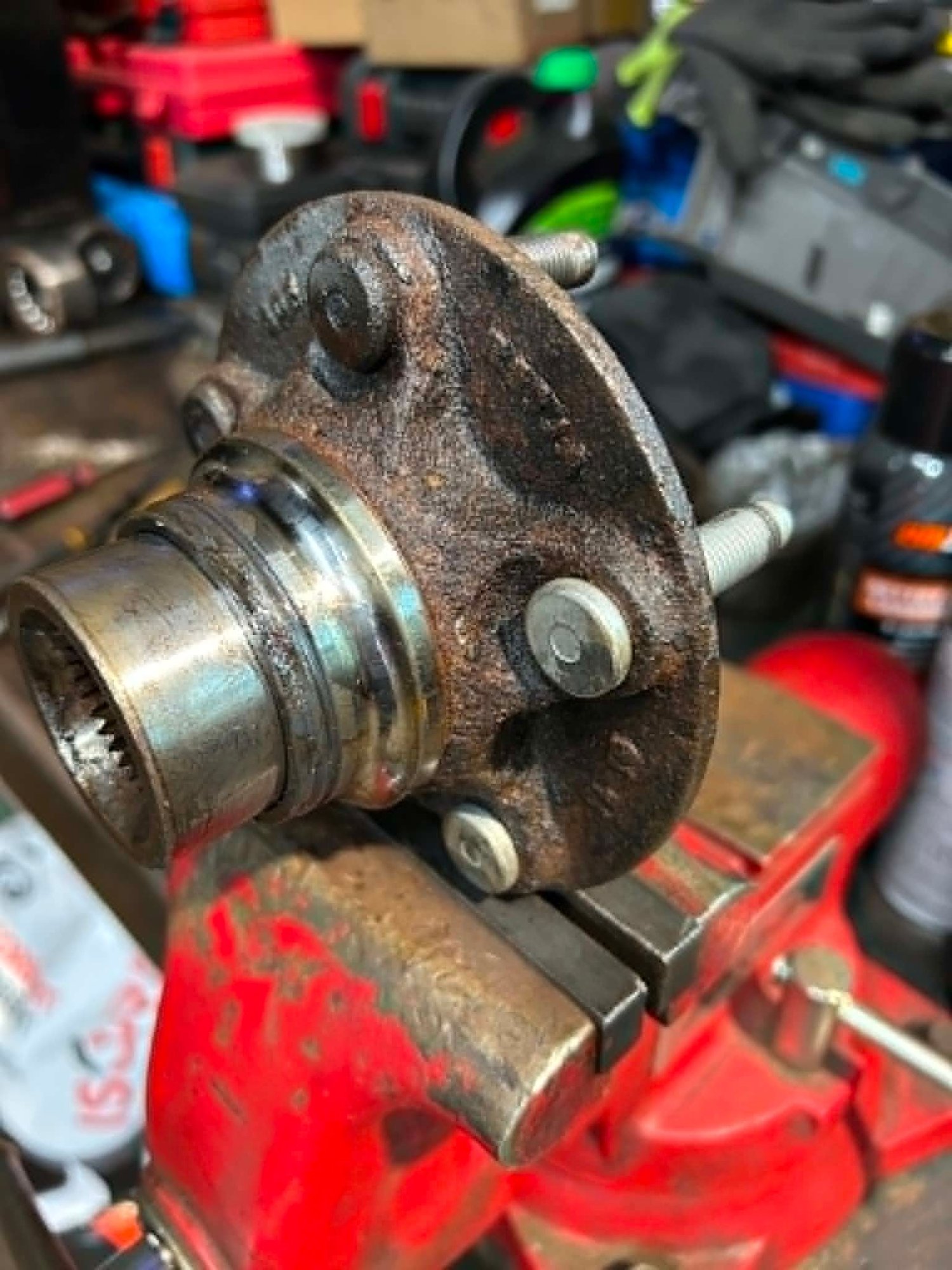

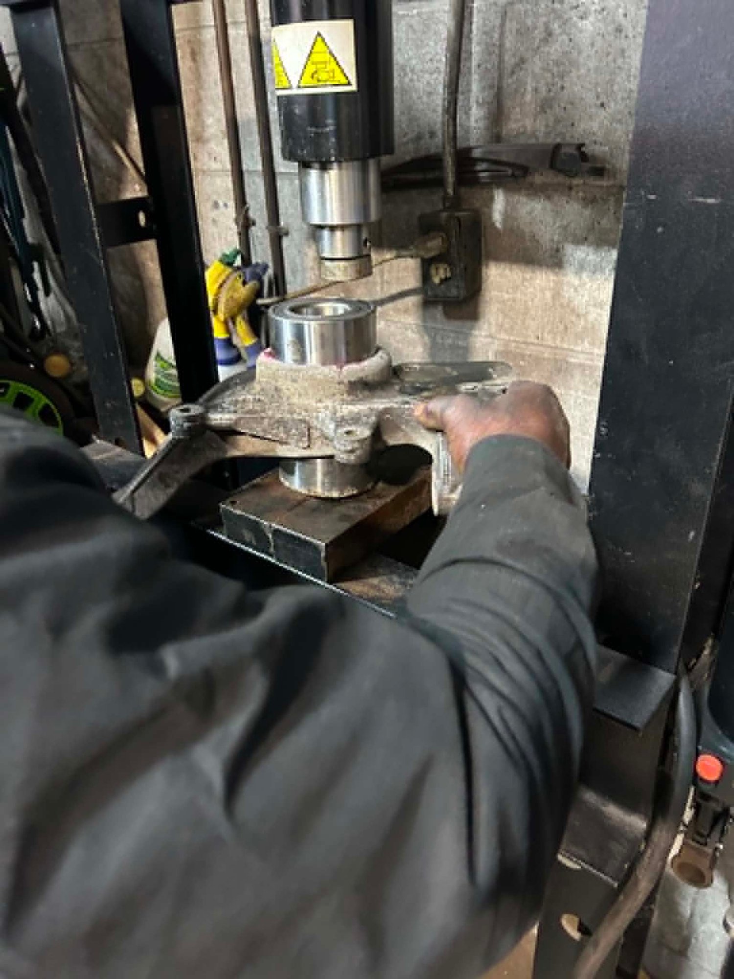

This is not a DIY job, it has to be taken to a shop. The only way to get the wheel hub and bearing out is with a press. You can try using hub puller tools all you want, but they won't work. The hub I bought from RockAuto wasn't the right size the front hub is a bit bigger so we just replaced the studs on the original hub. Why do you want to replace your hubs? You only need to replace the bearings, as the hubs themselves don't go bad. I bought my bearing from Amazon, but they are also sold on RockAuto. And once you remove the hub you have to replace the bearing because it gets damaged.
