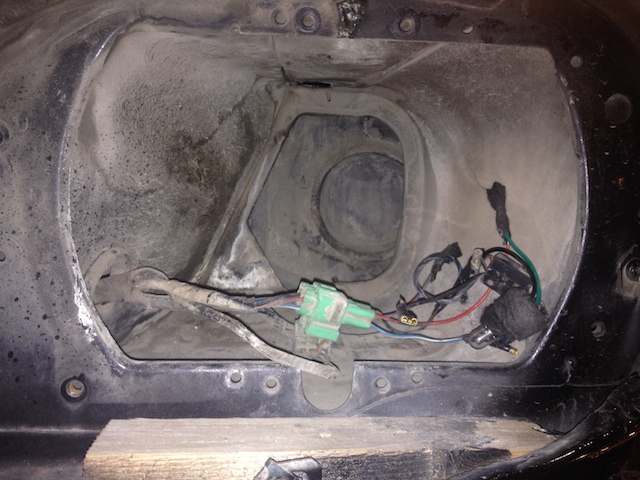

Hi again.
I had a go at the car yesterday and managed to strip both headlights, and they both seem originals, but totally different in structure.
The one with 2 bulbs has "Made in France" on it.
Obviously the previous owner had this adapted for him because now there is nothing holding the headlight except for the chrome bezel !!
The bracket to hold the headlight from behind is missing and so are the 2 adjusting cables that adjust height and sideway.
They placed a piece of wood under the glass on the inside of the body to keep the light at the same level as the other one. Some mechanics are really terrible.
I will attach some photos for everyone's amusement, with some comments when I get home.
But the thing is both sides do not have a wide light coverage, and more like a spot. Is this how Euro Lights normally behave?
I can understand the dim light due to the fading of the reflector, but it should still be fairly wide spread??
I will be quite happy to reinstall a good set of Euro type lights if the coverage is good.
Comments are welcome.

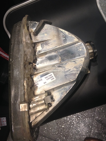

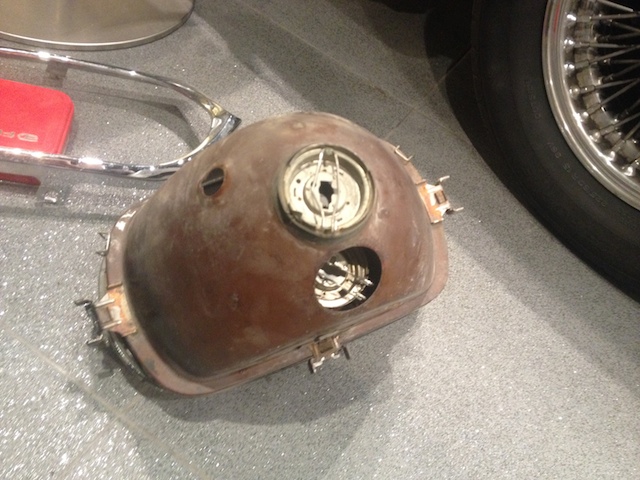

Thank you, good to know that. This means I will need to change both lights as you will see from the attached photos.
The "L" marked Photos are for the left side and the R for the right.
I believe the L type are the correct one and leave it to you Gurus to figure out where did the R light come about

OK, looks like the Photo letters did not come out. anyway the first set of photos are for the left side, now for the right side.
Attached Thumbnails Head Lights needed for 92 XJS-r-1.jpg   Head Lights needed for 92 XJS-r-2.jpg   Head Lights needed for 92 XJS-r-3.jpg   Head Lights needed for 92 XJS-r-4.jpg

Maybe the car had quad light system at birth(it is a cat). Of maybe one broke and he got one online and it was different and mickey moused it in.

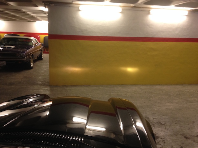

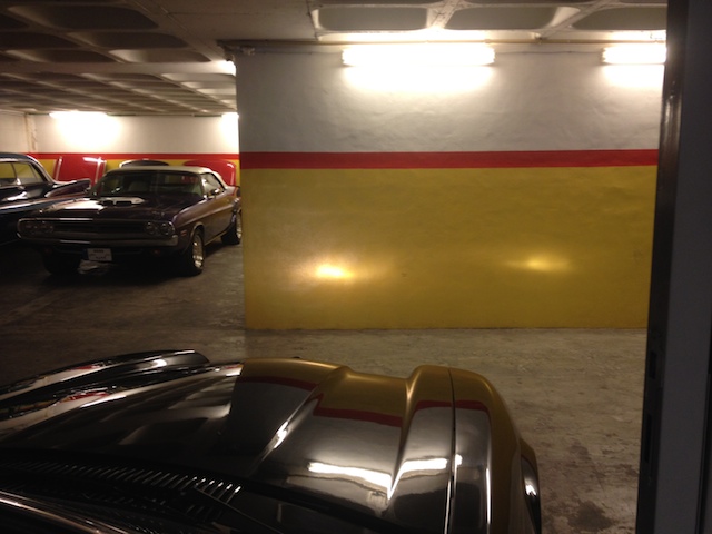

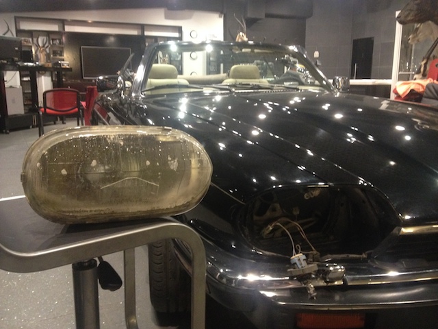

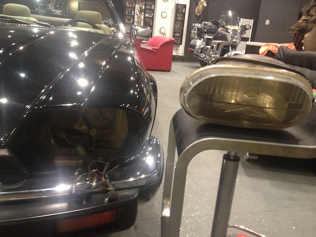

As you can see from the last photo, I am missing from the car the bracket that holds the light, and also missing the two adjusting cables.
Now to demonstrate what I mean about the lack of coverage, the following photos are of the low beam and hi beam lights, lit on my garage wall.
All contact are well and outside the enclosures the bulbs shine fine.
The one on the right is rated, I think, 65/100 W but cant really remember what I saw on it. But for sure I remember a high wattage.
On the left, there are 2 identical halogen bulbs of 55 W each, similar to the spot light bulbs.

Yep. Those lights suck. Im scrapping a 89 if you meed mounting hardware I can provide. Mine is prefacelift. I dont know if parts are the same. I also have the right headlight and Zi can see if its better if you are interested. PM me.
Old 10-17-2014, 06:15 PM
malc4d's Avatar
Join Date: May 2013
Location: Orlando
Posts: 1,583
Received 430 Likes on 374 Posts
WTF... are you saying that some idiot put 100w bulbs onto that Jag light circuit, and you didn't have a fire.......!!! It just about takes the 55/65w bulbs.
I would buy the quad light set up if l was you. better light and easy to get.
