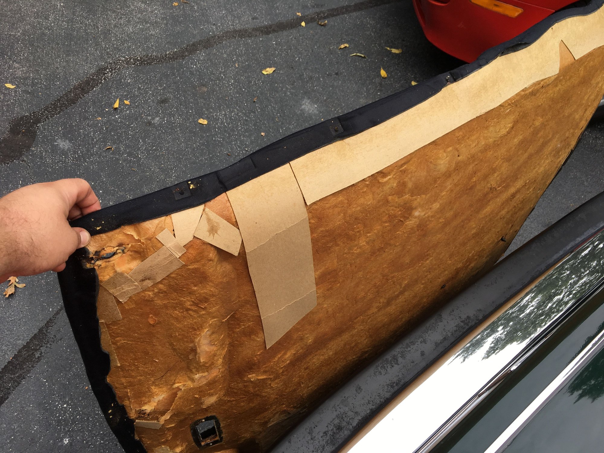

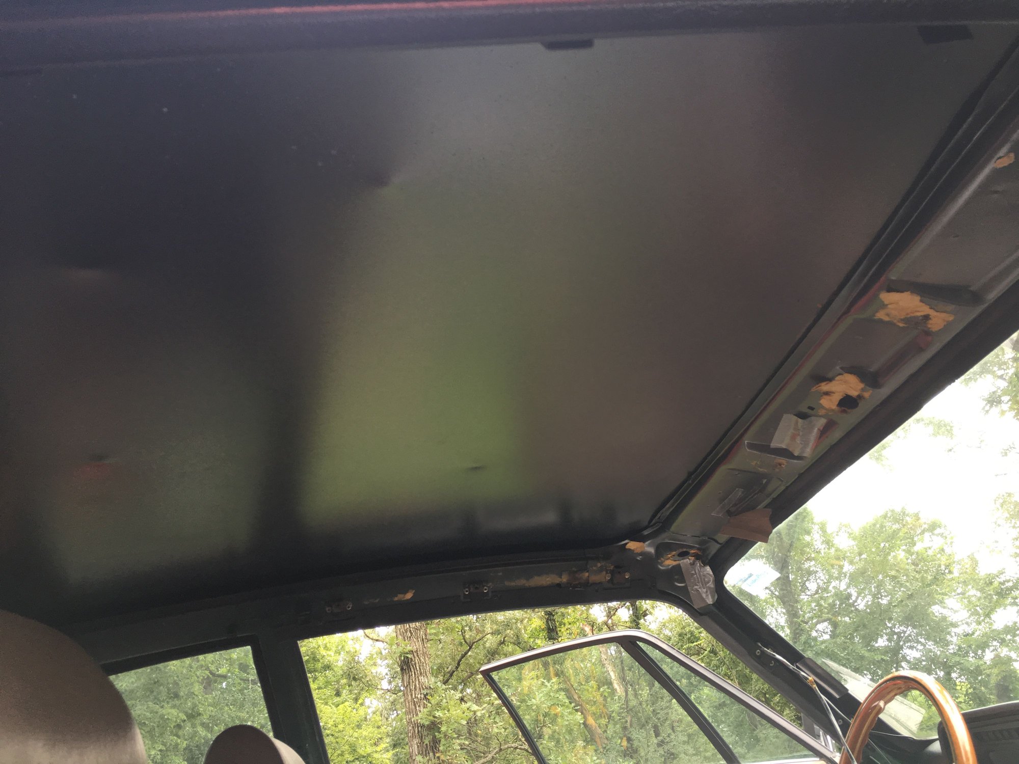

going to be replacing the headliner with some new quilted material ala Ferrari style. Hopefully it works out. After getting the board out though Im almost tempted to just glue the material to the roof of the car. I actually had headroom! Has anyone ever gone that route?

i went for a drive without the headliner and noticed no noticed no difference in sound...

Gluing to the roof the car would be a disaster using regular headliner. Headliner usually fails between the material and foam where the factory glued it, not where it was actually glued to the board. So this would eventually go bad and removal would involve scraping all the foam from the roof on the inside and have it go all over the interior. If you just used a quilted leather or vinyl, the car would be a lot louder inside and gain difficult to undo/repair.
More significantly the board provides shape in different areas. The fit and finish of the mirrors, lights, and sun visors will look bad, and you will have glued over wiring going to the rear. You are also talking about spraying glue down onto the material and then trying to hold it above you and place it on the roof in the proper place, without it falling, while you are blanketed with it, trying to make it conform to all the sheet metal without looking like material over sheetmetal. I would really just go with the factory board and do any repairs necessary to it.

Im going to use the headliner board. Im using quilted vinyl and hope it turns out good. Im tempted to just adhere it to the roof but Im guessing it just wont look good without some real work.

i was able to get it out without damage but it fell apart putting it back in. So plan b... Im adhering it to the roof, and so far looks just fine and gives me more headroom.

Still need to bolt the sun visors in but Im done. Total pain in the **** job! And still not perfect because I never even thought about the trim pieces that I have are the automatic seatbelt pieces. So that looks a bit odd from some angles.
