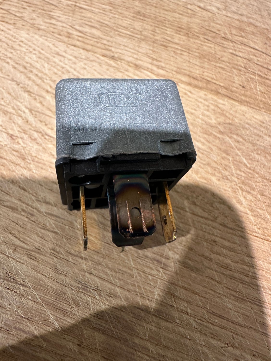

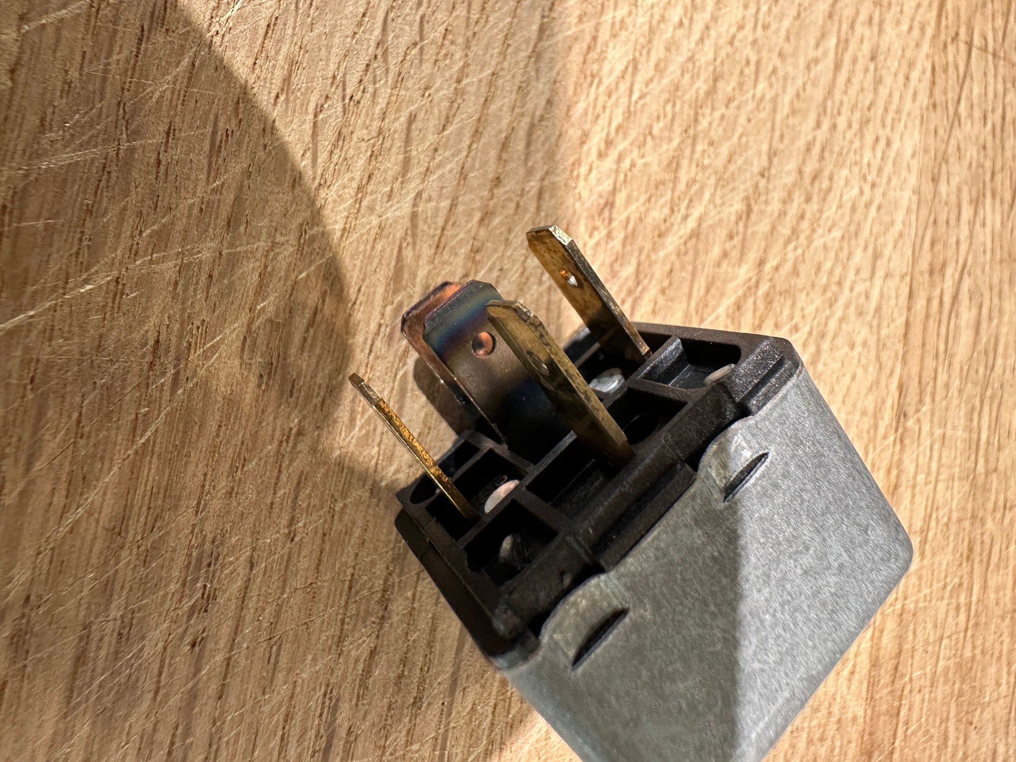

Hi all. Just started pulling it apart and have just pulled one of the relays. This one doesn’t have the red stripe so I assume it’s the fuel pump relay. Red stripe is the main really? What you guys think it looks like it’s been getting hot judging by those spades.

Hi Robbo
Looks like that Fuel Pump Relay in the Black Holder (without the Stripe) could be the cause of the problem

Would replacing the main relay be a good idea as well as it’s the original in there.

Rob,
You might do it as preventative maintenance but I can't see how it could be the cause of your problem.
Also, whilst your fuel pump relay may be failing, the symptoms don't feel to me like it's a fuel pump issue, as I would expect you to be hearing strange fuel pump noises if it somehow it can't handle the wide throttle load. But, hey, what do I know!

Hi Paul. I was thinking for preventative maintenance as it’s still on the original relay. I have pulled it and all the pins look fine. Just the fuel really been getting hot then and looking at the two pins very hot to discolour them like that.
Rob

If the relay contacts look like that, the socket contacts will be just as bad or worse. Use Deoxit or other electrical contact cleaner to attempt to clean them. It may be best to replace the socket as well.
The two relays are different inside. Be sure to get the correct ones.

As Relays are quite inexpensive, you may as well change both, as the Fuel Pump Relay won't work unless the Main Relay is working as well
The Fuel Pump Relay was the cause of the No Start problem on my XJS 4.0L and so it looks like that could be the problem on your Car as well
The Main Relay with the Red Stripe has a Diode that protects the ECU if someone were to hook the Battery up wrong (or something like that!)
Main Relay and Fuel Pump Relay are not interchangeable
