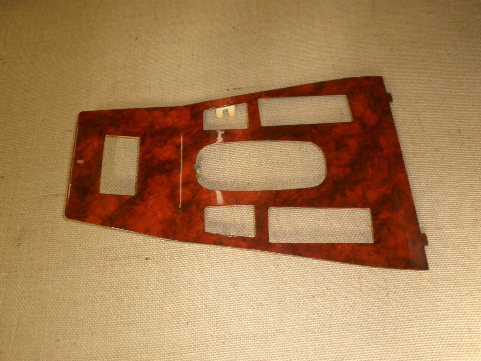

Not my picture, but is this the part you're trying to get off?

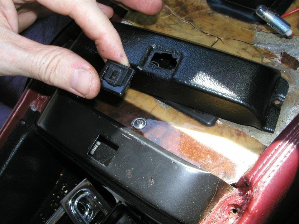

Still not my picture but what we're saying is this screw won't come out?
Old May 24, 2022 | 12:54 PM
JaguarDon's Avatar
Joined: Apr 2022
Posts: 76
Likes: 11
Yes, that is the part I am trying to get out Thorsen. It just will not budge. I cant even get the plastic up enough to see the screw. I am just afraid od breaking the plastic cover.
Old May 24, 2022 | 12:58 PM
Thorsen's Avatar
Joined: Aug 2017
Posts: 1,595
Likes: 2,841
From: Chicago
To get the female latch out, I used two plastic trim removal tools as prybars. I honestly thought I was going to break something, but the female latch popped free.

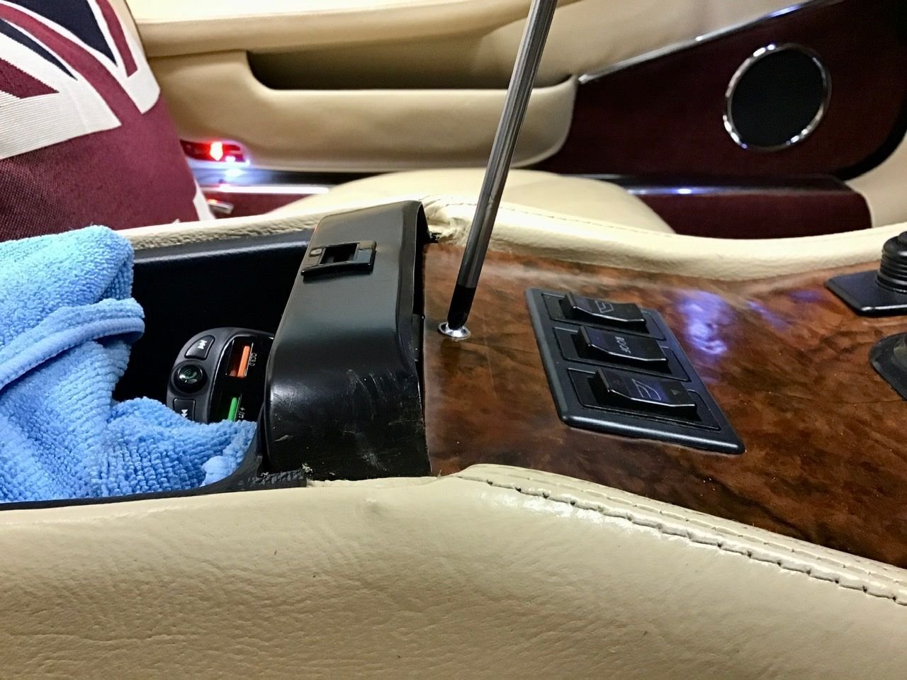

Even if you take out the actual latch I don’t think you will get a screw driver on the screw. Just taken a picture of mine with a screwdriver in the screw so you can see the angle needed to undo.

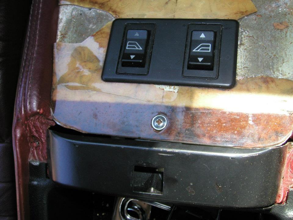

Originally Posted by orangeblossom
Hi Robbo
Yes!
I knew it was something likw that, so lets hope this works for Jaguar Don
Yep here's another picture with the side tabs that have screws to the sides of the console.
