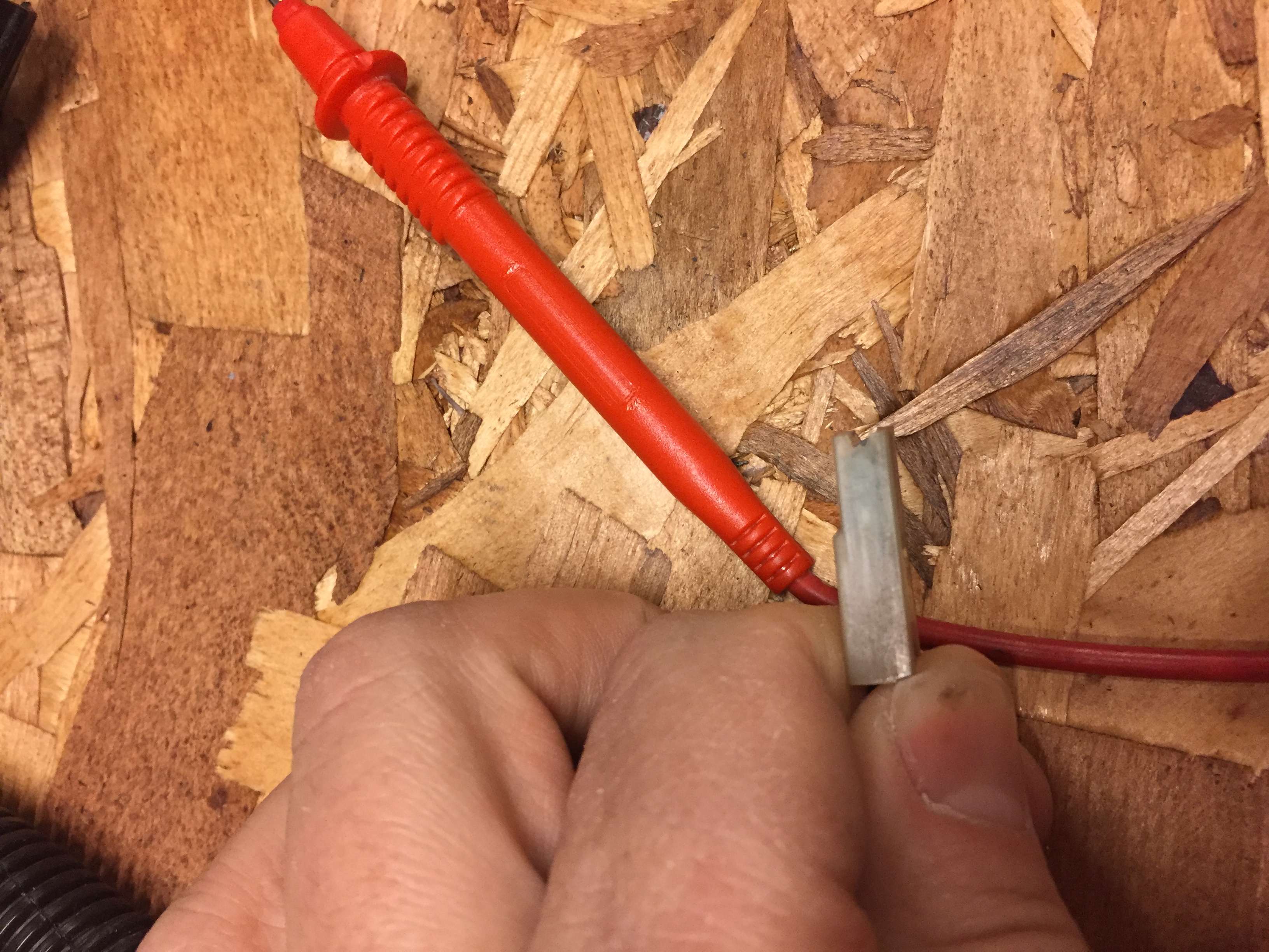

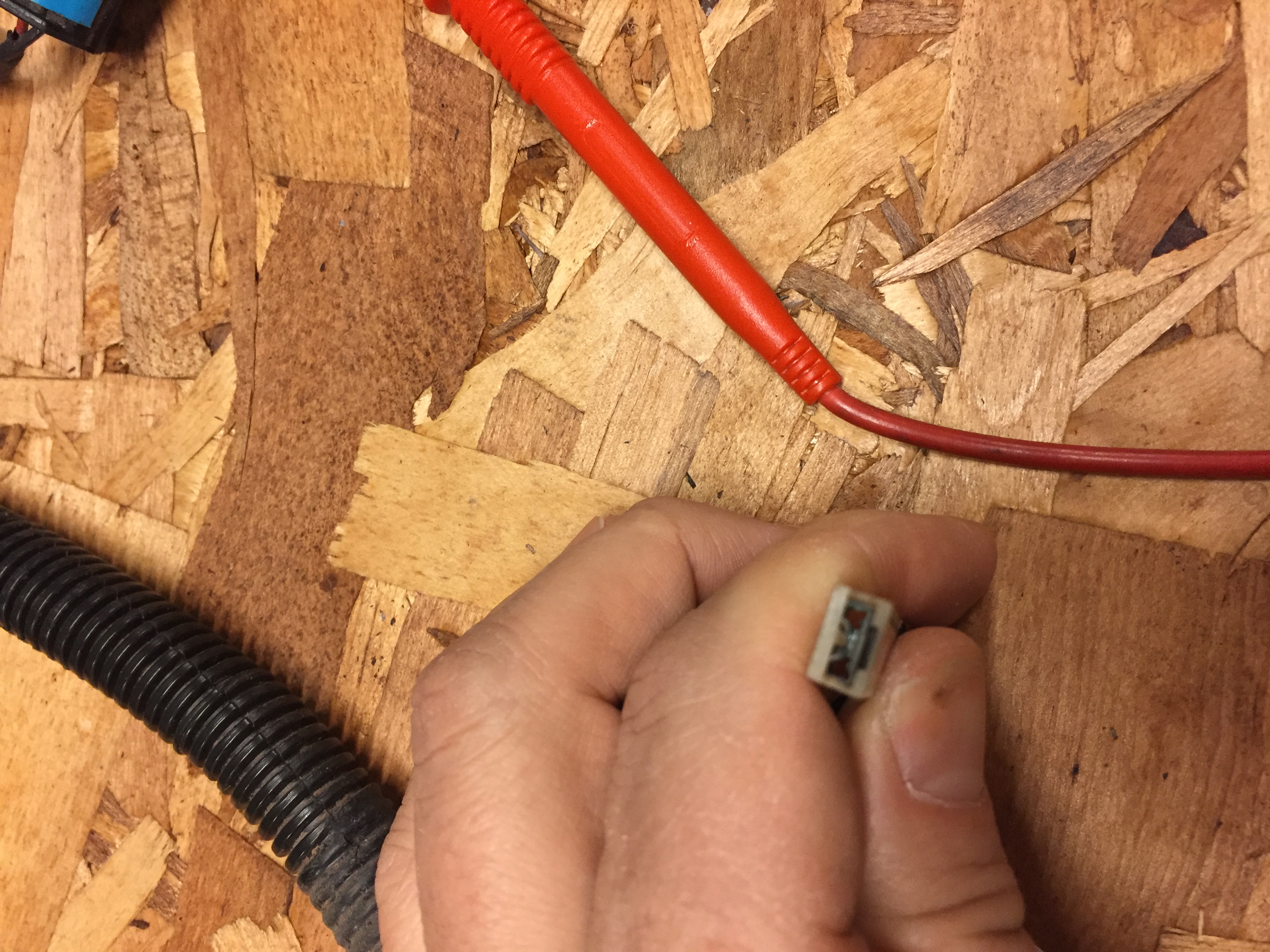

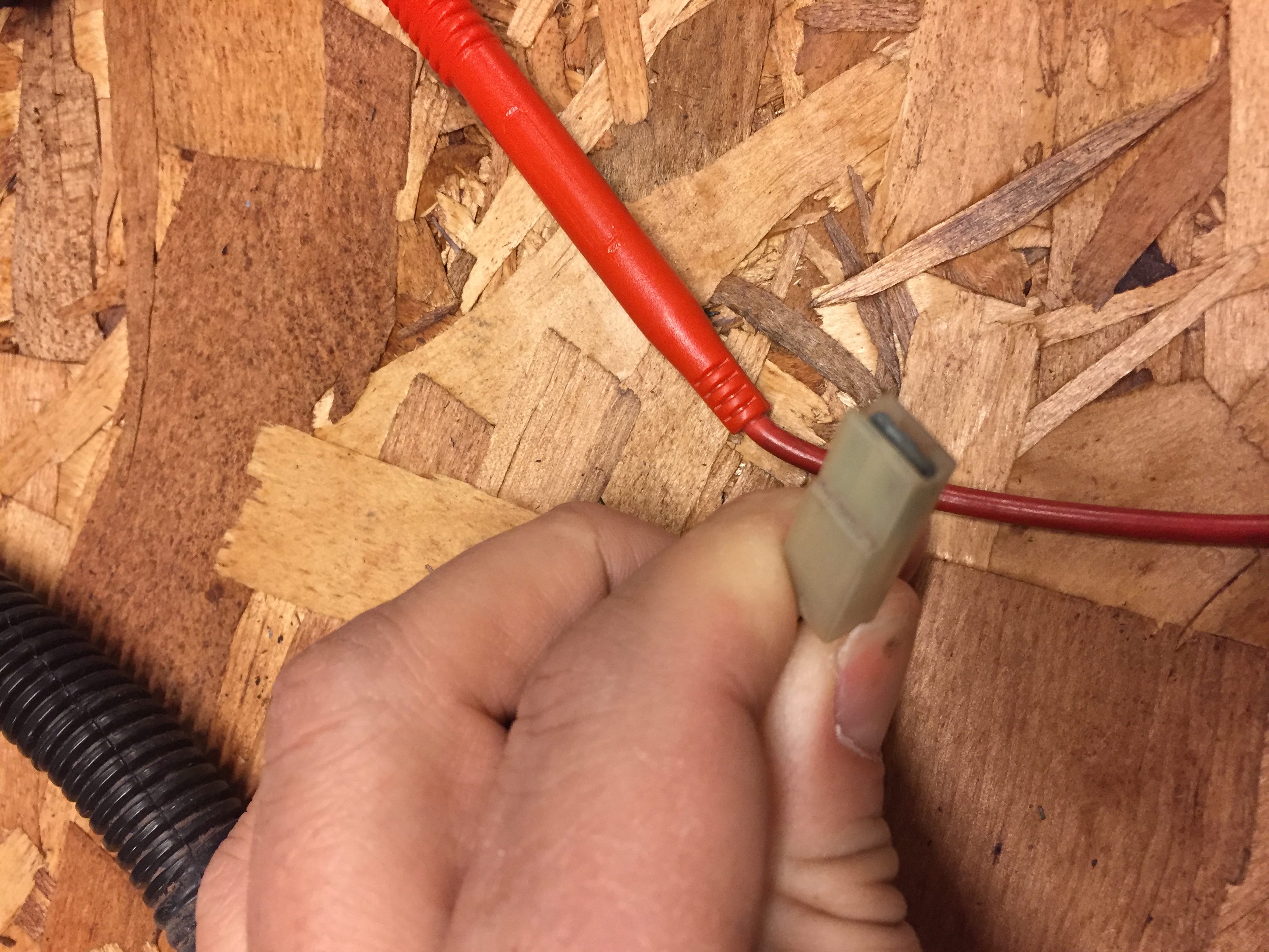

Can anyone help me track down the part number for these connectors? They are part of the engine/fuel injection harness I am rebuilding. Instead of reusing the old connectors, I am tracking down the part numbers for all of the connectors so it's all new.
I will share all part numbers once I've finished compiling them. I'm almost done. Next step is measuring all wires, then placing the order, then the fun begins!

That is a normal 1/4 inch Lucar push on female connector. It has a solid insulator round it, but a normal insulated one available freely will work fine. eg

If you want to duplicate what you have....or come very close.... click here and scroll down to "1/4 inch Rigid Terminal Cover"

I happened to find it and when I came back to post my success, Doug had found it too! It's actually the one on the very bottom, the Posilok.
Here is where I found mine...but in the UK. Your place will be much easier to order from.
https://www.simtekuk.co.uk/product.p.../?k=:::1605315
