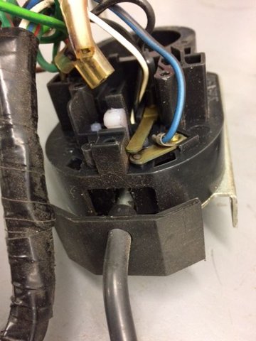

The stalk switch closes a ground path to trigger the relay. At the base of the stalk you should see the ground contact....which should also be cleaned. You'll have to remove (at least) the lower column shroud. The picture shows the contact. I've seen a couple different styles of contact but it should be easily recognizable to you
