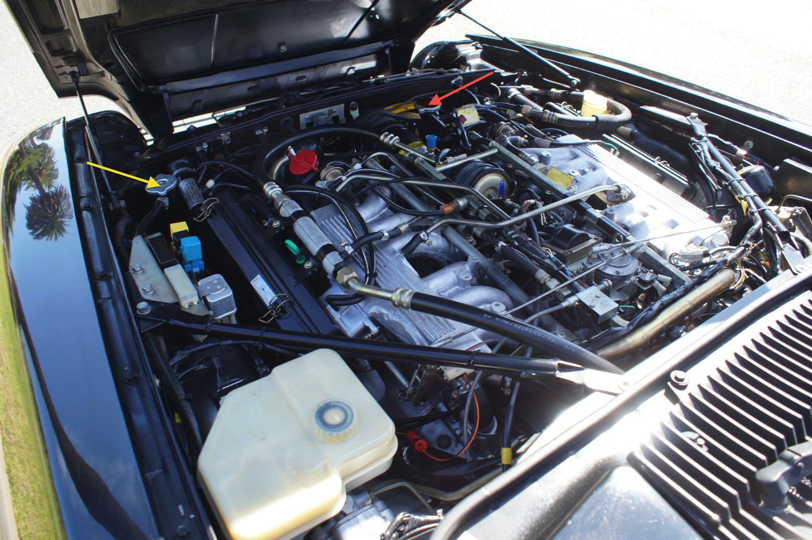

Here is a pic of the engine bay of a 90 V12, hopefully yours is the same
I have marked the two caps with arrows. You would use the one marked by the red arrow to fill up the coolant levels. (I believe that is the one you looked down?)
The cap marked in yellow is for the expansion tank that Grant was talking about. Don't open both caps at the same time as coolant will run out of the expansion tank spout. (Assuming there is coolant in the system )

Yup - I looked down the wrong one :-). MANY thanks - that is a cleaner looking version of my engine exactly. Now, one more question...I DO need to open both up to add fluid, correct, so that I can make sure not to add too much? THANK YOU all so much!
Not necessarily, if you first open the expansion tank cap and it is full then you probably just need to top up as per your handbook. (I actually think this is probably what you will find )
If you don't see coolant (bad) then yes take off both caps and pour coolant in the filler until it comes out of the expansion tank spout. If this is the case then it is likely that you will need to bleed the system to get trapped air out.
