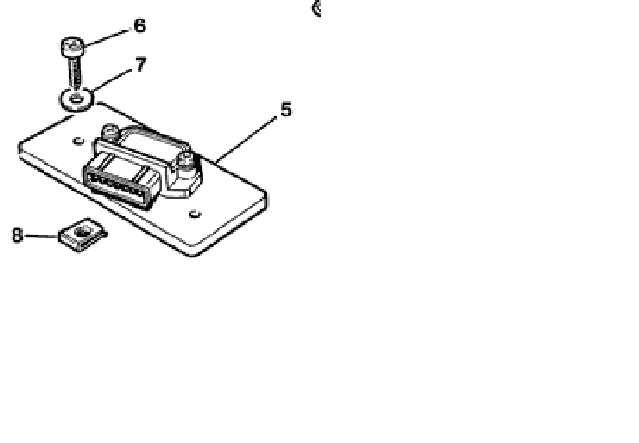

There should be thermal paste between the aluminium heat sink (5) and the module itself but I do not recall any paste between the heat sink and the top radiator panel. Paste should be available at most computer/electronics stores.
Hi Baxtor
That is interesting
I'm just starting to wonder if the Aluminium Heat sink that you mentioned, is already attached to the Ignition Modules?
Can you tell from the Photo?

baxtor's Avatar
Joined: Jun 2013
Posts: 2,132
Likes: 1,389
From: Australia
Hi Baxtor
That is interesting
That is only the module in your pic. The heat sink is somewhat larger than the module and a simple rectangle. There are traces of paste in that pic so maybe the heat sinks are still attached to radiator panel. Module attaches to heat sink with machine screws and then heating attaches to panel with self tappers into speed nuts.
Hi Baxtor
You Nailed It!
I've got Two closing panels one of which I could not find up until just now, buried under Jag Spares in the Shed.
Since this Car has been out of action for the best part of 17 years, I mistakenly thought both Panels were the same. (but they are not)
The one that I was trying to fit was from a 'Lucas Car' that doesn't have that type of ignition module.
Unlike the one that I just found that has Two big Aluminium Heat Sinks attached by those screws you mentioned.
And you were also right about the Residue of the Thermal Paste on the Ignition Modules.
The Rad has also turned up now, so progress can be made.
Thanks for your help.
OB
