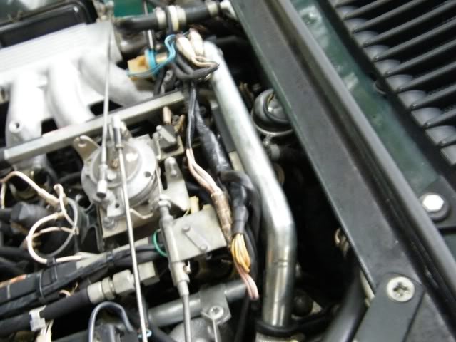

First remove the zip ties holding the wires onto the balance pipe.

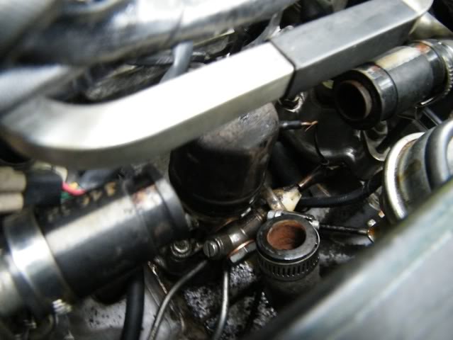

Then loosen the clamp on the back of the balance pipe and remove hose. Name:  DSCF1476small.jpg

Loosen the 2 clamps on the ends of the balance pipe and remove it.

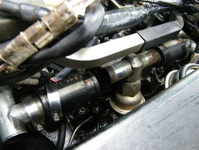

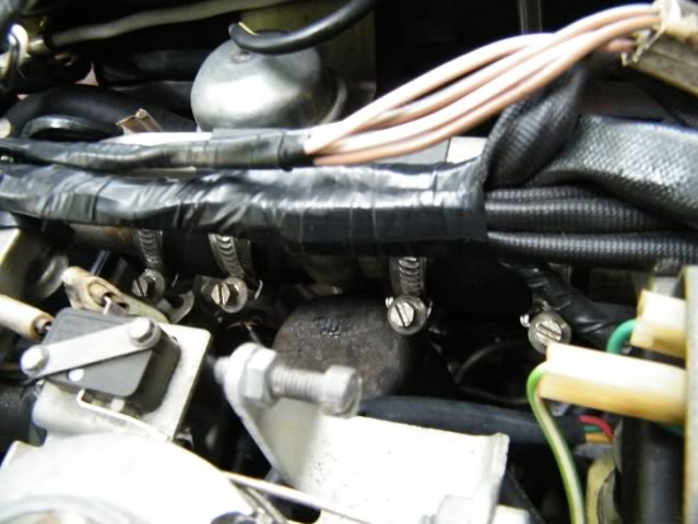

Next loosen the 4 clamps on the 2 hoses connecting to the top of the check valve and slide them back towards the sides of the car. Slide the 2 hoses along with them towards the fenders and off of the top of the check valve. I loosened the hoses with a screwdriver, it took some convincing to slide them.

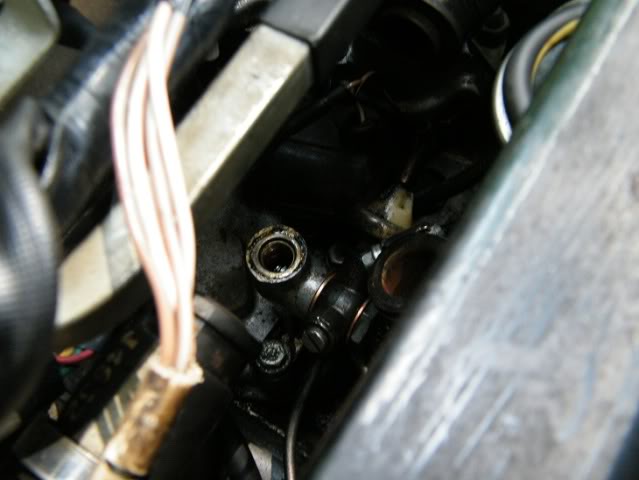

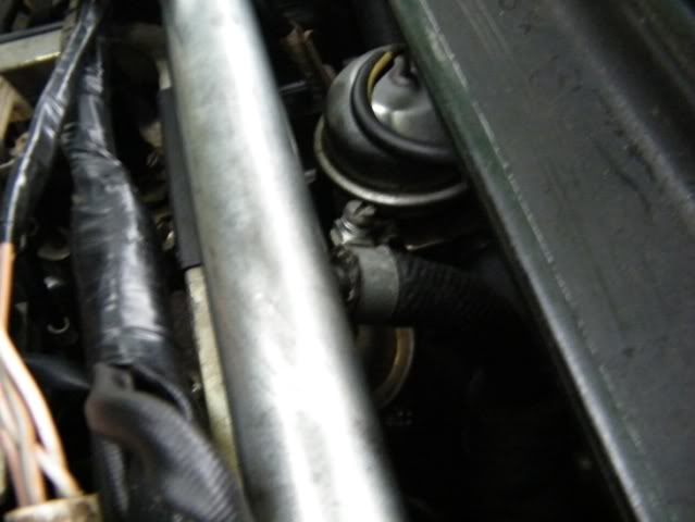

Loosen the clamp on the bottom of the check valve and remove it.

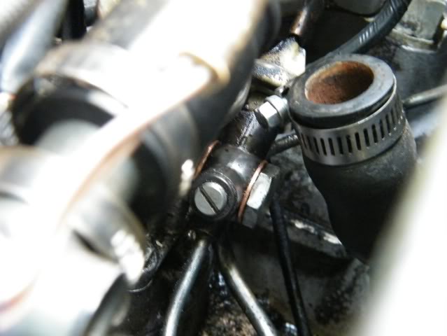

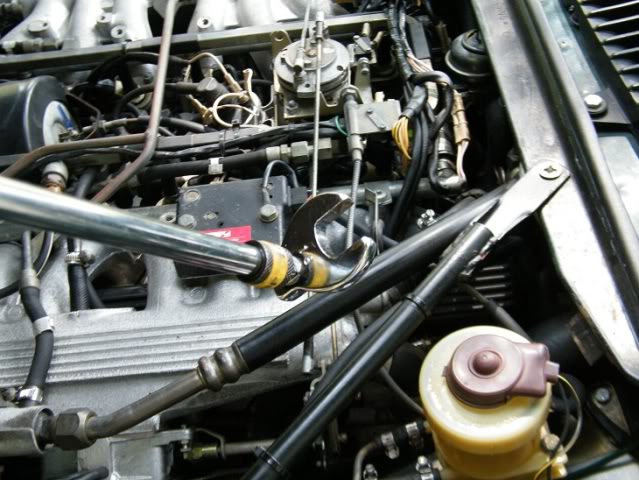

Depending on what you are doing use the 3/4 wrench to remove the banjo. I didn't think to take pics until I already replaced mine, blew out the sending unit and had to come back to do it as well. You may have to push the hose leading to the bottom of the check valve towards the firewall some to get the bolt out. Obviously don't overtighten it. The housing is aluminum. oops i mean "aluminium".

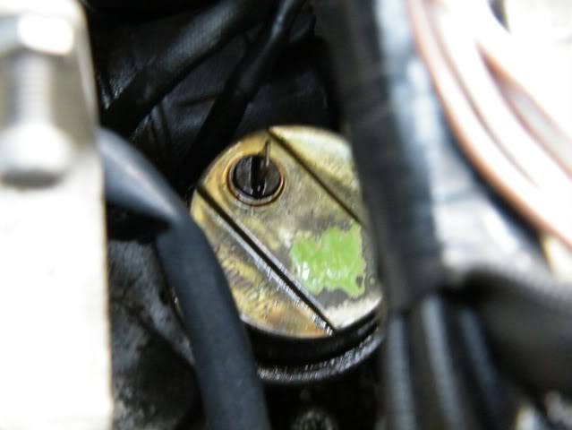

Remove the rubber boot from the sending unit and unplug it. Put the crows foot on it and remove. Thread up the new one and you should be good to go. again don't overtighten, just use your brain. Its gotta be enough to seal the copper washer, but not too much. I usually put the flat side of the washer with the edge on the part going on because if it makes an impression or cuts it can always be replaced.
