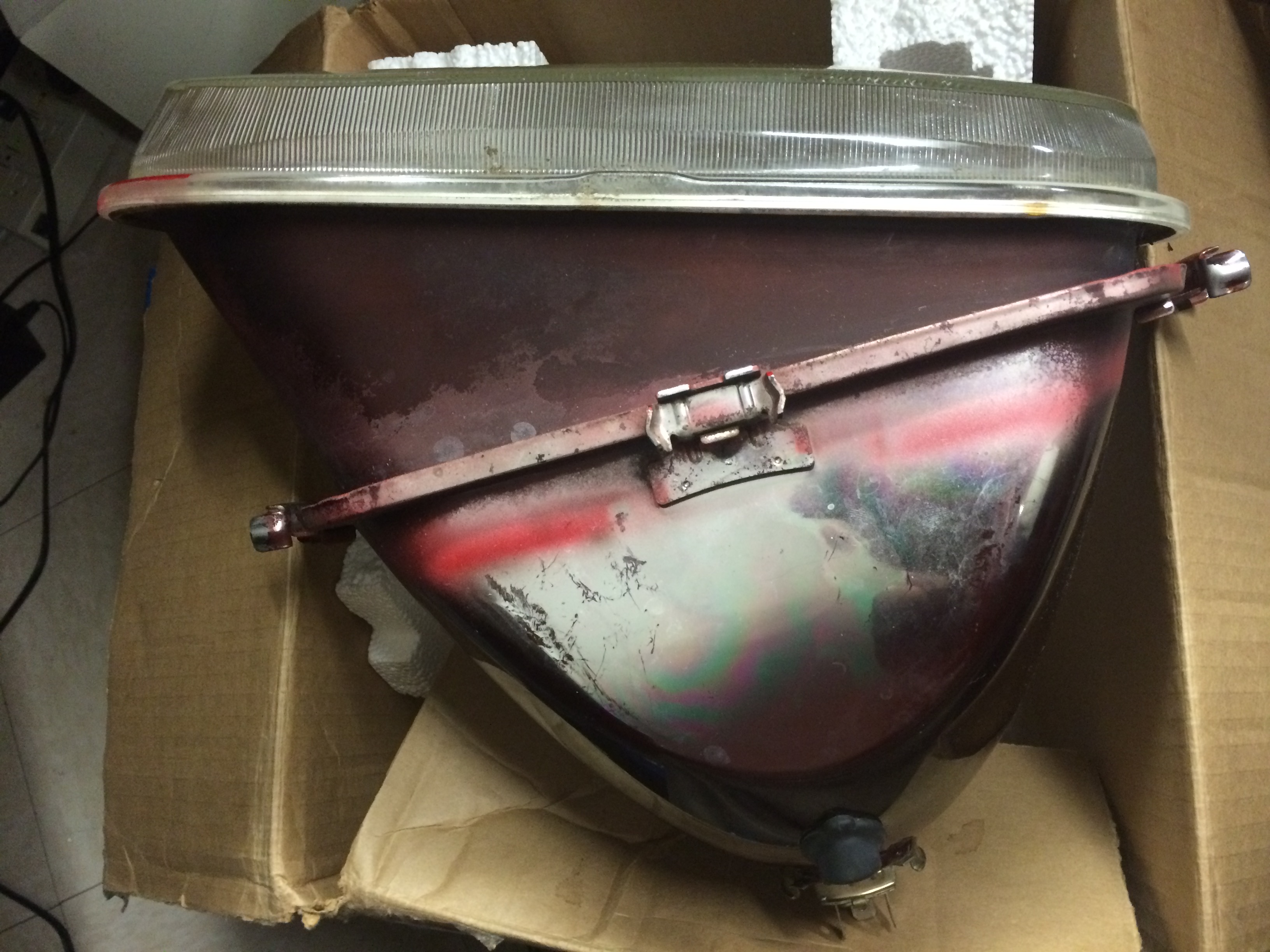

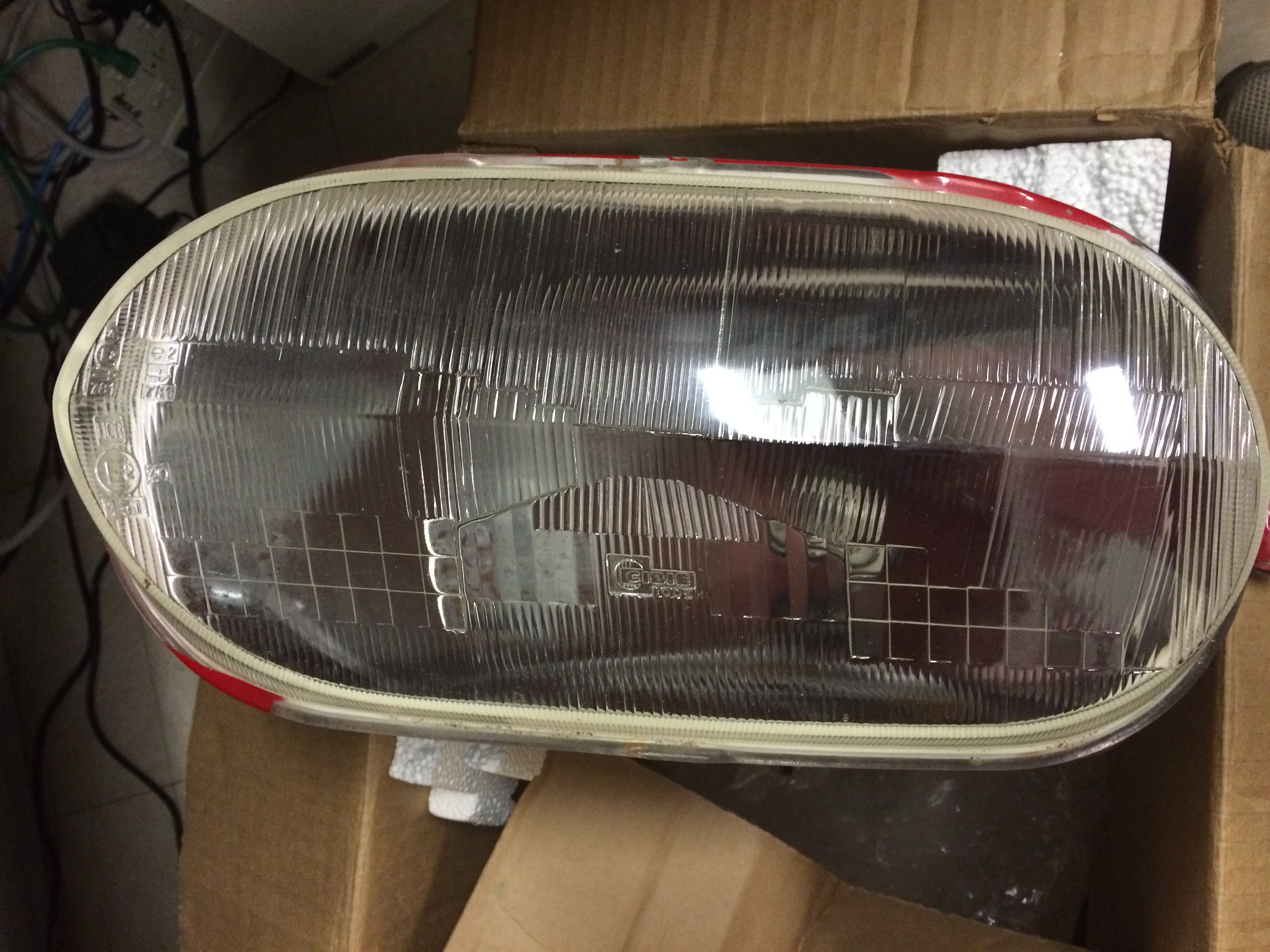

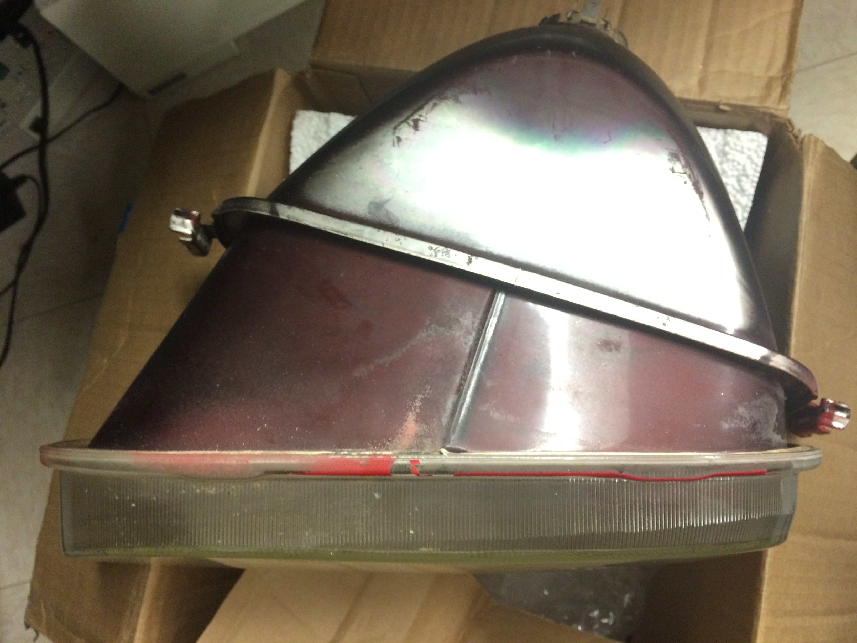

this is a shout out to German XJS owners
how are these mounted...?
any and all help is much appreciated...
parts list on the difference in usa mounting vs german mount
if there is a difference... Hi Greg!

They literally pop right into a plastic bracket. I have a Canadian car with those, and they are a little finicky. From what I understand, the receivers are no longer available.

I'm betting the difference is that German market cars has motors and mechanisms to adjust headlight level/aim to compensate for vehicle load/ride height.
Others will chime in
DD
Old Dec 11, 2015 | 05:26 PM
ptjs1's Avatar
Posts: 4,580
Likes: 3,528
From: Kent, UK
Doug,
Certainly late German exports had the adjustable frames with cable-based adjustment.
Paul
Old Dec 11, 2015 | 07:31 PM
xjsman89's Avatar
Joined: Jan 2015
Posts: 177
Likes: 37
From: Olathe, KS
It looks like you may have some rust inside that bowl, I had a similar problem with mine. The light output was pretty poor. If you hit it with a heat gun that glass lens will pop right off and you could rechrome them. There's a split between the front and back half of the housing too, I used JB Weld to put mine back together.

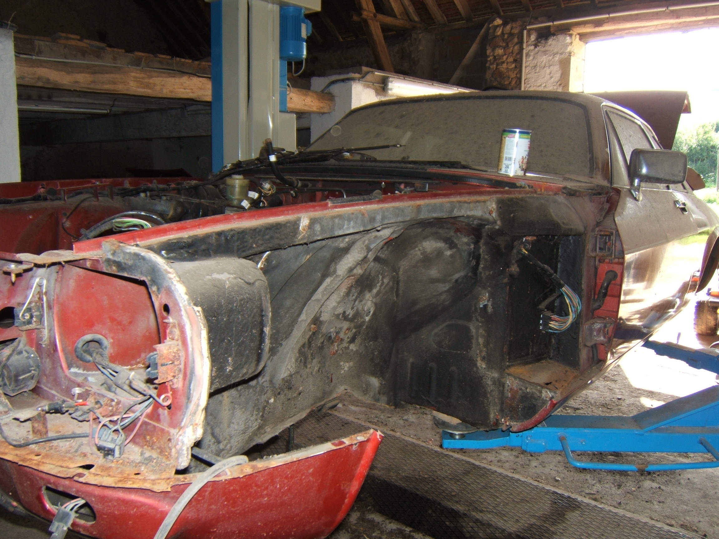

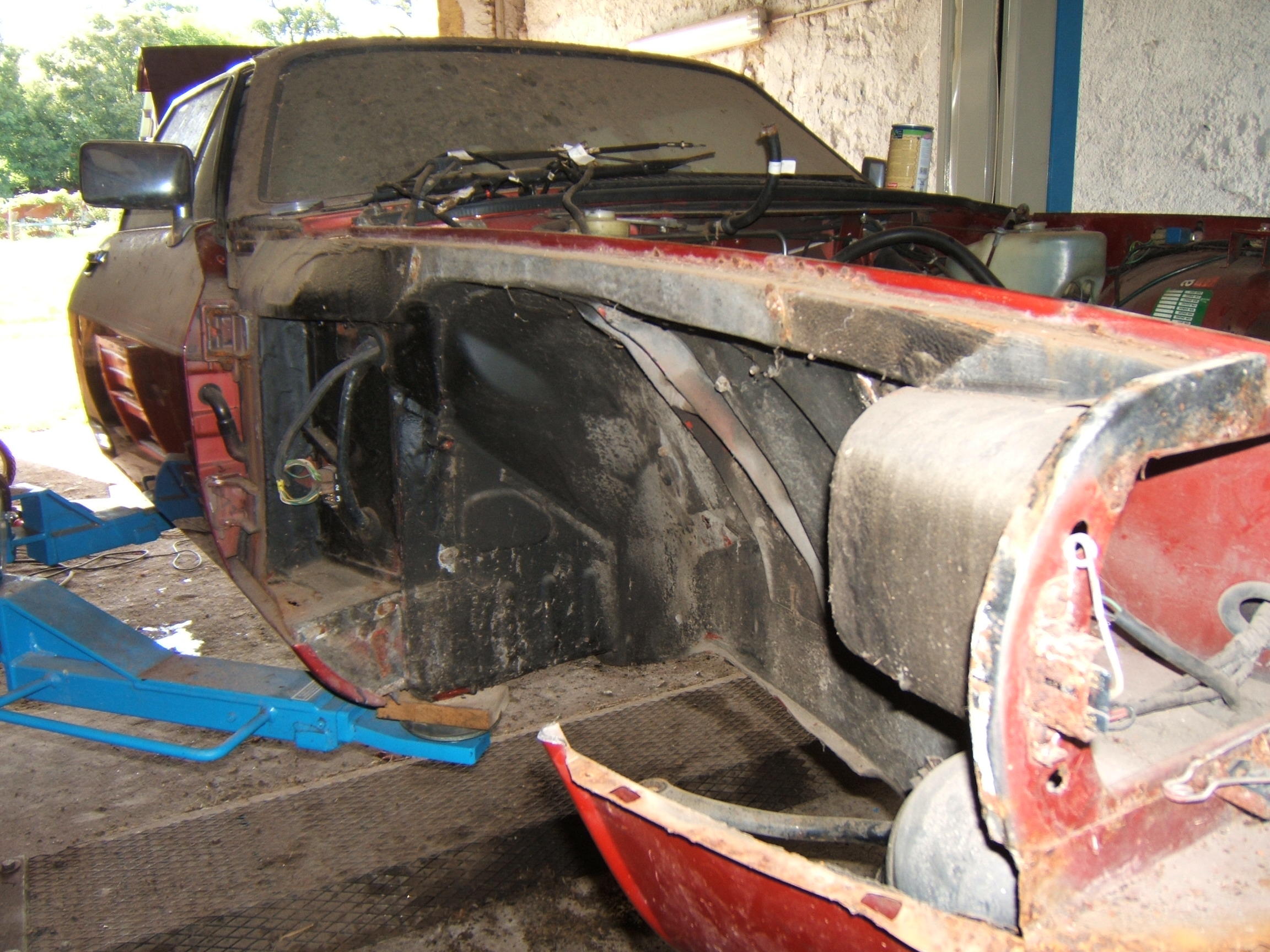

Congrats on the miles! The headlights in your photo look like pre-facelift ones, or at least pre-headlight-fixings change, which may have been later then the first facelifts appearing. The difference in the pre and post fixings is that post, the headlights were mounted on an oblong plastic frame that itself was fixed to the inner part of the nacelle. If you do have a post-change car, I do not think these lights will go in.
Pre facelifts have a slightly open-triangular-looking rubbishy clip that screws onto the nacelle at three points, and one side of this triangular effort holds a plastic slotted clip with an adjuster built in. To mount the pre facelift headlight, the clips have to be screwed on, then, with great care and difficulty the headlight itself pushed into the nacelle so that the tabs on the headlight sides and bottom click into the plastic bit of the clip. This is very hard to achieve, even with new clips, as usually one of the three seems to be engaged but actually is not. Which you do not find out until you try to use the adjusters and nothing happens. The attached photos show the clips. It can be done, but it is very fiddly and very hard to be sure the headlights are actually in properly.
I actually have in stock a pair of extremely rare LHD "euro" headlights, but I have not mounted them because of the difficulty of doing it securely. I am waiting for inspiration/suggestions about how to do it - several years now. The problem being how to securely mount the adjusters to the actual headlight and then mount the adjuster to the nacelle, as there is basically no room once the headlight is in there! Also it has to have some vibration protection, so solid mounts cannot be used.
Anyway, if you try it, the adjusters are not available new anymore, I believe, but second hand ones are at all the UK breakers. Incidentally, if you DO need the facelift bracket-mounted sort, they are NLA, even for RHD cars. Sorry I cannot be more help.
Greg
