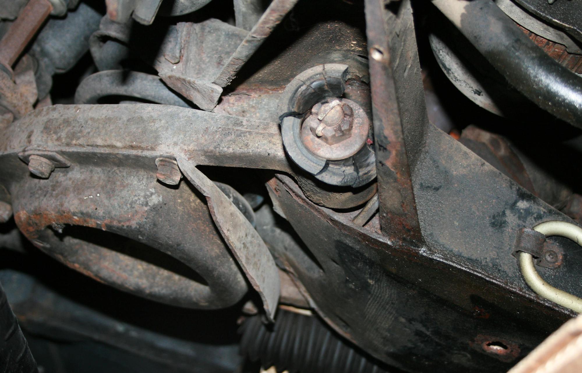

I mentioned early about finding pieces of control arm bushings in my driveway
Old Nov 6, 2024 | 02:48 PM
AZDoug's Avatar
Joined: Sep 2023
Posts: 441
Likes: 237
From: Central Arizona
Default I mentioned earlier about finding pieces of control arm bushings in my driveway
Polyurethane, not stock.
Here is pic of one of them being extruded from its proper location.
I have on hand new, OEM style bushings from manners (IIRC) in the UK. (Thanks, Greg!)
I know NOT to tighten the nuts fully until the car is on the ground and has been bounced up and down several times.
The car only had 53K miles on it, not enough to justify new bushings. Based on other "modifications", it seems the previous owner was trying to make the car (an H&E convertible) into some sort of track car, or at least, performance car, thus the unnecessary switch to poly bushings.
The whole front suspension will be disassembled, cleaned and painted prior to reassembly.
Doug

Good decision. You will notice the difference.

Or drive it up on blocks at the front to get access; but as LnR says, it MUST stay on its own weight after the settling run when you tighten up the castellated nut.
The other point about the poly lower bushes, apart from their inability to reproduce the famous Jaguar ride/handling combination, is that they work in a different way from the metalastics. The metalastiks work by allowing the rubber to deform with the suspension movement, which is why tightening at their midpoint is so important if they are not to tear. None of the surfaces actually move; not the rubber against the inner steel core tube, nor the bush/suspension eye surfaces. This is why the special washers have knurled surfaces to grip the tube and the rubber is bonded to that tube.
Polys, by contrast, are meant to actually swivel about their central steel tube, the tube being fixed by the tightening process and the suspension arm eye/bush surface also not moving; the suspension movement SHOULD be accomodated by the 'bearing' surface between the poly bush inside surface and the steel tube, which should be able to move as the suspension does. This is why lubricating this poly/steel tube surface is advised to prevent squeaks. I believe that the problems with poly lower bushes sometimes arise because the Jaguar special washers that grip the inner steel tube ALSO tend to grip the ends of the poly bushes, thus preventing their ability to swivel about the tubes; so they have no option but to break up.

That all makes sense. Simply dropping the car down from some lifted position, sets the tires on the ground with a slightly narrower track, as the tire contact patch can't spread outward like it does when the tires are rolling, allowing the track width to return to normal and de-stressing the bushings.
I have a four post lift, so yes, its easy to drive the car onto that for final control arm nut torquing. Working on my back, under a car, has lost some of its appeal as i grew older.
Doug
