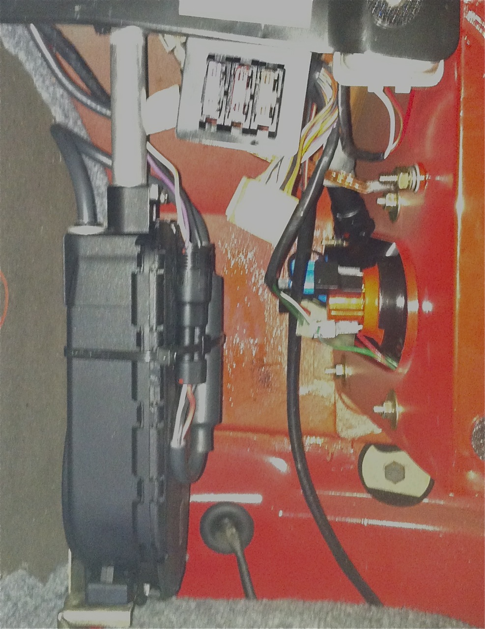

Passenger side inside trunk there is something missing either a amp for the radio or this car also has a phone power antenna????? this is a 92 convertible v12

its a 1992 xjs convertible

That space in my 91 (92 my) has the alarm boxes in. all plugs into that big connecter. siren bits inside the left front wing (fender) was an extra option then.

do you have remote locking, anything plugged into that big connecter ? the radio antenna is just in the same place not connected to the alarm. coax cable is for remote locking (on mine)

The power antenna unit should be mounted on that brass-coloured bracket. The green relay in your photo is the antenna relay (delayed retraction when you turn off) which runs off that 10A fuse also visible in the photo. I guess you don't have a power antenna. I'm basing all this on my 92 coupe.

Maybe I misunderstood the problem...that big connector is hanging empty on my coupe too. Nothing is missing.

It does seem that the power antenna is missing. looks like PO put a manual in. do you have a power radio antenna ?

Thanks for the picture. Looks like the power antenna is missing-the other group of wires are just there on yours as well wonder what they go to?

Your electric antenna is missing and the white connecting block and black plug are for the xjs 1992 my security system factory alarm, remote door lock controller that was fitted to the facelift '92 my. I fitted the kit myself as wanted the remote doors. Just plugs in.......see link l posted above.
