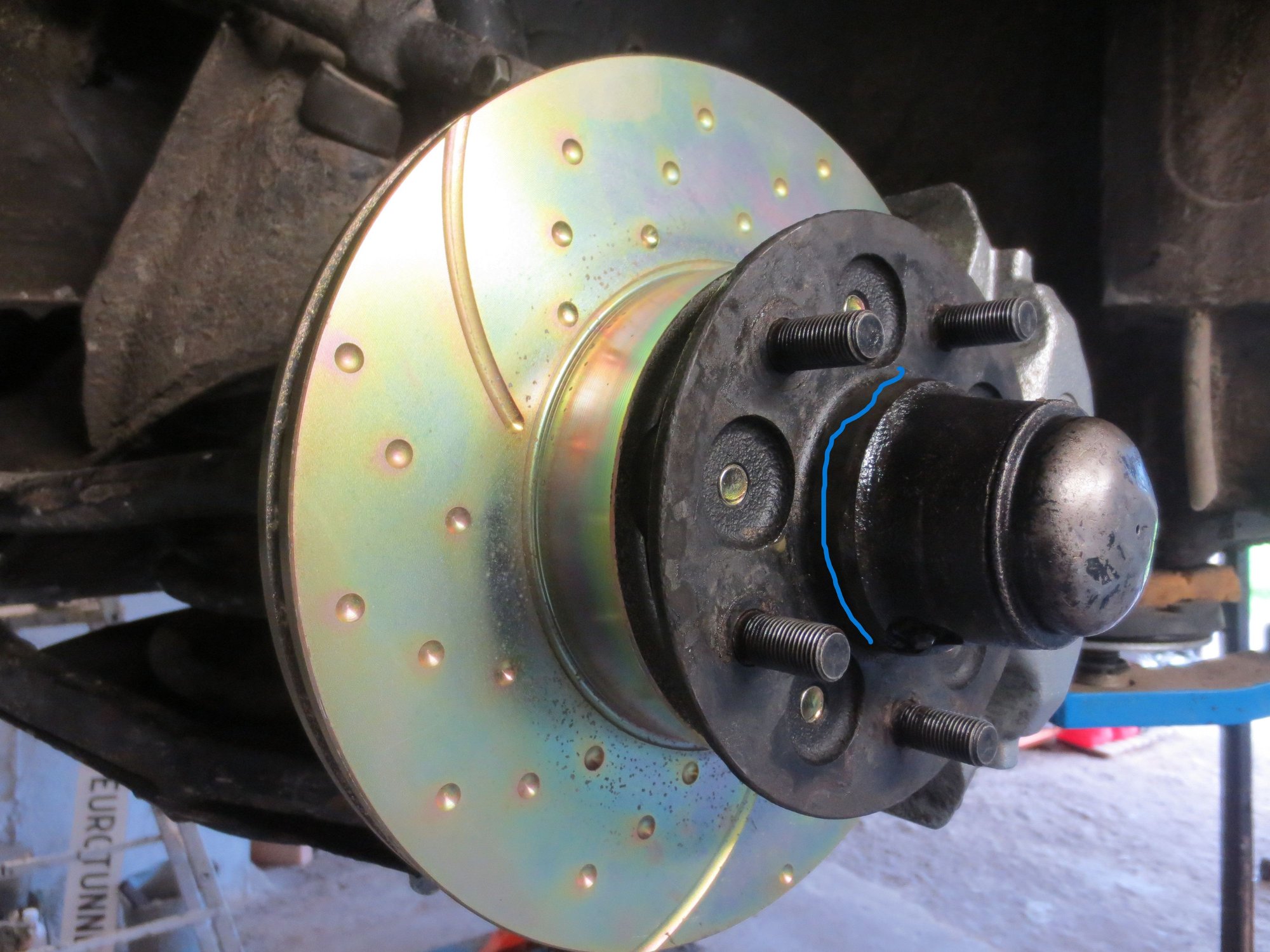

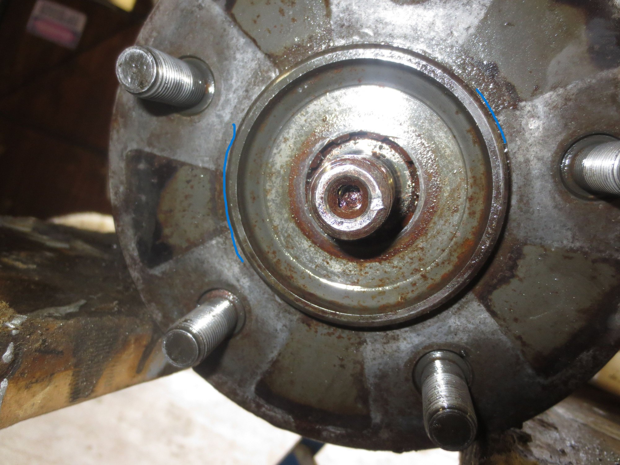

As I understand it, the Jaguar wheels are hub-centric, that is a machined conical male centre on the hub fits precisely into a machined conical female on the wheel itself. These are only about 1/4 inch deep on the rear hubs, but are deeper and more obvious on the fronts, but they do the wheel locating. The washer under the wheelnut is what holds the wheel to the hub, the washer being essential so the nut can clamp the wheel, without that the nuts would not clamp the wheel in place. The precise diameter of the nut tube (within limits, obviously) is not important in the XJS fitment, as long as it properly holds the washer to clamp the wheel.
Rear hub with centric cone marked in blue
Front hub with centric cone marked in blue
I realise loads of cars have wheelnuts that are conical and that locate into conical depressions in the wheel itself. Jaguar XJS wheels are not located in this way.
