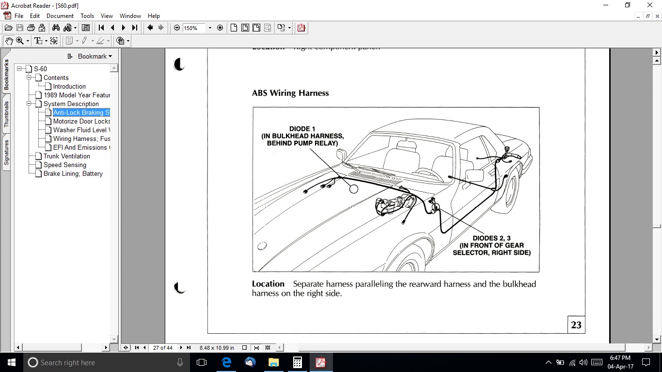

I found the diode
Attached Thumbnails I'm back to work on the Short in my ABS !!-abs-wiring.jpg

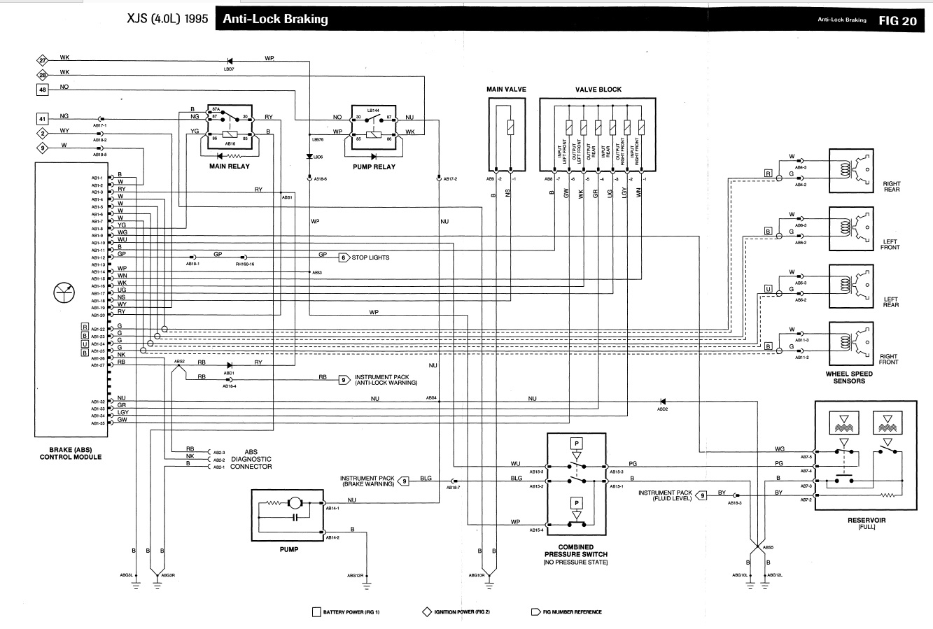

In the abs wiring diagram (fig 27.1) the 30 amp fuse that is blowing is located in the center top and it's the one with the brown and orange wire which then goes to the relay DAC 4506, through the open/close then to the pump via the brown and orange wire. There is no continuity between the two as I would expect since the ignition switch is not on and the fuse does not blow until 10 seconds after the ignition is on. I think that would rule out the brown wire to the battery ?? but not the brown orange wire to the pump which also shows no continuity ??

I don't understand what you mean by the NO wire has no continuity, where are you measuring NO to ground or end to end of the wire?
The NO wire is only a couple of inches long as the ABS relay is next to the 30A fuse. The NU (Brown/Blue) goes from the ABS relay to the pump. You said the pump runs for a few seconds is this correct?

What would the danger be of hooking up the brown wire that goes to the fuse that is blowing and hooking it up to the brown orange wire coming from pin 87 on the pump relay under the dash ?? Must be some way that I can narrow down where the heck the short is?? On the figure 27.1 it shows the brown orange wire going through a CP7 which is something ?? then one wire goes to the pump and the other to the main valve.... Could it be the brown wire coming from the battery spur that is pinched ?? Where do they connect to the battery ??? I could check continuity to the switch ??

Think the cp7 must be the connector between the brown orange/black ground wires to the pump motor itself....

I cut the brown/blue wire from the pump and when I connect a meter to the loom side, it grounds out and I don't believe it should ?? The wire where I cut it is fine to where the brown/blue wire goes into the wheel well area on the driver's side and has continuity. The wire going into the wheel well grounds out ?? Where does this wire go as I don't believe it should ground out ?? Does it run under the center console to the ECU pin 32 ?? If so, should I check the continuity from there to where I cut it where it enters the wheel well on the driver’s side. ??
By the ecu, I found a seimens relay V23134_A55-X80. It has 85,86 power two 87s and a 30 between. I also have a spare that is the same but the two do not test out the same ??? How do I find out which one is correct ??

The Brown/Blue (NU) wire should not ground that's why the fuse is blowing. Find CP7 and unplug it to isolate all the NU wires and trace it back from there.
The chances are it's shorting out where it goes through a grommet.
