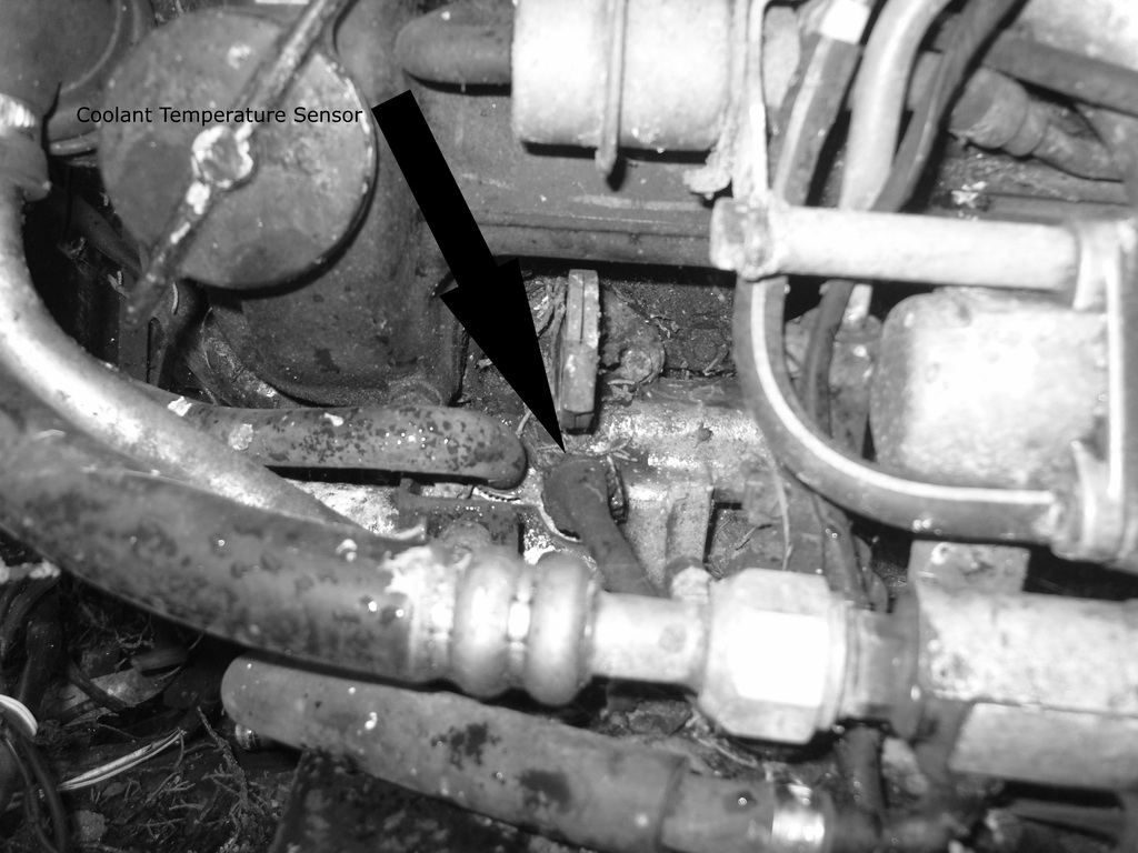

Hi
This doesn't sound anything like a problem with the Thermostats but much more likely to be a faulty Coolant Temperature Sensor (see Pic)
The Coolant Temperature Sensor, sends a message to the ECU in order to tell it how much fuel to deliver.
In the event it is faulty, then it could make the engine run 'Rich' and as such could be the reason, why your Car is failing the 'Smog Test'
The First thing to do is Check the Plug, as they get Corroded and could interfere with the Signal being sent to the ECU so give that a Clean or maybe get a new Plug. (Don't lose the spring clip that holds it in place)
Also Clean the Terminals on the Coolant Temperature Sensor.
That could well be all you need to do, unless you want to go 'belt and braces' and treat yourself to a new one, as they don't cost megabucks.
NEW BMW E23 E24 Jaguar XJS Porsche 928 FAE Engine Temperature Sensor DBC3728 | eBay

Now the temperature switches would make sense. Using an infrared thermometer, the car is running about 140 degrees (give or take about 5 degrees), and if the ECU is being told a different/colder/no temp, then it would try running the fuel mixture richer than it needs to be.
It is my understanding that the V12 has two temperature sensors. The left/US driver side is for the temp gauge in the dashboard, and the right/US passenger is for the electric fan. My electric fan is turning on, although now as I'm thinking about it, why the heck is it turning on when the engine doesn't even reach normal operating speed? Does the ECU increase fuel when it is signaled that the motor is warm? I would think it would decrease fuel, but I'm not sure of much at this point.
I'll check and clean the leads to both temperature sensors when I get home tonight. I'll also see where I can obtain them if the leads look clean, as these are probably the originals from 1989. If any of you know, which of the two sends the signal to the ECU? I'm guessing the left/US driver one by the last response.

If the Coolant Temperature Sensor is faulty and needs replacing, it might not be sending any Signal at all and as such won't be reducing the fuel supply when the engine gets hot.
It should be by the Oil fill Cap next to that curved hose as in the Pic.

I agree with you, if the engine temp switch isn't sending a signal to the ECU that the coolant is hot, it won't adjust the air-gas ratio. The only thing here is that the temperature gauge on the dash is giving readings that are comparable to those I get when using an infrared thermometer, leading me to think that the temp sensor is working correctly.
Still, I'll clean the leads, as they are probably due to be cleaned by now. Maybe I'll accidentally knock out the bugger with whatever is going on.
