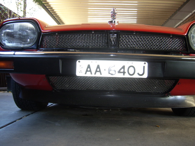

No idea on that one.
I got one of these.
Not real good snaps, but show enough "I think".

Love your car Grant. That is the same leaper I have on mine with the round base. They are made for the XJ-S ,the round base bolts on to where the badge is so you can always go back and forth between the badge and the leaper. The cat is also larger like the ones in the XK150's (those that came with leapers anyway)

Grant,
Would that grill fit on a 95 xjs?

That would depend on your imagination.
That is my "original" plastic grille, which cracked 14 years ago, and at $600, I really wanted the car to look stock, HAHAHAHA.
I removed the inner vanes/guts (small handsaw, and a rasp), wandered into a "woven wire" mob down here, and the guy was a Jag nutter worse than me (impossible), so 6 hours later I left with an off cut of what you see. Made it myself, about 4 hours, but really did not keep time tabs.
Then the lower crappy thing got up my nose, so repeated the process to what you see in the snaps.
It really keeps the bugs out of the radiators, which is a secondary bonus, not on the brain wave at that time.

Grant,
Where did you get that mesh from?

Simply looked up "woven wire suppliers" in the Yellow Pages (no google in those days).
Should be someone like that in your area/country.
Mine is Stainless Woven Wire.
Ours sell it by the metre, and its about 1 metre wide.
Dont get too heavy a gauge, as it is a mongrel to cut.
You will need decent "heavy duty" side cutters. Grinding it was NOT an option for me. Cuts by the hundreds will be part of the fun. A sense of humour will help heaps, as will the ability to look/think "outside the square", as we say.

Thanks Grant. One more question. I see that Mina Gallery sells the mesh grill that looks like yours. I have a 95 xjs. Do you know if a 93 model grill would work with my 95 or did they change the shape? They one they sell that looks like yours is for up to a 93 model. Just curious if it would fit on mine...

OH,
I have seen, maaaaaany years ago, the "update" grille in the early cars. I believe that was the price thing at play in those days.
It was also claimed???, it gave slightly more clearance to that lower plastic hinge cover panel??, dunno.
Soooo, based on that, I see no reason why it wont physically fit in the hole, attachment "may" be an imagination test, but a good slug of JD prior should make all things clear as crystal haha.
The parts book still shows 4 screws along the top edge, and 2 near the lower (horizontal) blade, which is the same set up as the early grilles.
