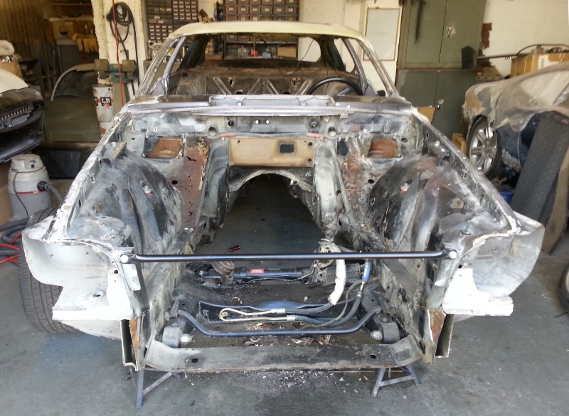

I could but the car will not look much like an XJS, everything is highly modified, the only recognizable part will be the buttresses and the rear lights..... Kind of.... It's quite hard to explain?
Wow... hats off (once again) to you guys with the skill and knowledge to pull off something like this.
Please, post the process!!! May not end up looking like an XJS, but it's based on one, so close enough.
Is this a build for yourself or a client? Do you have any sketches of what the finished product will look like, and what kind of power are you looking to extract from the V8?
You will have to squint a lot..... The car was converted to a Monaco years ago and is believed to of been No.1 which was owned by the Sultan of Brunei (debatable possibly).
I use to own one myself which as you have seen I started to play with but opted to put back to "normal" and sold a couple of years ago
I will be fitting one of my own front bumpers 2014 XK head lights, apart from that the body work is mainly Monaco although this is a 87 car I have converted it to facelift, pillarless doors, rear lights, trunk lid and quarter light windows
Originally a V12 which is a nightmare engine IMO, hard to work on, messy, rubbish electrics and costs a fortune to tune to any real power. I know some of my remarks are going to upset some, but there you go....
V12 went in the eBay bin and was sold, I still have the gearbox if anyone is interested, a full recon item with no miles put on it yet
I'm looking at getting around the 500 hp mark, not a problem to do really, don't need cats, I will make a nice induction kit, lower pulley, maybe upper as well with water/meth...
I am going to take a look at fitting the whole rear bed so I have the correct diff and outboard discs, shame really as it has a full recon bed on it with new brakes and an LSD, this too will be up for sale if I pull the swap off. Having the XJ bed gives me brake options as well, Brembos can be fitted for starters..... I have an LSD sitting on the shop floor I may use but might go a different route...... This is a customers car which he has given me free rein to a large degree which is good as I can make a really great looking car.
I shall be using a large proportion of the XJ interior, I have to shorten the dash 4", the centre console looks like it will fit, all the air con I can squeeze in, like I said previously I am planning on using as much as possible from the XJ however XK seats will be used and the seat modules seem to work on the XJ loom which is a bonus
As stated not much of an XJS left !.....

Putting the body to oneside fundamentally the conversion can be as simple or complicated as you like........ The V12 went for £300 an absolute bargain for someone, got it out of my way!
If you want to go V8 but keep the look on the inside of the cabin you do not need to go as a drastic route as me....... Easiest gearbox to use is from a S Type diesel V6 2.7, bolts straight on to the V8 handles the power easy, you will have to make a flywheel, use the ring gear from the flexi plate off the V8 and get one turned up, use a standalone ECU plenty out there you could even get away with a megasquirt if you wanted to...... Prop is easy to sort and you are up and running, I would go the R engine might as well have the poke
Something I forgot to mention that is a bit of a pain...... The sump!
You will have to modify the bed, the pan or dry sump it, the supercharged engine sits high so as a minimum you would have to fit a straight 6 bonnet/hood or put a bulge in.....

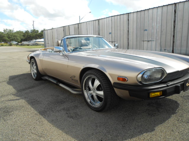

some pix of my 1978 XJS roadster(Flint has seen them,and others). done back in 94-95, little ahead of the curve, but still viable in the car world.

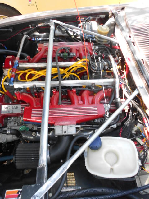

i do like my version of the V12 ,no Lucas under the hood, all electronics are GM stuff,much more reliable.
is your car a LHD, is it legal in UK?
i have never seen a Jaguar S-type diesel in USA,much less procure a transmission. making up a flywheel,HMM! balancing, alignment,ETC?
i use a GM 700R4 auto. with overdrive, special light weight convertor(instant engine response) with a rear drive ratio 3.73-1.HD power lock.
rear trans mount chevy part $25. usd. custom cross member $10. also aluminum driveshaft.
had to stiffen the body,rear seat delete,(open top car),and front engine bay cross mount.
wide body rear fender flares, also helped to stiffen body. been thinking, i may shorten the rear overhang(kinda looks to long),IMO.
i use a standalone ECU since 1994, upgraded 2 times, much improvement in resolution and adjustments.
i do respect all types of engines and drive systems, been modifing cars for over 60yrs.
but there is something about a 12cylinder engine, that is Kool, maybe the bragging rights,talk the talk or just plain sound.
my custom exhaust exits all 12 cylinders from one outlet , and the sound is absolutely fantastic, especially above 4000rpm(at least thats what the guys say).
and yes, not for everyone, i do understand.
V12 is 100% custom overhauled, hi-pistons, performance cams, custom heads,etc.(still dont make expected power), but good enough for street work.
