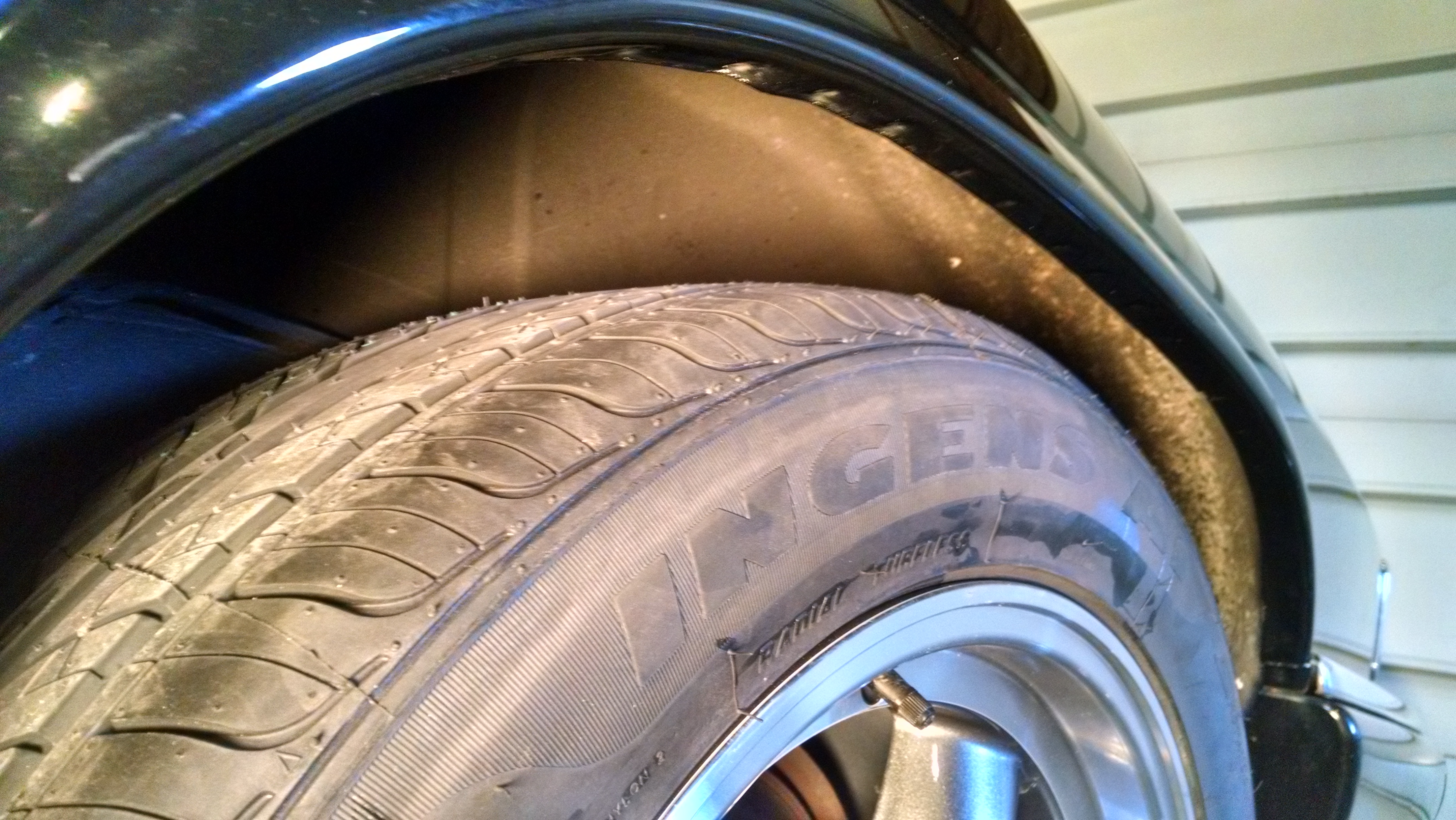

The tires came in today and I had one mounted. Put it on the left rear and it looks like there's plenty of clearance to me. Way more than I expected. I rocked the car up and down as hard as I could and can't get it to touch.
Anyone know what the maximum suspension travel is??
Attached Thumbnails Just Bought an XJS!!!-img_20170214_152336738.jpg   Just Bought an XJS!!!-img_20170214_152446521_hdr.jpg

Seems that the tyre clears the outside lip (that's already good) but difficult to judge from your pics if it will clear the inner side of the fender on full compression.
Could you take a pic from the ground upwards, if possible edging and parallel to the outside of the tyre?
Or you have to drive and test it on bumps

According to the offset calculator your wheel will be 13mm closer to the wheel arch than mine.
It's not the lip where it will rub it's above the lip on bump.

All other things equal, in principle the only thing that should put his tyre closer to the wheel arch is the smaller offset, by 28 - 19, so 9 mm.
Indeed, if there were no effect from the wider rim (in principle 0.4" from what I quoted before), the increased width from 7" to 8" does not move the centerline of the tread, so does not put the tyre closer from the wheel arch.
But if we take into account half of that 0.4" which stretches the tyre (which is about 5 mm), then yes it is approximately 14 mm more outside in total, but at a level of mid sidewall which is lower than the tread level, so maybe still OK.
(not including the increased diameter of the tyre that may also worsen the situation)
Overall it's ...on the edge

This does not take into account the wider rim. The 8" rim is 25mm wider than the 7", 12.5mm + 9mm = 21.5mm closer to the fender lip.
To see where the outer part of the tyre is, use a plumb bob from the inner fender this will give you an idea where the outer could potentially rub.
I went through this in detail before I changed my rims to ensure I had no rubbing issues front and back.

I assumed that this part of the wheel (the rim edge) never comes close to the inner fender even at full bump and that therefore the increased rim width was not that important (in comparison to a modified offset and an increased tyre width).
But you may be right if you went through the process in detail yourself.

The increased rim width is important as the outer lip holds the tyre, and with the additional height of the 225 55 17 it could rub on bump.
I have 245 50 16 on an 8" rim ET33 and my tyres only miss the inner fender on full bump by a few mm.
One thing with these aftermarket rims is the hub is usually pretty thick to accommodate multiple offset fittings in 1 forging, so they can be machined to increase the offset.

All I know is there looks to be plenty of clearance to me. When will I drive this car and bottom out the suspension? Answer never. If I hit a giant pot hole and the tire rubs for a split second so what?? And I'm not even sure it would hit.
From what I have seen today I will go ahead and mount the other three tires and wheels. BTW the calculators seem dead on. My new setup sticks out exactly 9 mm more just like all the calculators said it would. Note the wheel sticks out another 12 mm or so. But that is independent of the tire.
