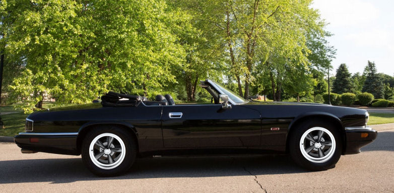

The wheels look fantastic.
That's a cheap ride to look and feel like a million bucks!!
You can't buy a used Ford Focus for that kind of money.

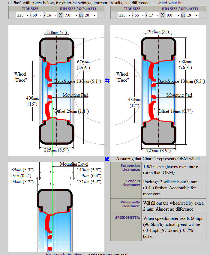

Glad you like the wheels but...........I just got an email from the store I ordered them from questioning the fitment. They are 17 x 8 with a +19 offset. Bolt pattern 5 x 120.65. The tires will be 225/55/17. According to the size compare tool on RimsnTires website they will stick out 9 mm further than stock and fill the wheel well by an extra 2 mm. Neither of those dimensions are an issue. But now they won't guarantee fitment if I go ahead with them.
17x8 with +19offset will fit the front but you will have rubbing in the rears. With an 8" rear offset needs to be +33.
On the XJS it's not the lip where the tyre hits' it's about 2-3" above where the fender curves.
Well we're gonna find out. According to the RimsNTires size compare tool they will stick out 9 mm (less than 3/8") more than what I have on it now and will be 2 mm higher in the well. It shouldn't be close to rubbing. That is provided that tool is correct. Tire on left is what I have now, tire on right is what I ordered.
Not sure where you got this but I've run the numbers through 2 online calculators and both say the rim will poke out 22mm more, this sounds right as my rears are 16x8 +33 so +19 will poke out 14mm more than my rims.
In any case I'll know in a week or two.
Keep in mind it's the tires that rub not the wheels. I have 225 tires on it now and the new tires are 225. My stock wheel offset is 28 and the new offset is 19. So a difference of 9 mm. Can't see why they won't clear easily. If I went with a 245 tire or larger then I can see possible issues.
So with a 28 offset an 8" rim will poke 12.5mm more then add 9mm = 21.5mm further out.
