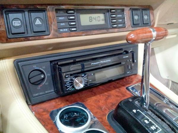

......you can fit a single DIN DVD player with 7" screen into an XJS without permanently modifying anything :-)
I had 2 main concerns before I tried this out...
1) Due to the fact that the trip computer panel juts further out of the dash than the radio slot, I knew I would have to have the new stereo pulled out of the dash a little bit to allow the screen to come out and be vertical. This turned out to be easy to do, and the unit doesn't look like it's sticking out too far when the screen is retracted, ie

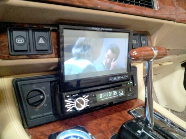

2) Would the screen clear the shifter when it was in park ?
Hold your breath and watch this.....
Amazingly it clears it quite easily.
This unit also supports a rear view camera so that'll be the next update.

Thanks for posting this. I would have sworn that one, or both of those potential problems would have prevented the use of a flip up screen.
Good job!

My car was molested by a previous owner so I had no connector plug, just a whole bunch of wires, so I just solder connected everything.
To get the unit sitting slightly out of the cage to enable the screen to flip up clear of the trip computer I was able to achieve this by bending tabs on the existing cage to stop the stero going all the way in. To do it properly you should probably fit a bracket at the back of the stereo that holds it in position, but I didn't do that. Once I had it in it was a snug enough fit to stay put so I left it at that. I wrapped black electrical tape round the exposed silver casing of the stereo to make it blend in. I know this sounds very hodge podge but it worked out well and looks fine.
I like the idea of using the camera to monitor the front spoiler........ I still haven't fitted my camera so this could be the motivation I need to do it !
