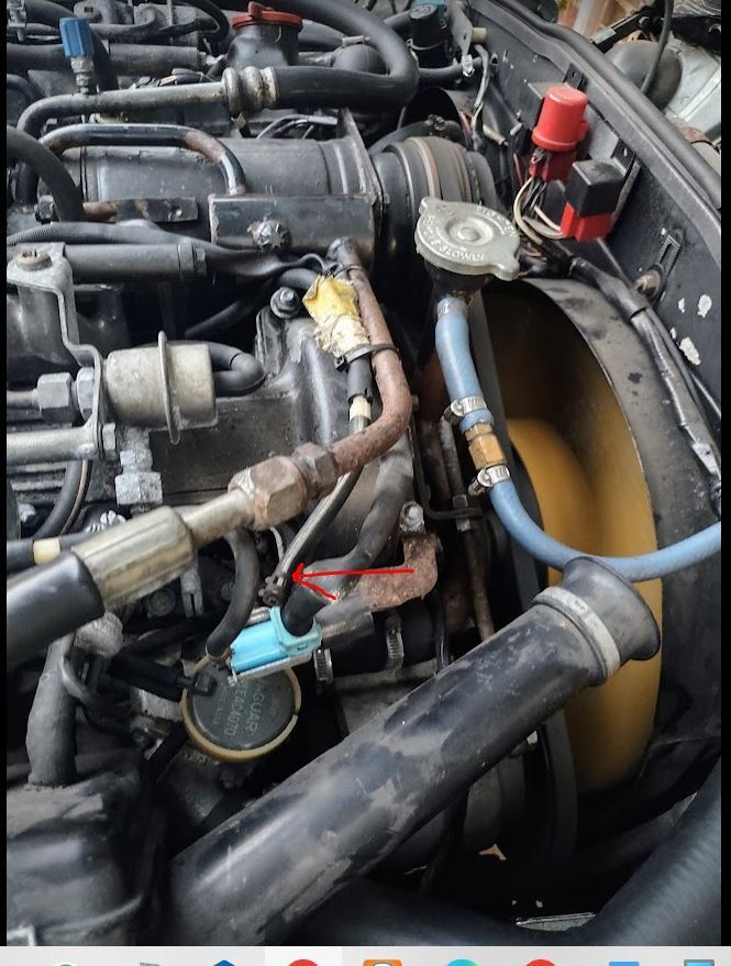

Does anyone know where this vacuum line goes? It's on the passenger side bank
Thanks in advance

It might go to that blue dump valve.
I see a broken plastic nipple in the end of the hose. Look for something nearby with a broken-off nipple

Thanks, the blue dump valve has a vacuum line attached so unless it's supposed to go elsewhere, I can't see where this one goes. I'm going to have to break down and join the jaguar owners club so that I can beg a local member to look at their car.
