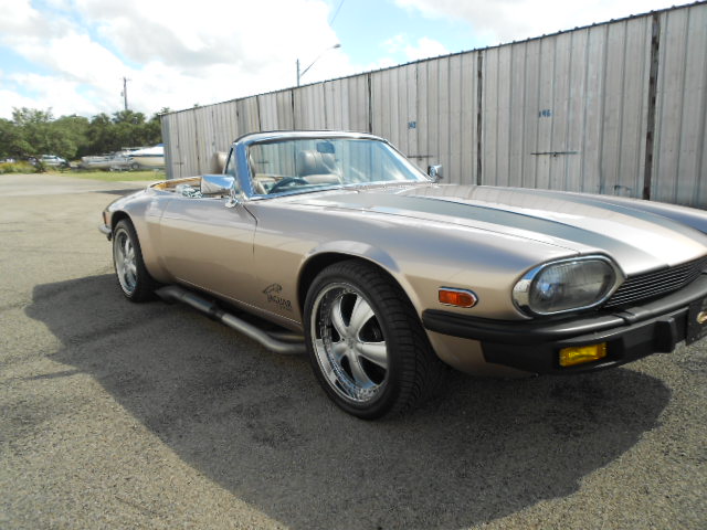

all of the above !
that Ferrari sounds OK ,but still a little harsh/raspy not enough BASS.
my 12 cylinders ALL exit from ONE Big Bassy outlet!
but in all fairness , exhaust sounds are like opinions, everybody has one!!?
i should make a video, you should hear Jag 12's at 7000 revs!
