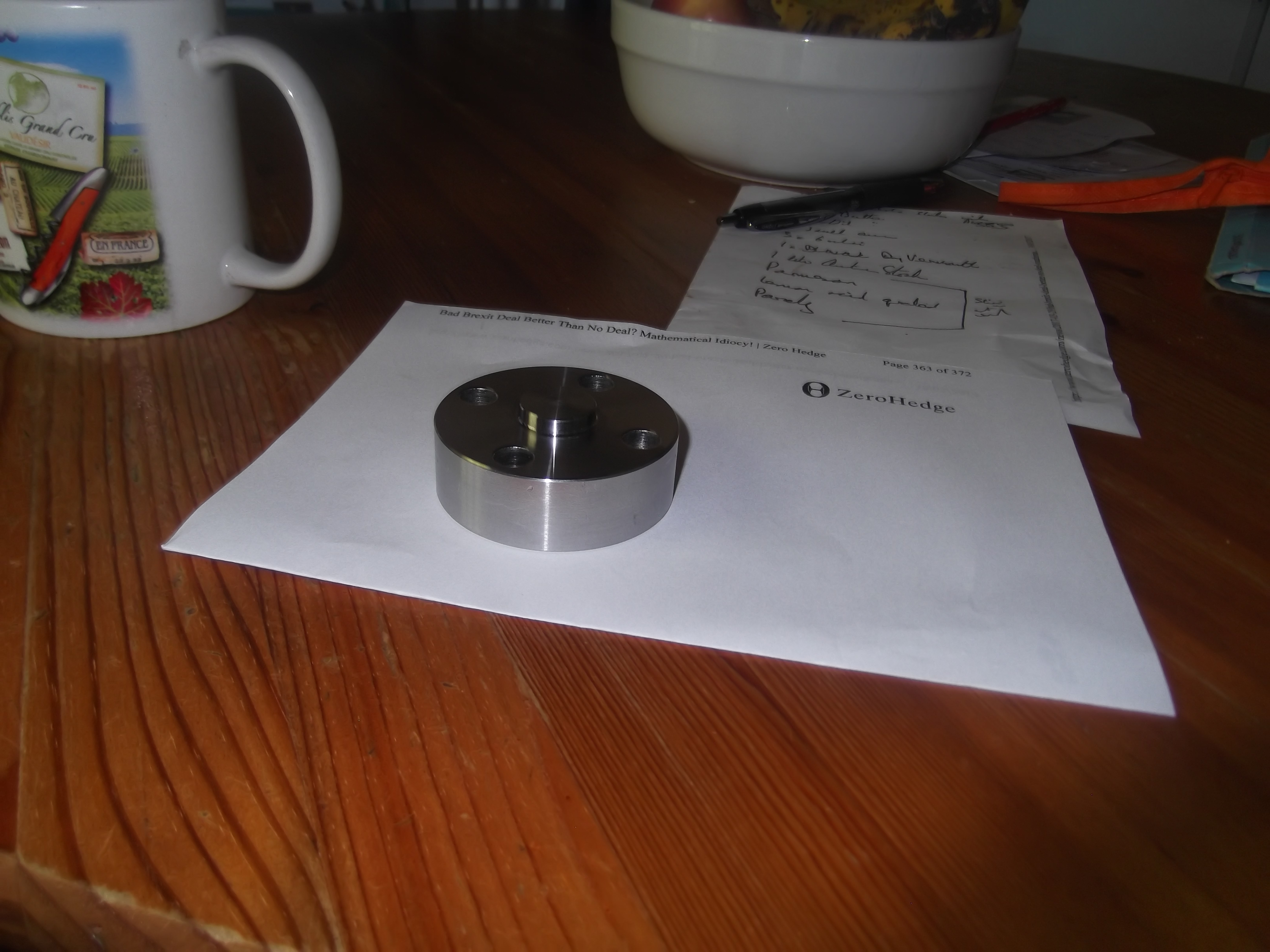

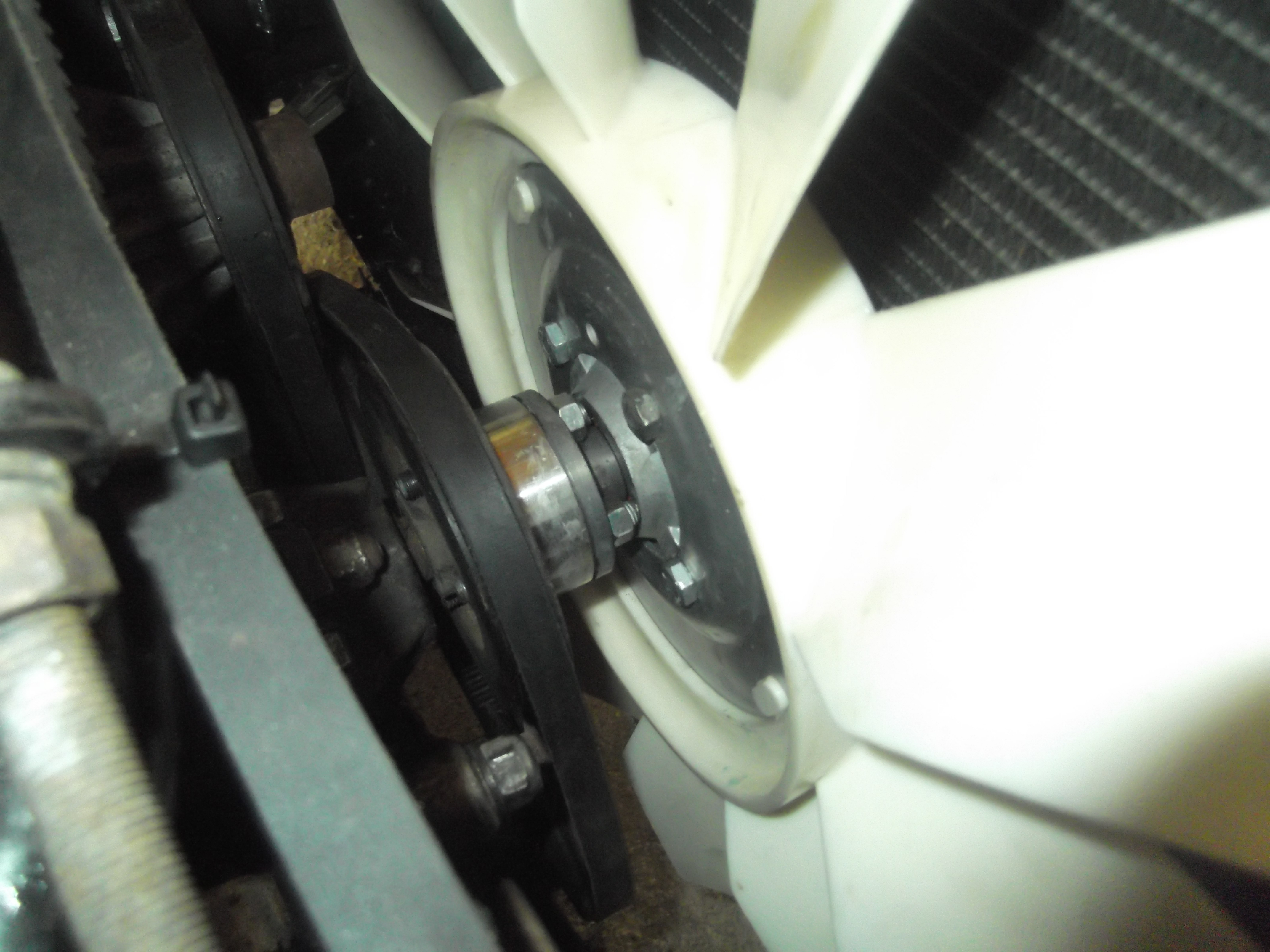

The blade has a larger diameter than the XJS one, so the shroud was removed and the blade fitted, but was too distant from the radiator for efficient airflow. My mate got a 20mm spacer made and we fitted it, so the fan blade and viscous unit were moved closer to the rad. The OE electric fan was replaced by an aftermarket electric mounted directly to the rad fins. The setup was tested recently: no radiator foams, no shroud. I can report that the cooling was superb, absolutely no worries at all, needle well below the N at all times.
So if anyone does not want to go the electric fan route, this is a very viable alternative.
