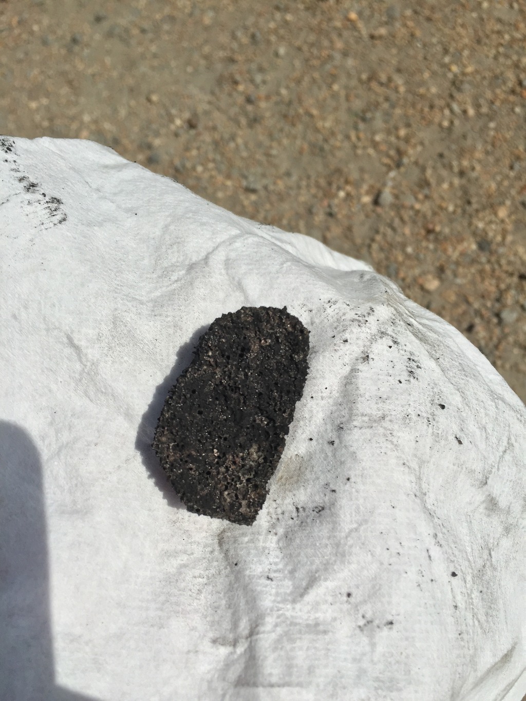

However, even after it started I still thought it revved poorly and didn't run that well. I didn't investigate because car wasn't drivable. In the process of replacing front suspension and fixing rust holes in pan I removed exhaust system. Then decided to remove downpipes and gut the cats since no emissions needed where I live for this year model. (also, decided to wrap downpipes in header wrap to reduce heat).
Well look what I found, The right side catalytic converter was melted, it was nearly water-tight when I sprayed hose into it. I'm surprised car ran at all.

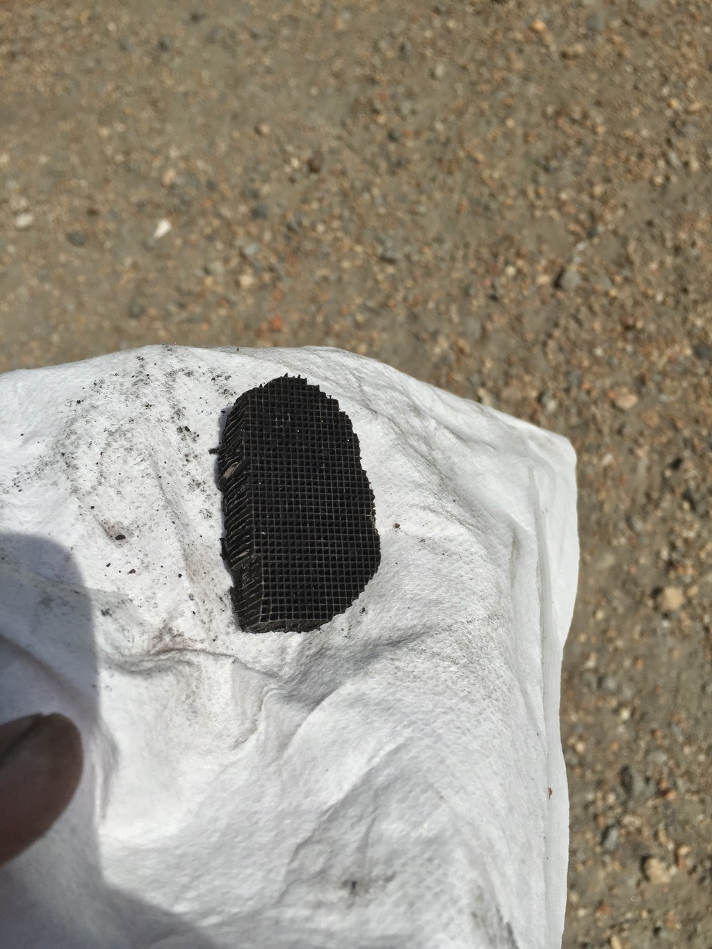

Intact cat:
Melted cat:

Intact cat:
Melted cat:
I should clarify last sentence. I saw down pipes with cats for $260 each on eBay. Since it would be difficult to verify the condition of the cats, it might make sense for people with cars with an unknown history (future searchers on this site) to consider simply replacing cats on Marelli cars to rule out exhaust system problems.
My car started (after I fixed other stuff) and idled smooth. The only symptom was that it revved slow (I never drove the car on the street) and the right side exhaust (the melted side) was noticeably cooler than left side. I'm certain that if i'd driven the car for any distance the cat would've been glowing red.

The melt down could have been caused by a faulty ignition amp which can shut down half the engine allowing unburned fuel to be pumped into the cats where it then ignites. Replacing the cat may not cure the problem.
