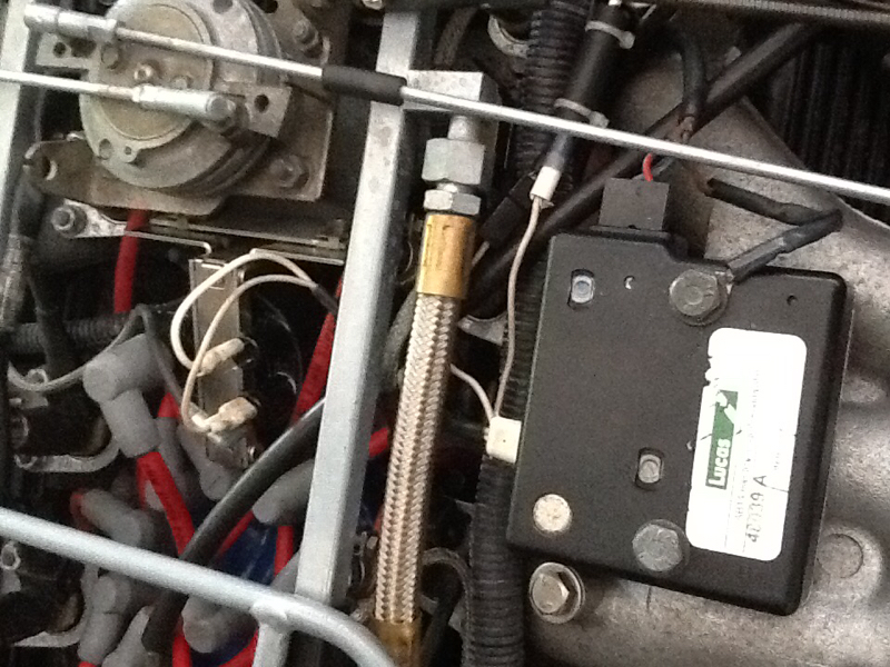

Here's my single coil set-up
Positive wire in front, neg on rear
Notice the ground lug on the stock unit, most aftermarket modules do not have this.

Wait... positive goes on the front of the coil, as in towards the front bumper, or the terminal towards the firewall? because now that I look at yours, mine looks the exact opposite...

My positive white wire goes on the front coil connection with the FI loom wire, the negative goes on the back alone.

I need to change mine then. Mine are the exact opposite.
