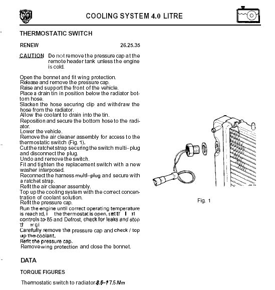

I'm not sure which manual you are using but the proper Jaguar manual is very clear about the desription and placement of the thermostatic switch in the top left of the rad. It even has a section (26.25.35) which describes the replacement of the switch.
The white and white/blue is a bit misleading. There's a wiring junction plug just a few inches away and the colours then change to the described black and green/brown.
So, yes, you are looking at thermostatic switch. Expensive but still available from Jaguar today. See here if you need to buy a new one:

I was glad that I found this thread as I had misinformation about the location. I also was able to find the directions from the service manual section noted. My dealer told me that part is discontinued, but I bought an FAE part online (Spain manuf.). I'm not certain why manual tells you to remove lower radiator hose, as the sensor is so high up, I don't know why one would need to drain entire cooling system. My fan comes on with AC, but doesn't come on when temp gauge reads 3/4. I have been putting inside fan on heat, which is very unpleasant on those hot summer days in traffic!
