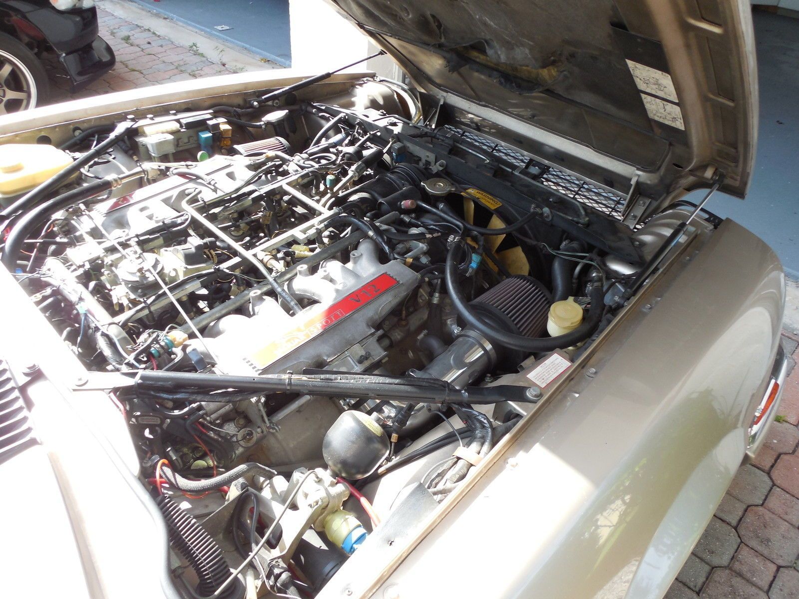

Hidden in this engine pic is a blown head gasket that ended up destroying the engine. In my limited experience, there are a few internal engine problems, most heat-related. R & R tends to be a not-for-the-fainthearted experience, due to the weight of the engine/transmission assembly.

90% of Jaguar HE V12 went down because of overheating, that usauly causes a dropped valve seat along with it!

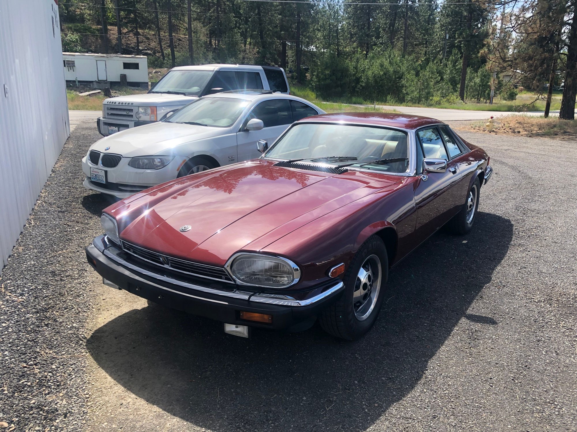

So I think I may have found my XJS. It's been a good few weeks since I posted anything, but I have been looking for my car and reading more about these cars and the V12 engines trying to absorb what I can to attempt making a good decision about a car. I had a couple checked out, including the light blue one posted in the beginning of this thread. That one turned out to be rougher than the pictures showed.
This car is a 1986. I had the pre-purchase inspection done by a garage that regularly works on Jaguars as well as other European cars. 42,000 miles, Carfax shows service done on a regular basis with anywhere from 50-500 miles a year. The car has been garaged it's whole life and owned by the same owner since 1987. Still the car is not without a couple of issues noted during the inspection.
A/C needs to be charged at a minimum. Blows at about 68 degrees. Coolant system needs to be flushed, and hoses should probably be changed. The report says "Hoses- show some age but in good condition". The car has various "very minor" oil and leaks seepage/leaks. Speaking with the garage they told me these are all seepage, there is nothing with a drip.
So the 2 things mentioned really concerning is the rubber boots around the ball joints are torn/deteriorated from age, in good condition but they status the ball joints as in good condition but should be monitored. Same with the oil leaks, meaning they don't warrant the work required to change them out. Yet, anyway.
The garage said overall the car is in very nice condition and one of the nicest they have seen.
The coolant system was flushed out a few years ago according to service records.
At A minimum I'm thinking the cooling system will need a thorough going thru including hoses changed out.
Also tires before any long drives. I am trying to buy the best one I can afford, seeing that seems to be the best way to go.
Thoughts and comments welcome.
Thanks, Chap

Looks good.
1986 PreABS, best move ever.
MY OPINION
ALL, and I mean ALL hoses, coolant, fuel, steer, should be renewed without a 2nd thought.
Fuel hose, there a good number of them, should be replaced BEFORE any driving, Engine fires on these from fuel hoses are getting way too common.
Oil weeps. probably will take up with good clean oil and regular use.
Cooling system, NO shortcuts here, and I mean NONE. As mentioned, you over heat a HE V12, and the bank balance will plummet. There is NOTHING wrongwith the system, just age and lack of proper care, and the good old,"I will get to that later" attitude.
Balljoints are cheap, and DIY. About 6 beers per side.
Susoension rubber bits, and there a lot of them, will be showing age related issues.
Have a read of the Stickies I have at the top, that should calm the nerves a tad.
I have a laptop full of PDF "how to" files. If you want any, ask.
I DO NOT want to scare you, hell, but if the issues are not spelled out, you could be sad, and blame the car. I have had way too many to blame the car, it is 100% previous slackness that destroys them, always.
This attachment is not finished, have a read, it will also help you I hope.
